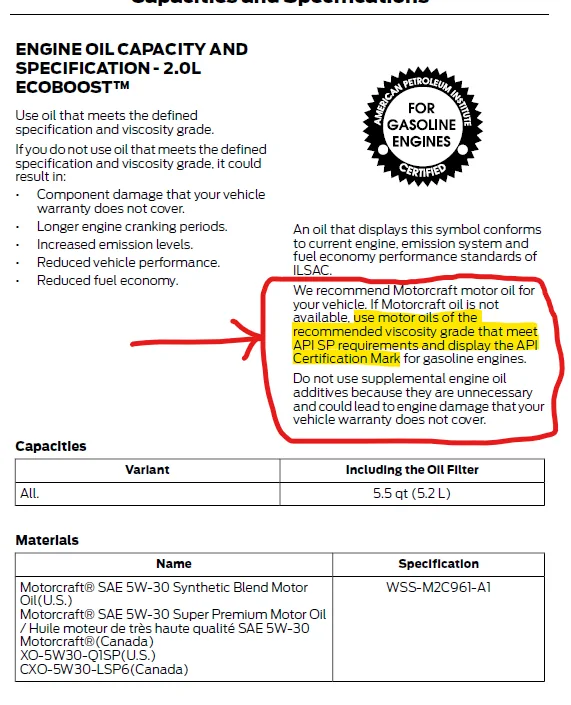

I did a search and couldn't find reference to anything saying Costco oil doesn't meet the requirement. I don't think that's true. Maybe there is still confusion that it doesn't meet the Ford spec, but that is technically not required. That is just recommended. If you have a link that explains why someone thinks Costco oil should not be used, maybe you can share it, BUT the requirement from the owner's manual is shown below, and I can confirm that the Costco oil DOES meet the API SP specification called out below. I personally haven't used it in my BS BL, but I see no reason why someone couldn't or shouldn't.
Ford Bronco Sport I wanted to share something helpful 1767907299774-az
Yes, I just checked the back label of Kirkland oil. It says For use in gasoline, flex fuel or gasoline-electric hybrid vehicles requiring SAE 5W-30 API SP, SN PLUS, SM and ILSAC GF-6A or previous standards. Approved for use in all GM gasoline engines requiring dexos™1 Gen 3 5W30 oil. My Bronco Sport is past warranty so it really doesn't matter. I just make sure I use a good oil and Kirkland/Warren oil is good.

The WSS-M2C961-A1 spec isn't shown on the Kirkland bottle. I don't know what that spec is, but I believe other brands (like Mobil 1) do list it on the bottle.

That WSS number is a Ford spec Another member explained that oil manufacturers can pay to have their product certified to the Ford spec, but as shown in the owner's manual, the oil only needs to meet the API specification SP which the Costco oil does.
