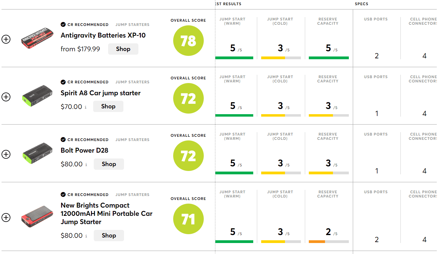

The NOCO GB40 is no longer listed (which happens a lot). Here are the top 4 currently:
Ford Bronco Sport I spoke too soon. Or I jinxed it. 1686885109081

When you wrote "CR", did you mean Consumer Reports? That's what I thought, which is why I checked out their reviews. The fact that the GB40 is not listed does not necessarily mean anything. If they tested it before, they probably just bumped it for a newer model. If they never tested it, that also typically does not mean much. That happens a lot. With so many products on the market, they can only test a sample of what's available.
C&D cannot always be as objective as CR, but it seems like they did a good job rating portable jump starters.
As they said about the GB40:
"But if you're short on space and want to have a portable jump starter around, this is the one to get."
The "but" refers to the fact that with any compact, light weight jump starter there are trade-offs. Anyone interested can check out the C&D article for more.
The bottom line with any device like this is, does it work? Does it fulfill the owners needs?
It's easy to get carried away and buy something that's way more than is necessary. For example, this unit -- big brother to the heaviest one C&D tested:
https://www.amazon.com/dp/B000JFHMVG/ref=emc_b_5_i?th=1
You know, in case you need to jump start a D8 bulldozer. :cool:
The opposite is true as well. Here's one C&D passed on:
https://www.amazon.com/dp/B087LRFYDB
