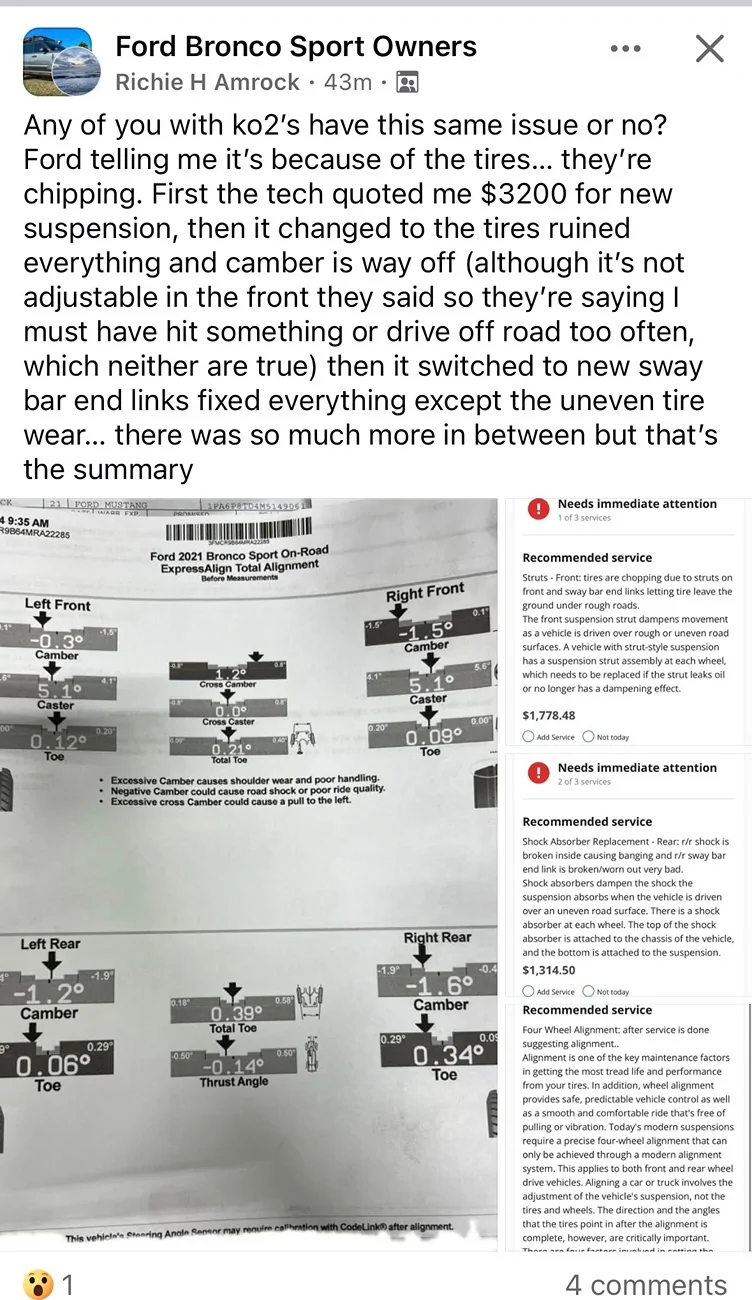

perhaps similar to this owner’s experience?
Ford Bronco Sport I have 34000 miles on my 21 BS First Edition Alignment issue IMG_9214
