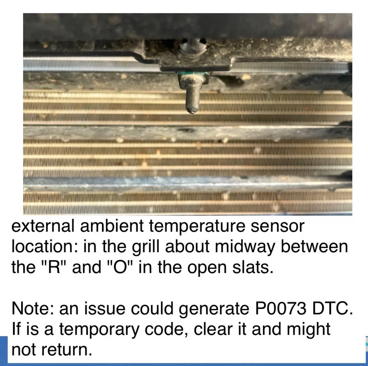

And the external (outside) ambient air temperature sensor also plays a role in the HVAC System
this could also be the cause of your issues
This is located at the front of the vehicle
Ford Bronco Sport HVAC Problems IMG_6853

Yeah, what @Dude said ^. The interior sensor is easy to get by the mirror. The external one is the one that knows when it's a 75 degree day. The buried temp sensor is to measure the A/C air and adjust the compressor system.
