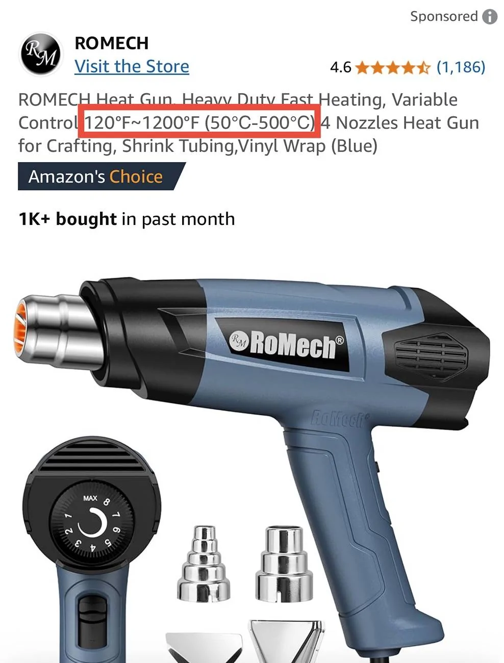

Here’s a heat gun with variable temp control but it’s not in the range you want (you want around 75 to 85°F) and a hair dryer gets pretty hot too
I am not sure how you can get into the temp range say 75 to 85°F … where I live it won’t go below 90 to around October maybe but you are in Washington I think based on your profile
Just be careful and good luck !
