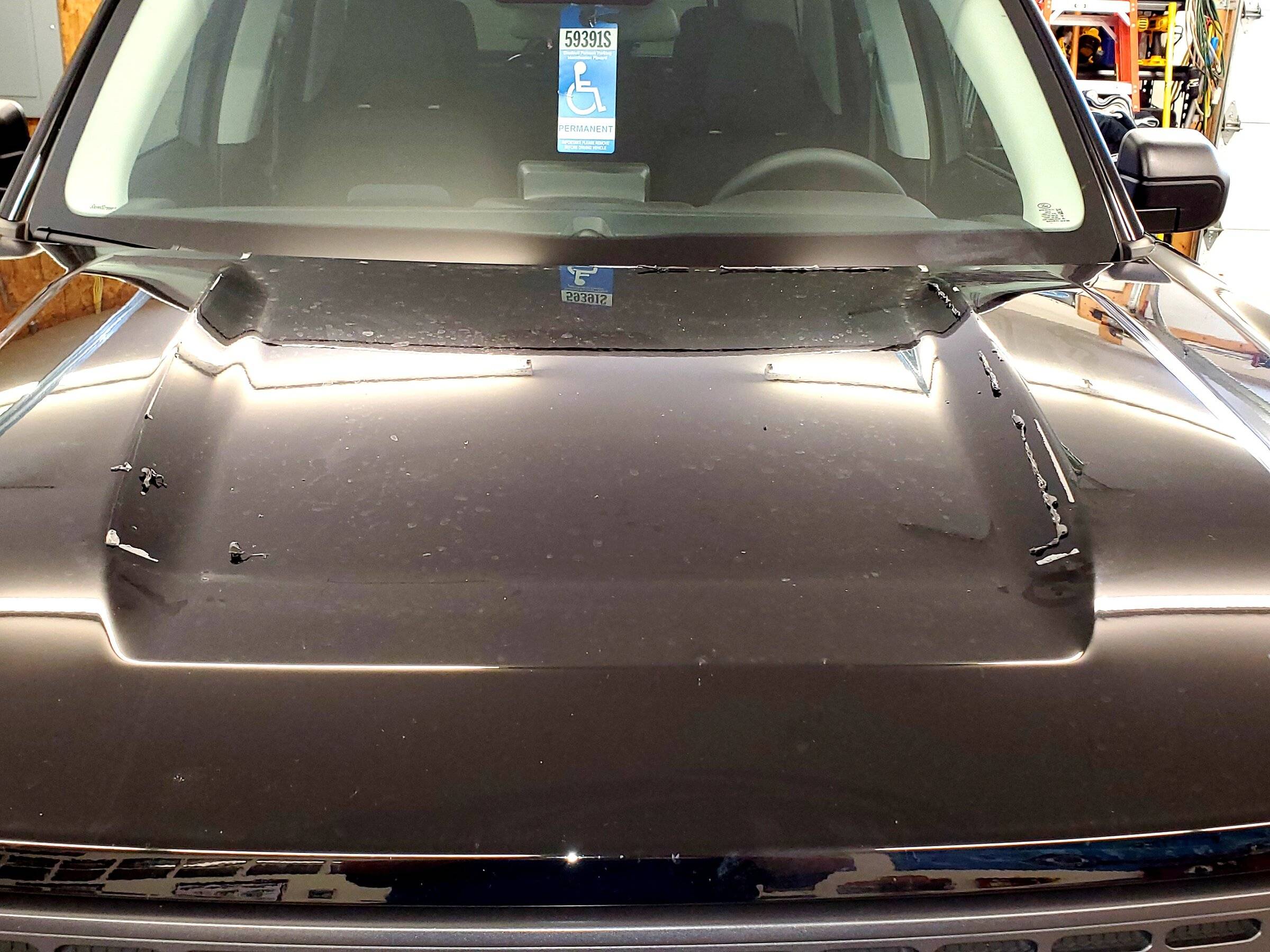

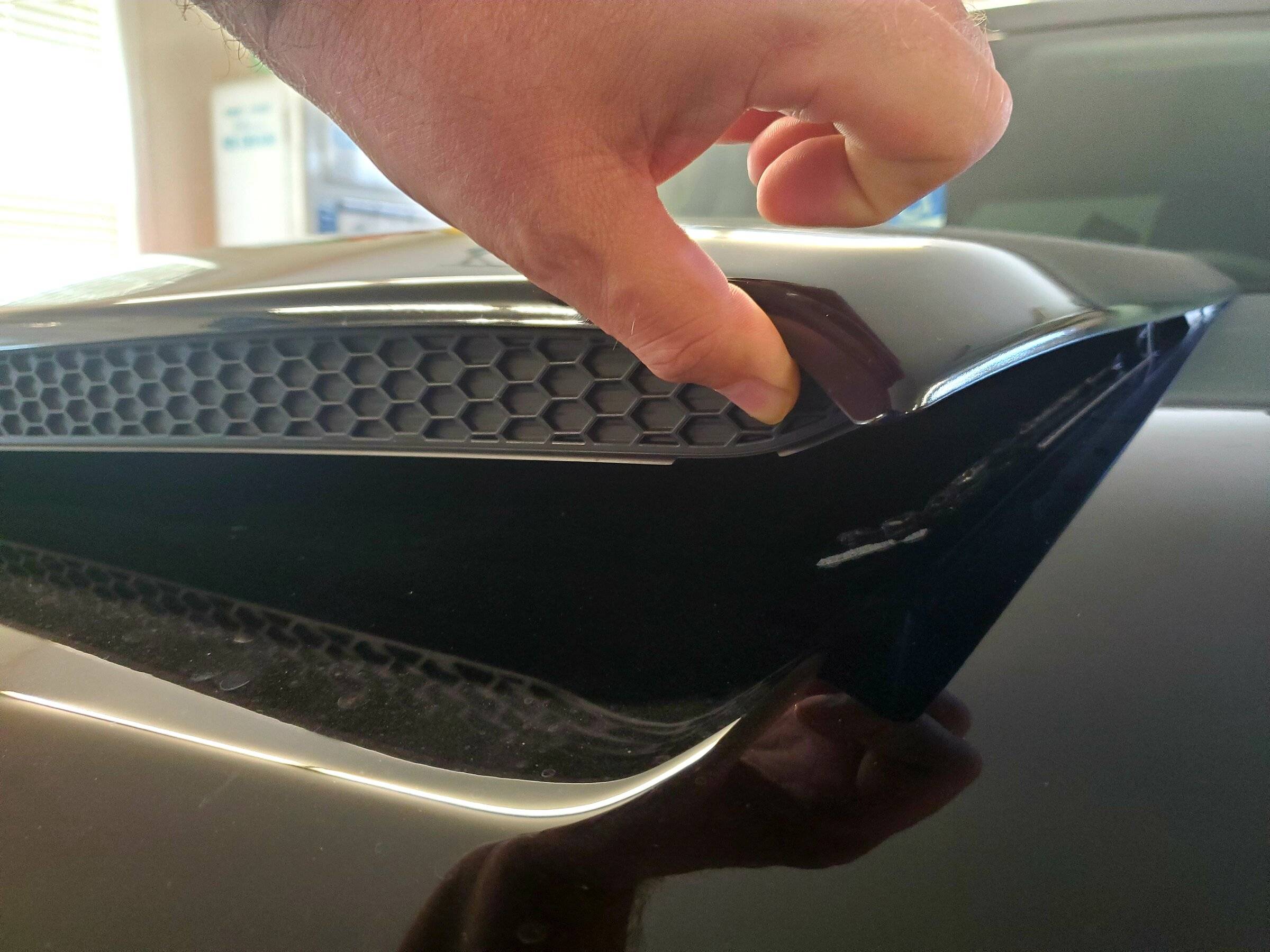

I have first hand experience with this as the first time my hood scoop was put on it wasn't put on correctly and had to be removed. We found out while going down the highway 70mph and the front started lifting away from the hood. We were able to make it home and I immediately got on the phone. I called the company that makes the hood Scoops and they helped me greatly with exactly what to do. As instructed I used fingernail polish remover and let it soak along the sides of the glue. Then carefully used a plastic putty knife to go along and help pry the scoop away from the hood. I then removed the remaining glue with the polish remover. When I was done I couldn't believe I didn't put a scratch in the black paint. I was very happy. Needless to say the second time it was installed my wife and I did it and we had not had one issue. We just followed the instructions.

Putty knife, nail polish remover, scrape. Not in most peoples vocabulary. There is no way the paint or clear coat wasn’t damaged. But it’s a bronco sport i guess. I understand

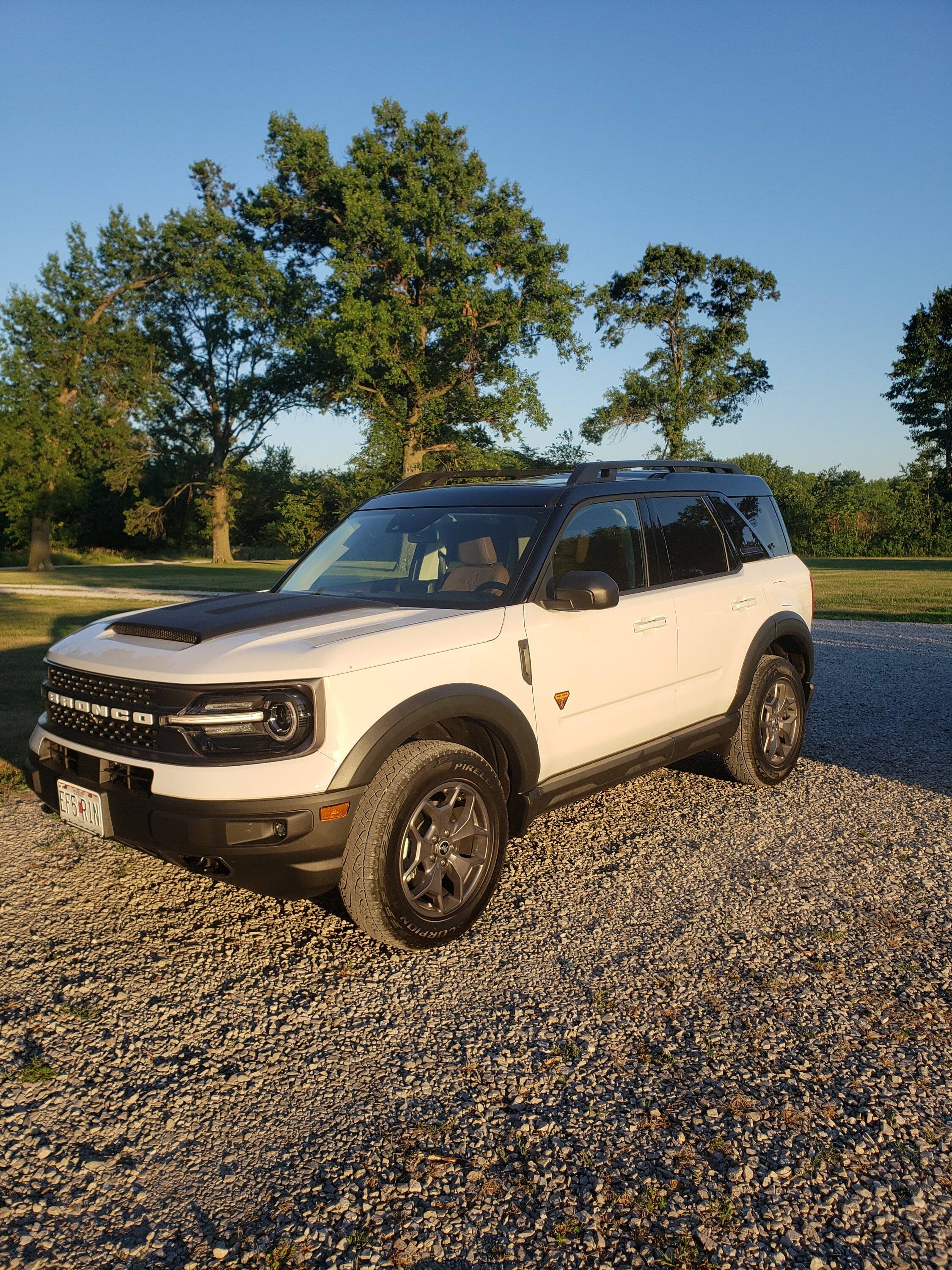

I installed the hood scoop and flares in the first week of ownership. The parts are attached using 3m double faced tape along with a urethane adhesive. I don't think it would be possible to remove them without using some type of solvent. I did notice that the hood had glare and a flutter near the rear, center. The scoop took care of both.
