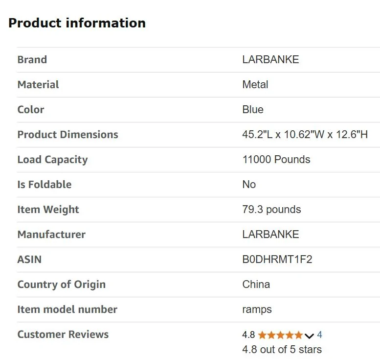

<Later> I just checked the Amazon link (above) and it appears they are made in China:

Of course, as I said, that does not necessarily mean they are poor quality. I like like the basic design. Even though I have a 2-post lift in my garage, I'd like to have something like those ramps -- but I would want to see more than 4 reviews before buying, unless they were made by an established company with a good reputation.
One thought, regardless of where they are made, is that manual bottle jacks can be tedious. Pneumatic ones are much easier to use (but more $ of course). For occasional use manual jacks are OK.
At about -23 seconds in the short video on the Amazon page, a vehicle is shown rolling onto the platform, which tips forward significantly. That's to be expected since the only support is the jack in the center, but it doesn't look good.
They may be fine. I tend to be pretty critical.

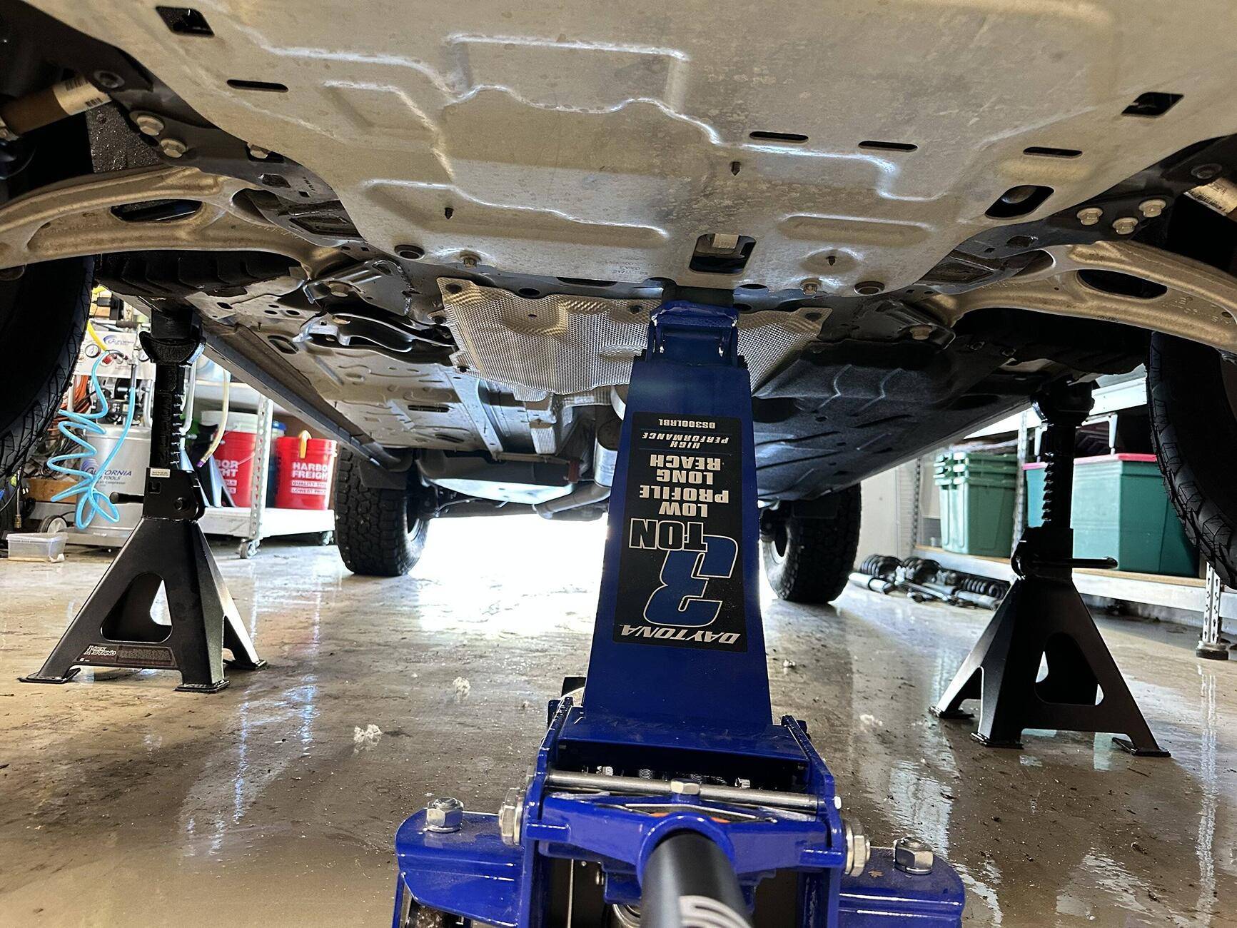

I went through the first thread you linked to. The illustration in post #2 is good -- it shows the standard lifting points -- but nothing else.
In post #163 in the 2nd thread is exactly what I was looking for! :cool:

Nice photo Meanderthal!

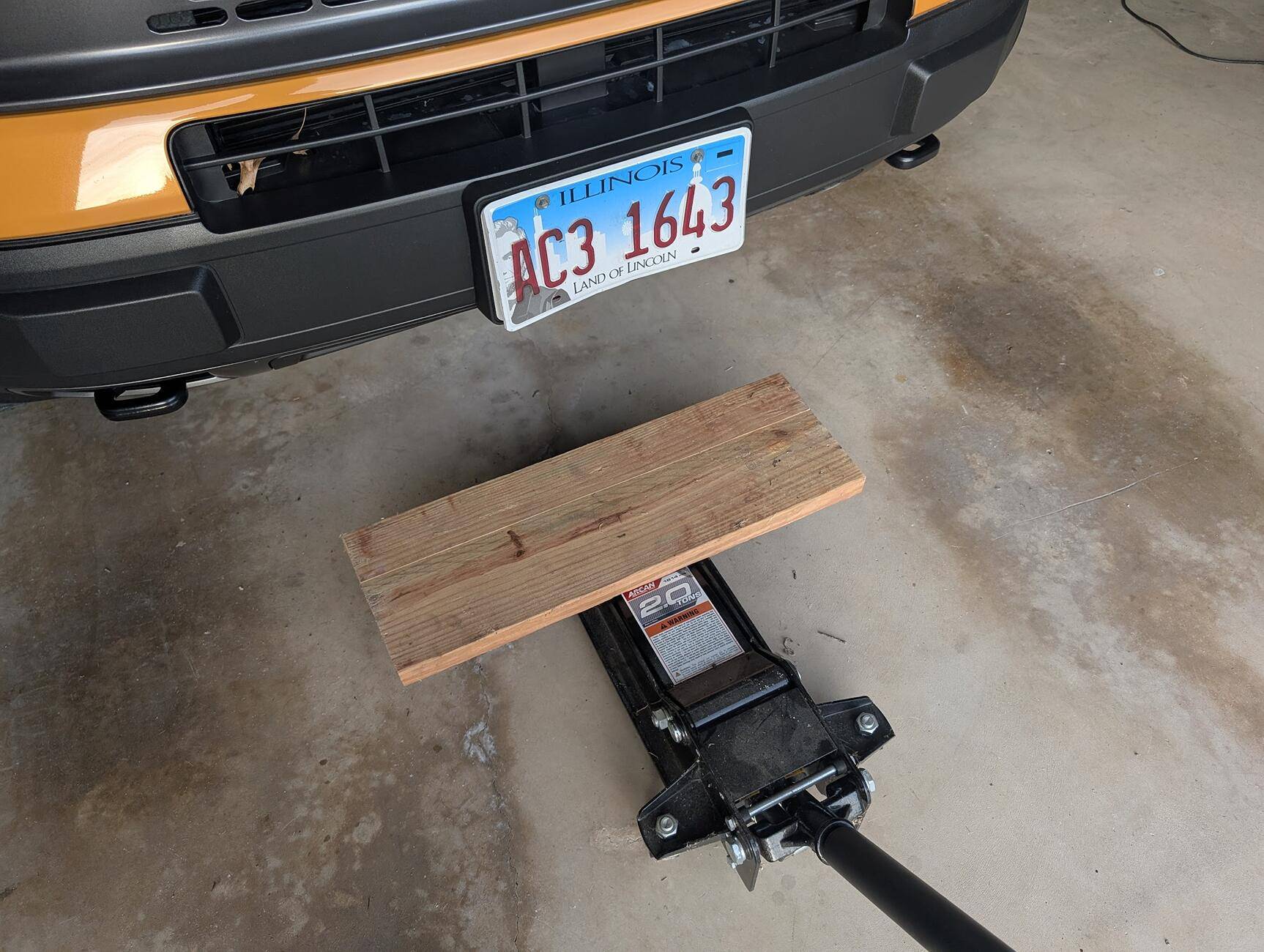

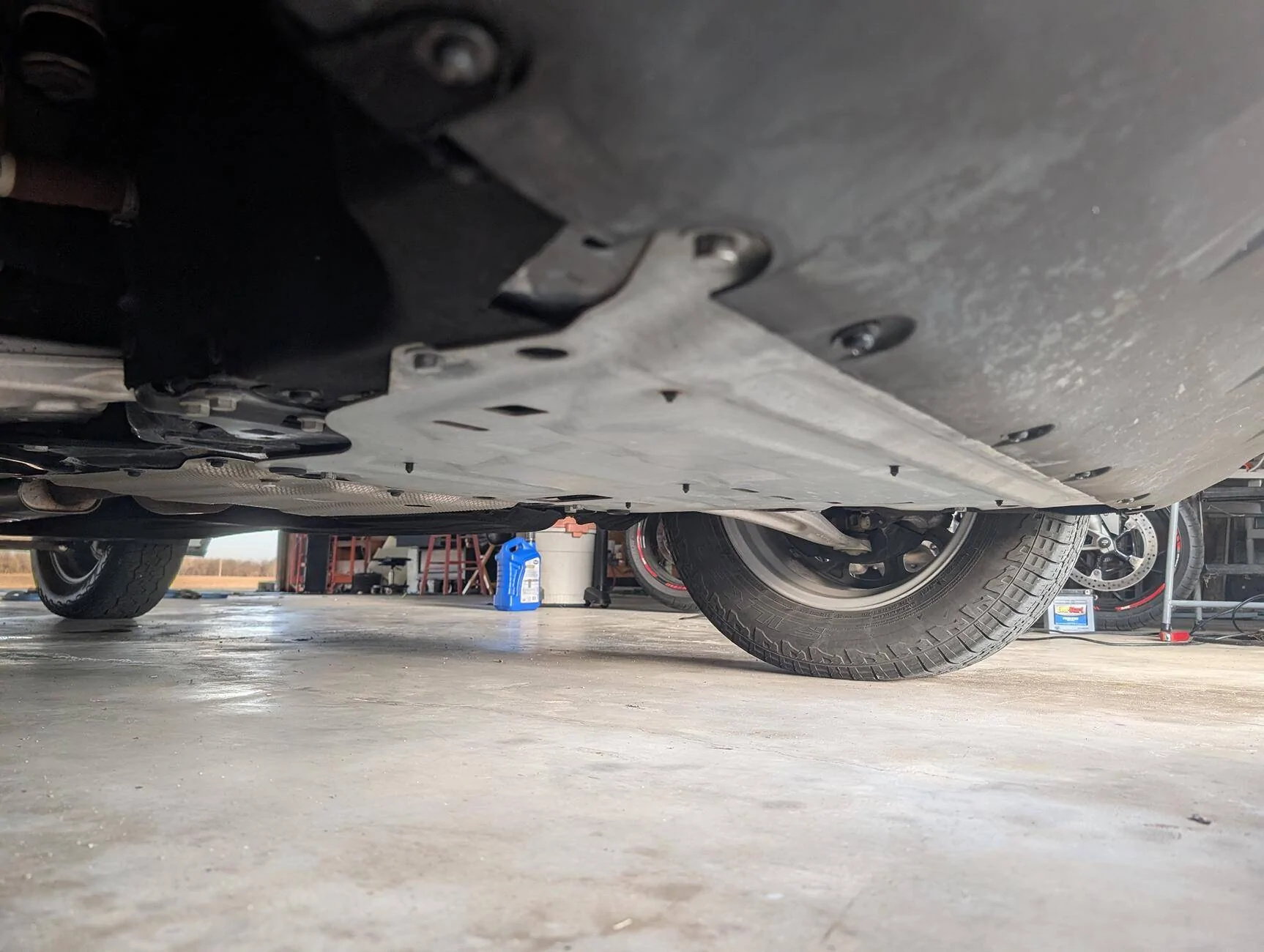

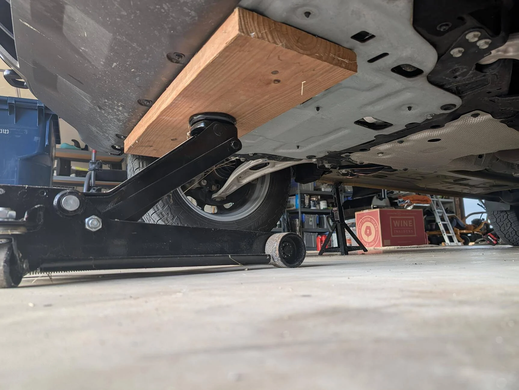

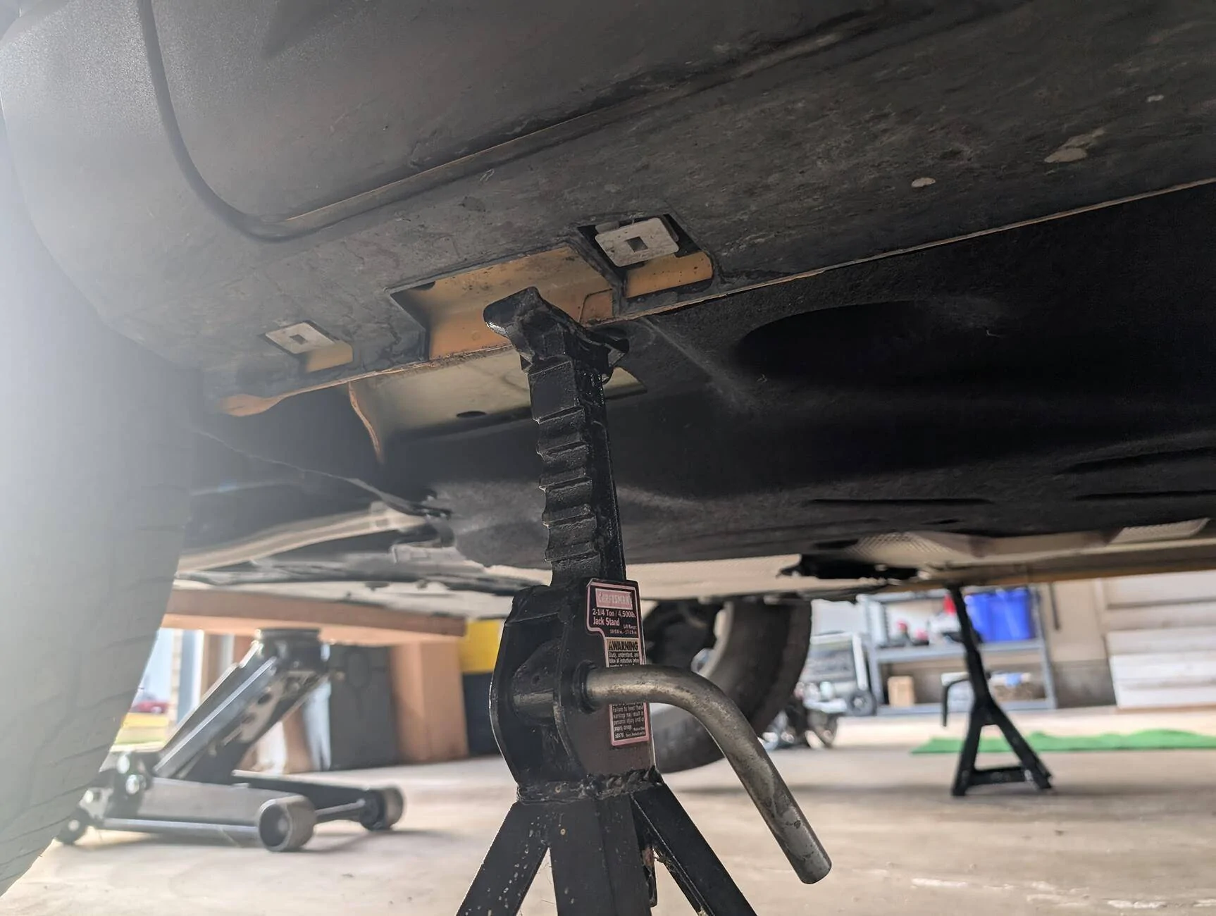

Here's how I get jack stands under my Badlands. Note that this won't work for other trims that lack the skid plate. Spreading the jacking force across the skid plate prevents damage. You can lift more than high enough with a 2X6 to get jack stands under the normal left and right jack points. A piece of 4X4 lumber would allow you to jack the vehicle even higher. The last photo shows the skid plate after the job, just to prove it causes no damage.

Mark, don't know if you feel these are necessary but may be a little more protection for the pinch welds. I use the round ones shown in the ad for my hydraulic jack when rotating tires.
I'm sure they don't hurt anything. Are they necessary? The provided scissor jack uses a metal pad, so I don't think the pinch welds at the jack points are in danger of getting damaged. Then again, metal-to-metal will almost certainly take off some paint, increasing the likelihood of corrosion. Could be a good investment. :like:
