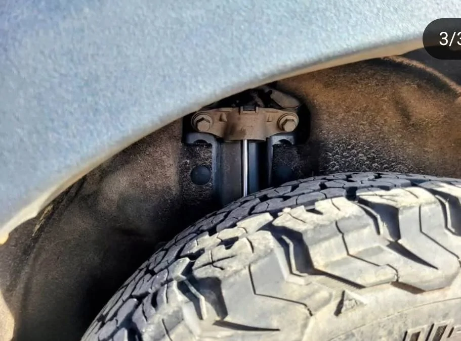

Spacer lift rides firmer since you’re preloading the spring.
This simply is not the case, the spring preload is the same with or without a spacer lift. Maybe at some extreme lift there is some preload difference, but I’m not talking about the extremes.
6,732
13,146
A spacer does exactly what its name implies: it adds space between the top/bottom of the spring and the spring mount. Changing the spring preload requires compressing or decompressing the spring. How does a spacer change the spring preload?
This
