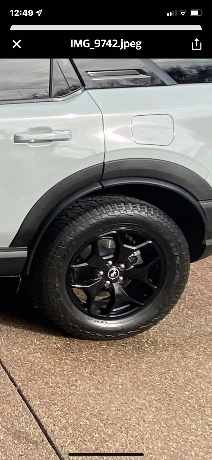

It looks to be about the same height as my first edition, can you take a measurement from ground to the bottom of your driver side mirror? Looks great .

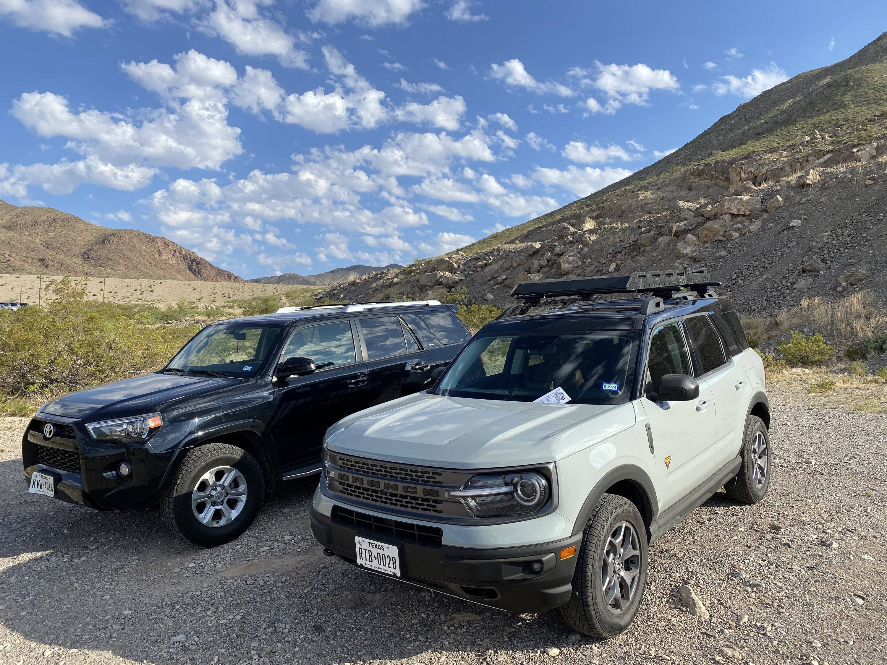

How does this compare to their 1.5" kit? I've been looking at that for my Badlands (if the train ever decides to get on the move again)?
I could be wrong... but for those of us with the Badlands those springs cited here are not a suggested/recommended fit. Just for BB, OB and Base models...
I'm Leary to modify too much with these spacer kits as it might place un-intended pressure on other components of the suspension system. I want to place 245/70/17's on my Badlands... but will settle for adding 245/65/17s when the time comes...
No grinding out pinch welds or placing unanticipated pressure on other areas of the suspensions... Just be cautious on some modifications. As Badlands owners perhaps we should accept the added lift and change in suspension we seem to have and paid for...lol.. over others... my 2 cents

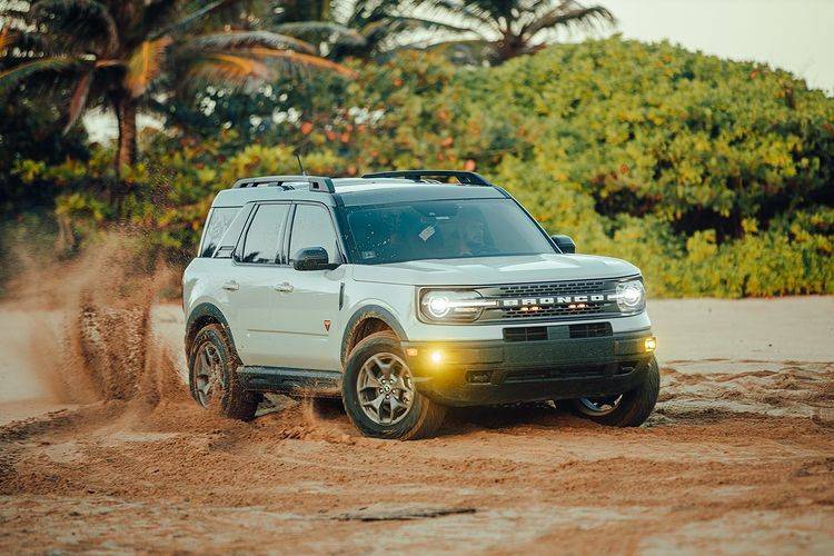

This is from a friend here in PR, pictured here is a stock BL with the Wildpeaks 245/65R17, no modding, no cutting, no nothing. as a side note this are the wheels I have on my BB since he changed his to some Fifteen52's
