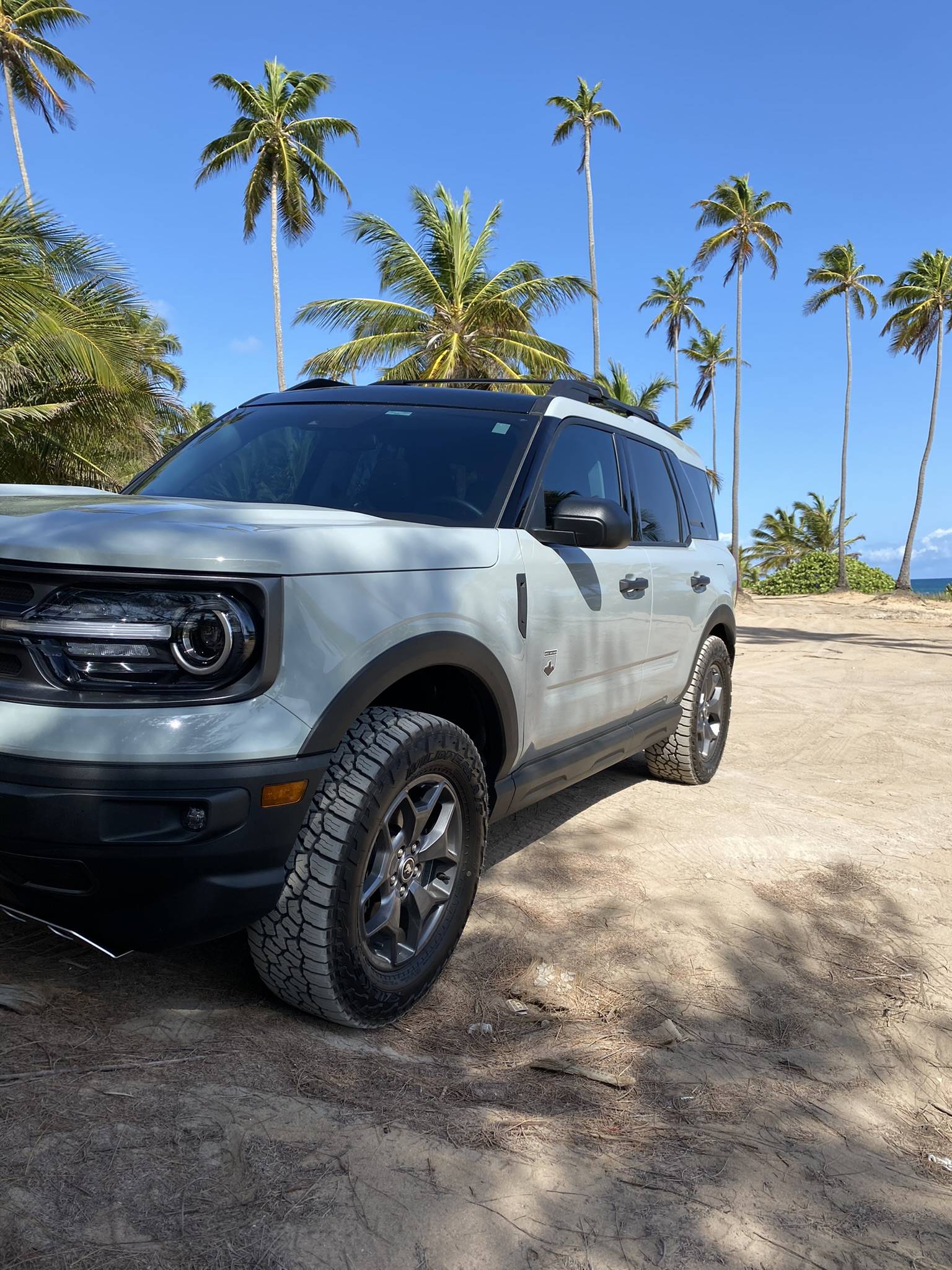

I didn't want to grind the struts and wanted to maintain as much of the ride quality as I can wich it did, here is the press release from their website that made me make the final decision
The new Ford Bronco Sport has a stylish rugged look ready for your adventure. H&R ride engineers have developed adventure-raising springs for off pavement exploring and overland excursions.
H&R Raising Springs (PN: 51680) have a mild lift of approximately +1.2” front and rear for more ground clearance and a commanding view of the road. Specific spring rates retain ride comfort and control. Blaze fun adventures with H&R Raising Springs, Wunderbar!
Like all of H&R’s products, H&R Sport Springs are 100% made in Germany and use only the finest quality materials and precision manufacturing to maximize service life. H&R springs are pre-set or “blocked” using an exclusive process that ensures the springs will never set or sag, for miles of smiles.
H&R Special Springs is a German-based suspension company that has been built on a foundation of superior quality, true performance and the best customer service. H&R has established a proven heritage of unsurpassed industry respect and customer confidence, all of which gives H&R the definitive edge in suspension tuning and design. All H&R products are crafted in Germany and exceed ISO 9001 quality assurance standards. H&R maintains a U.S. facility located in Bellingham, Washington, where additional testing and research are conducted.

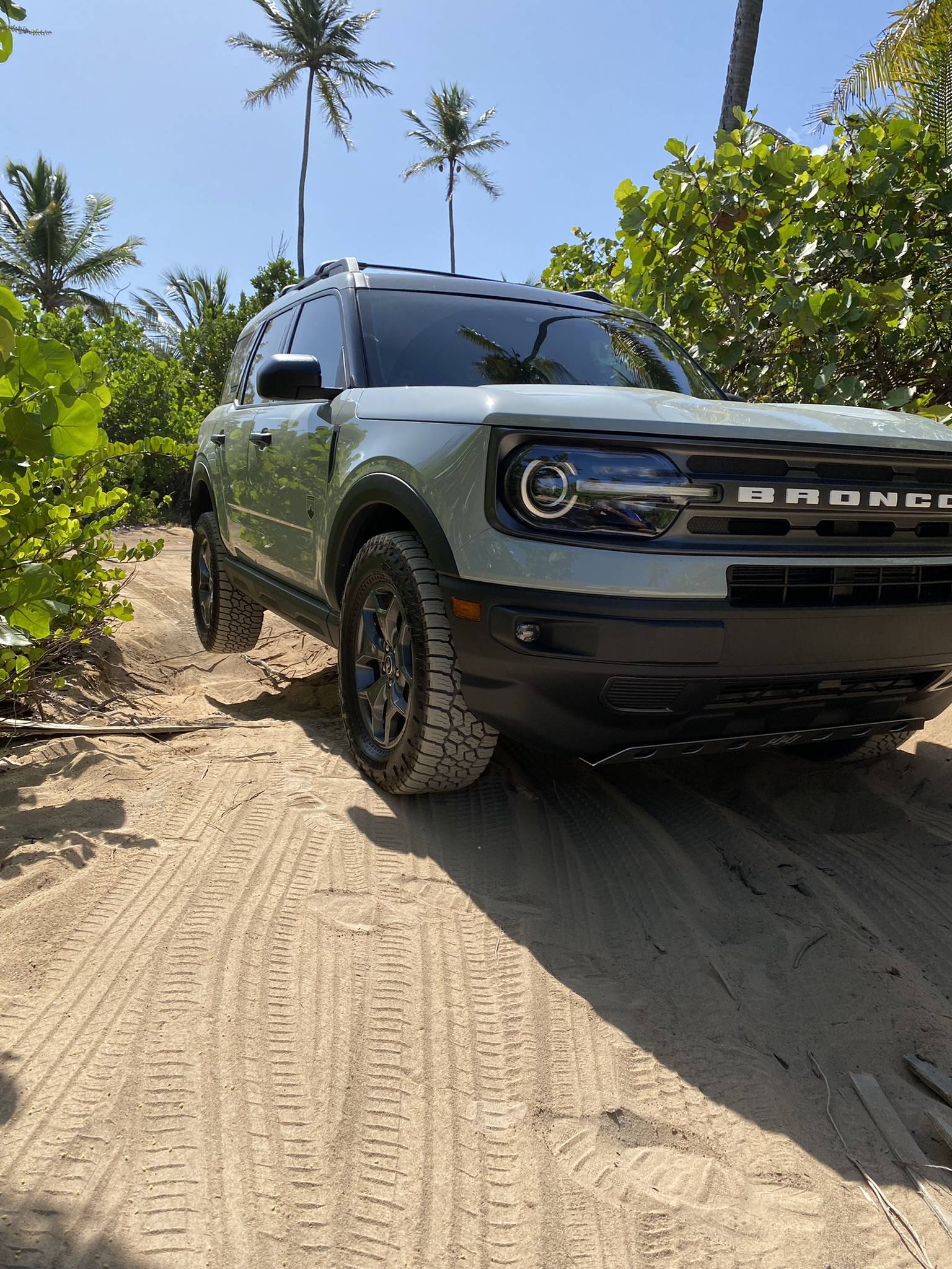

Went to the beach to flex it every possible way and the bottom of the shock never touched the cv axle.
Looks good and I love the rally innovations skid plate; just wish it was a tighter fit around the edges.
? wonder how much sand/debris gets caught there on the regular?
