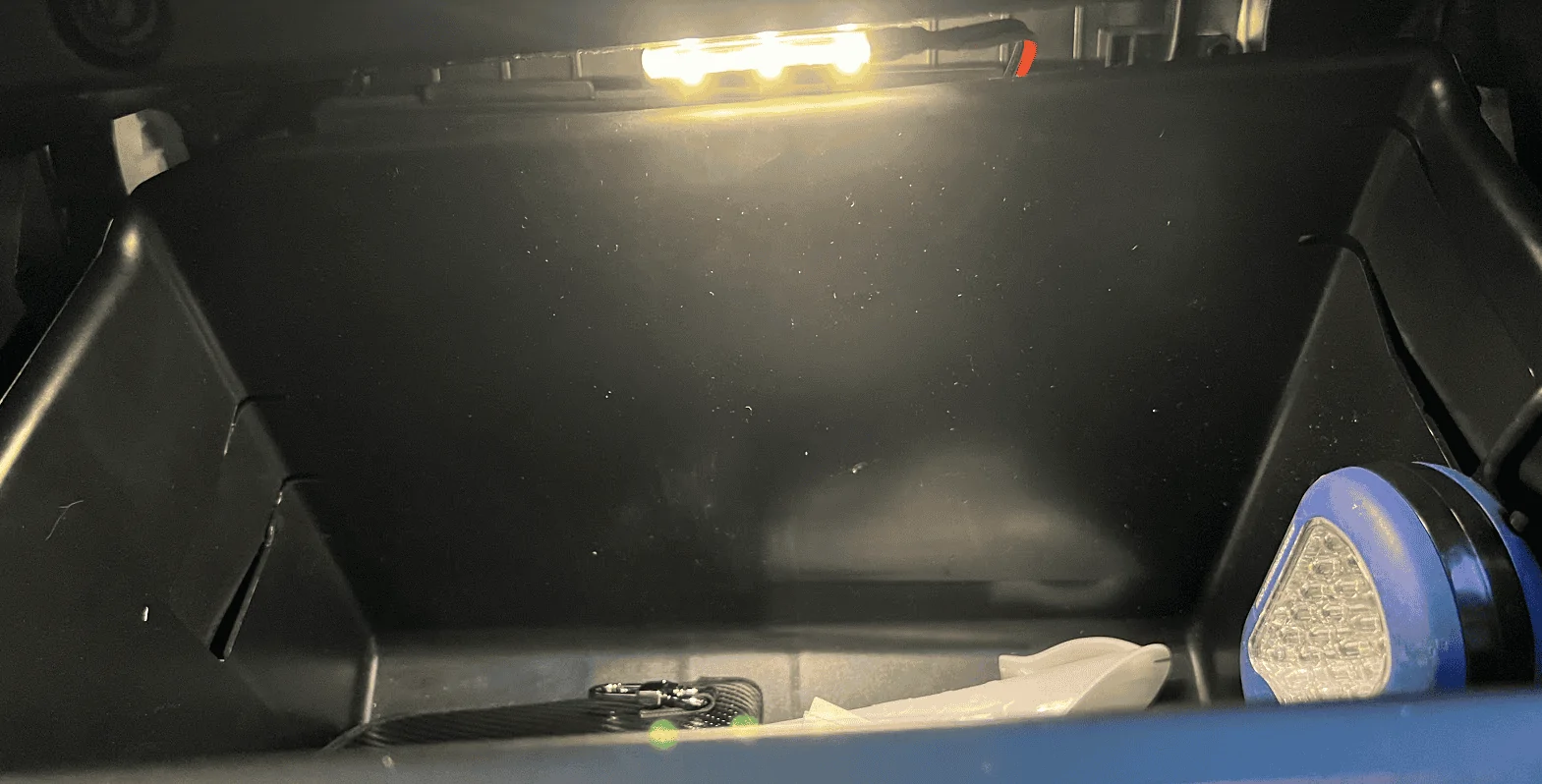

Let there be LIGHT!

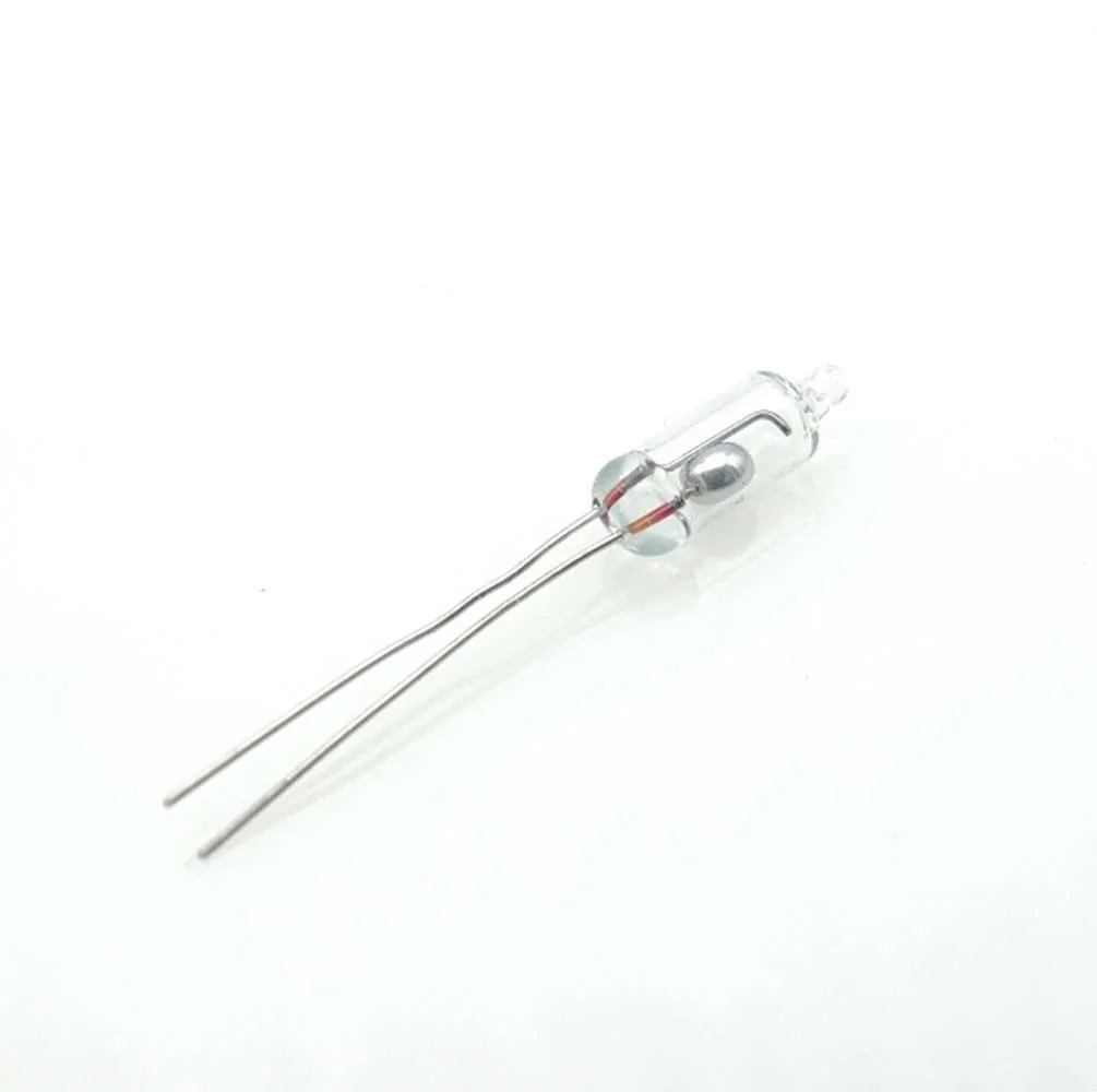

this is the tilt switch

Power comes from fuse tap and go through the tilt switch to light the little LED strip.
Unfortunately, the tilt switch is reverse of what I need so I have to bend the mounting piece about 90 degree and taped onto back of the glove box.
it works, it will turn on when I open the glove box. If I'd do it again, I'd search for other tilt switch where vertical is off (when the box closes the back of the box wall is more vertical).
oh yeah, you see my temporary backup flash light in there as well :)

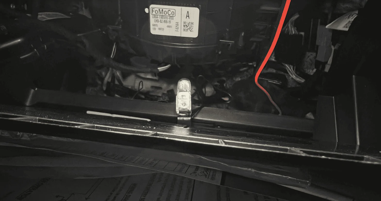

I was looking into something similar with a momentary switch. Looking at the glove compartment I don’t think we can have a switch that is too high off the surface. There is seems to be something behind the surface of the face of the compartment not sure I can mount there. I also haven’t have the time to investigate more…. I’m curious to see what u will do more diggin’ literally.
one thing tho, I’m thinking of just get a interior light kit and splice into this switch for a short strip of LED. That way I make one connection to the fuse and maybe light up a few other places like under seat. I don’t won’t very bright lights just a dim faint blue or red.

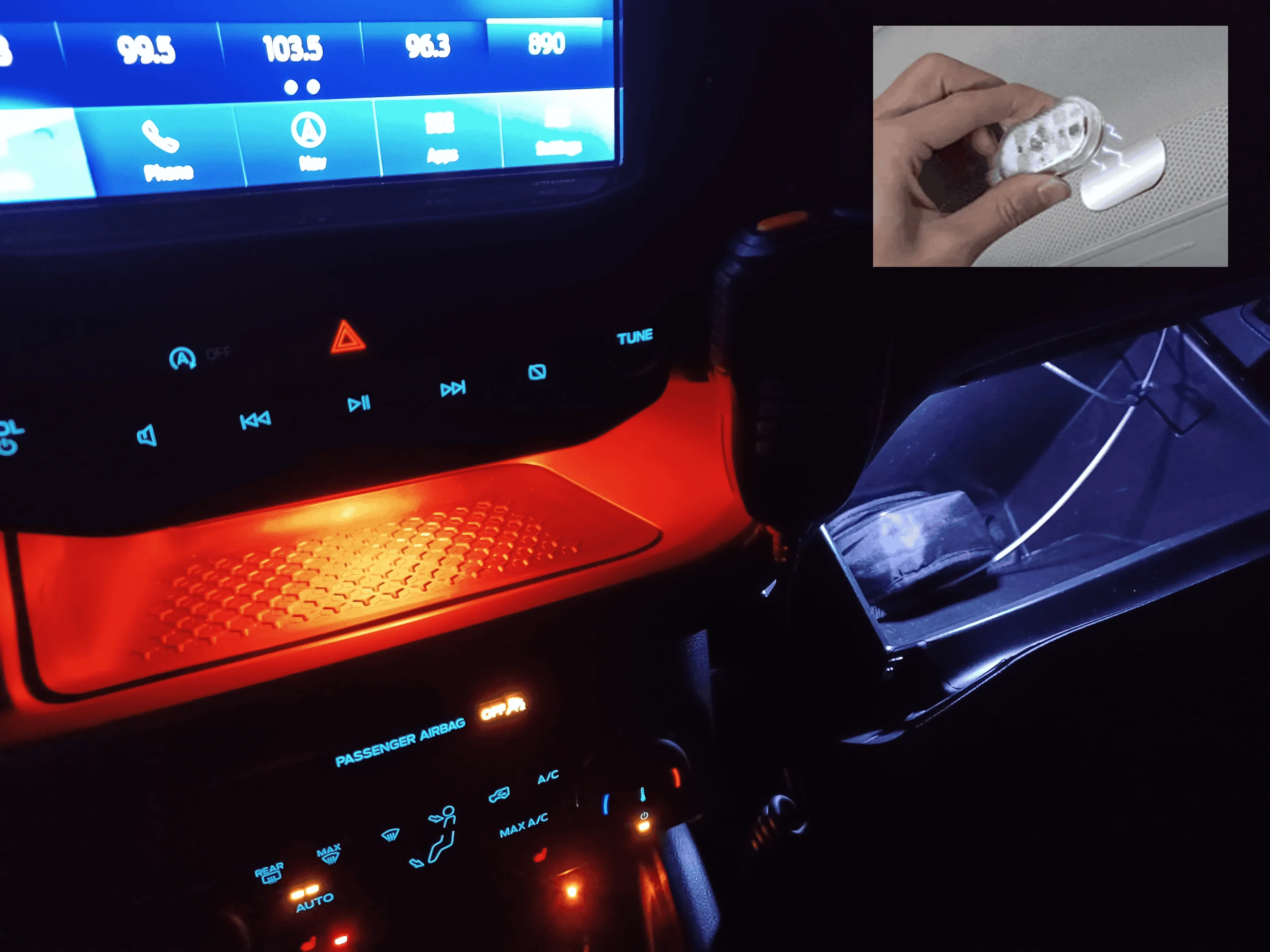

I promised to update when I installed the Glovebox Pin Switch and LED in my earlier post... Well, I got lazy and then winter came so I never did install the parts according to "My Plan" ? I guess I just wasn't in a rush to drill holes in my new BS just yet.
Instead, I ran across these little wireless rechargeable magnetic LEDs on Amazon. They have magnets and metal plates to stick 'em wherever... One slight tap in the center = ON; You can choose the color (one of seven) and turn it off (hold for 3 seconds) and it will be the same color when you turn it on again. I put them in the glovebox, center dash and console storage areas. Can't comment on how long they last... just got 'em. But, they'll only be on occasionally. Only con: They don't dim and are pretty bright. I like setting them to red in the dash wells; Looks cool and doesn't mess with night vision.
Anybody need some Pin Switches and a 12v LED? ?

not bad...just curious, how long will the battery last? I didn't see that info from Amazon. I'd prefer just tap to turn on/off. 3 seconds hold to turn off seems a little long.
I like the setup you put into that storage slot under the infotainment screen.
