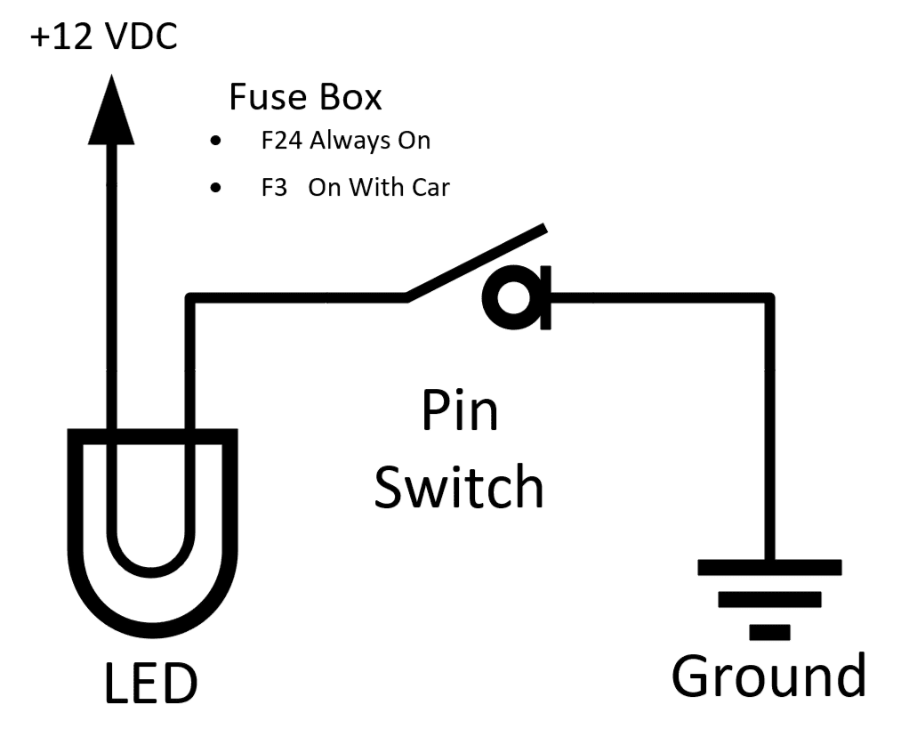

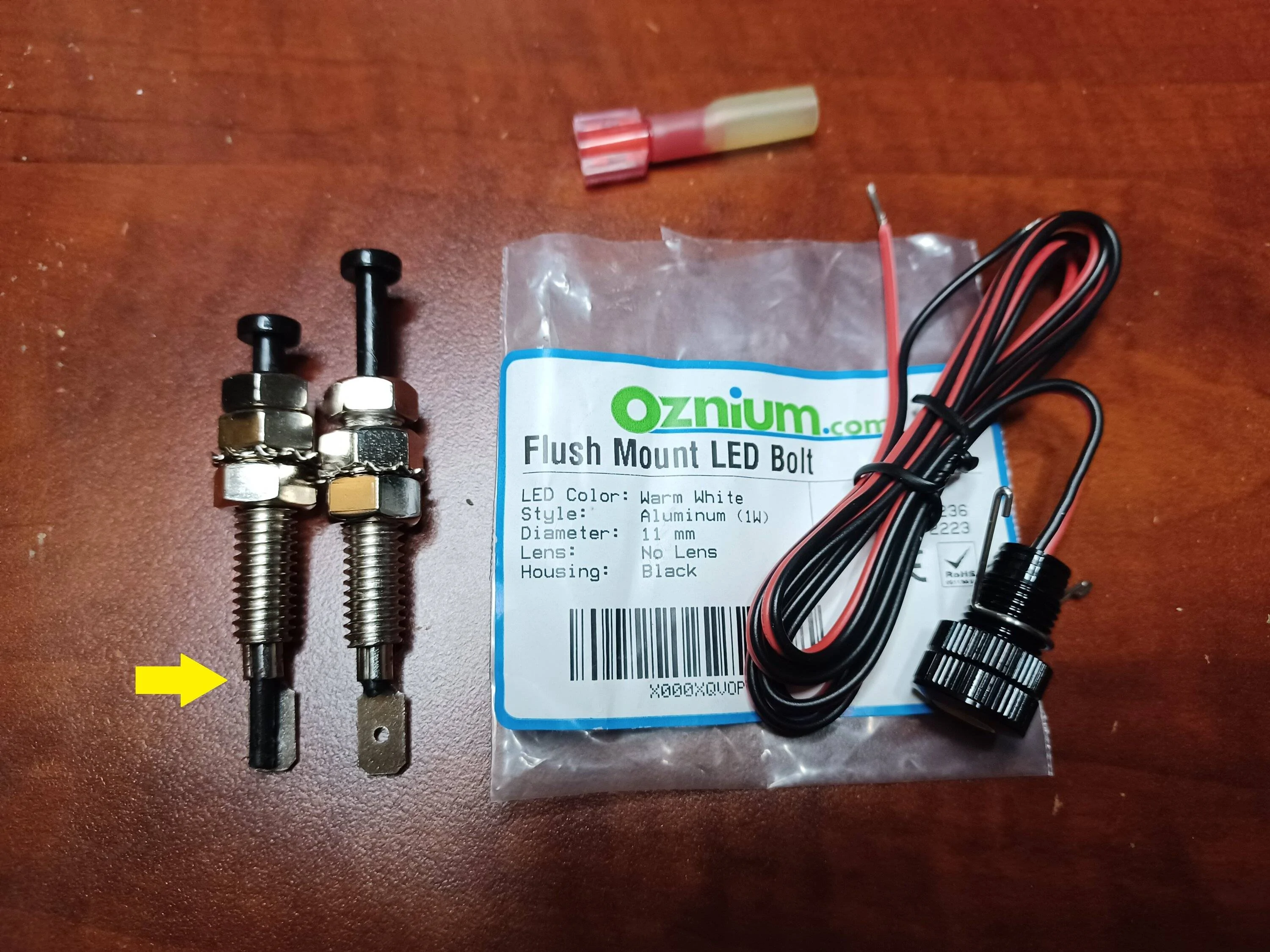

OK, here's my plan... Didn't need all the travel on the Pin Switch, so I used a jewelers screwdriver to open up the lug and reposition it (on the left); A stock one is on the right; I'll snip the excess off when I put it in, may have to adjust. Can't wait to install it, but it may have to... Going out-of-country next week :sunglasses: and lots of stuff to do... we'll see.

I was looking into something similar with a momentary switch. Looking at the glove compartment I don’t think we can have a switch that is too high off the surface. There is seems to be something behind the surface of the face of the compartment not sure I can mount there. I also haven’t have the time to investigate more…. I’m curious to see what u will do more diggin’ literally.
one thing tho, I’m thinking of just get a interior light kit and splice into this switch for a short strip of LED. That way I make one connection to the fuse and maybe light up a few other places like under seat. I don’t won’t very bright lights just a dim faint blue or red.
I took a nut that was about the same thickness as a mounted Pin Switch when compressed, and taped it to the inside lip of the glovebox... The Glovebox closed, but took a little more force for it to latch. Moving the nut around to different spots seemed to make a difference, although slight. I'll revisit positioning when I have time to drill and install. I'm pretty sure I can live with having to push a little bit harder to close the glovebox in exchange for the convenience of a light... I like to keep a lot of stuff "handy" in there and it's a pretty cavernous glovebox... Like a black hole at night :)
