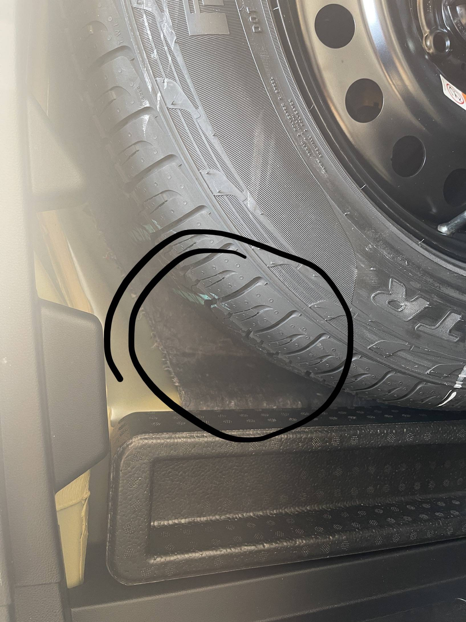

If you don’t have a factory full-size spare like with the tow package, the floor of the truck area is shallower by a couple inches. Bronco Sports with the factory full size spare have a different floor pan cover over the spare tire that accommodates a larger tire without the gaps you mention.
Correct but you still have to take the padding out as your picture indicates.

The foam. This is my wife’s BS that doesn’t have a 245 in it.
Ford Bronco Sport Full size spare IMG_1016
Mine didn't have that so I’m not sure if it’s only on certain trim levels. Either way, it looks like a thinner version of carpet padding, at most it looks to be 3/16ā€ thick. I’d be surprised if it made much difference.
I own 2 2022 Badlands and both had it. It makes a difference. Without removing it the 245 won’t go the whole way down and the cover will not sit flush. You have to remove it for the tire to drop down so the cover is flush.
Well then you’re right, it needs to be removed. My ā€˜21 big bend didn’t have it so it was a non-issue for me. It’s odd to see the variance between trims and/or build years. It must have something to do with sound deadening.

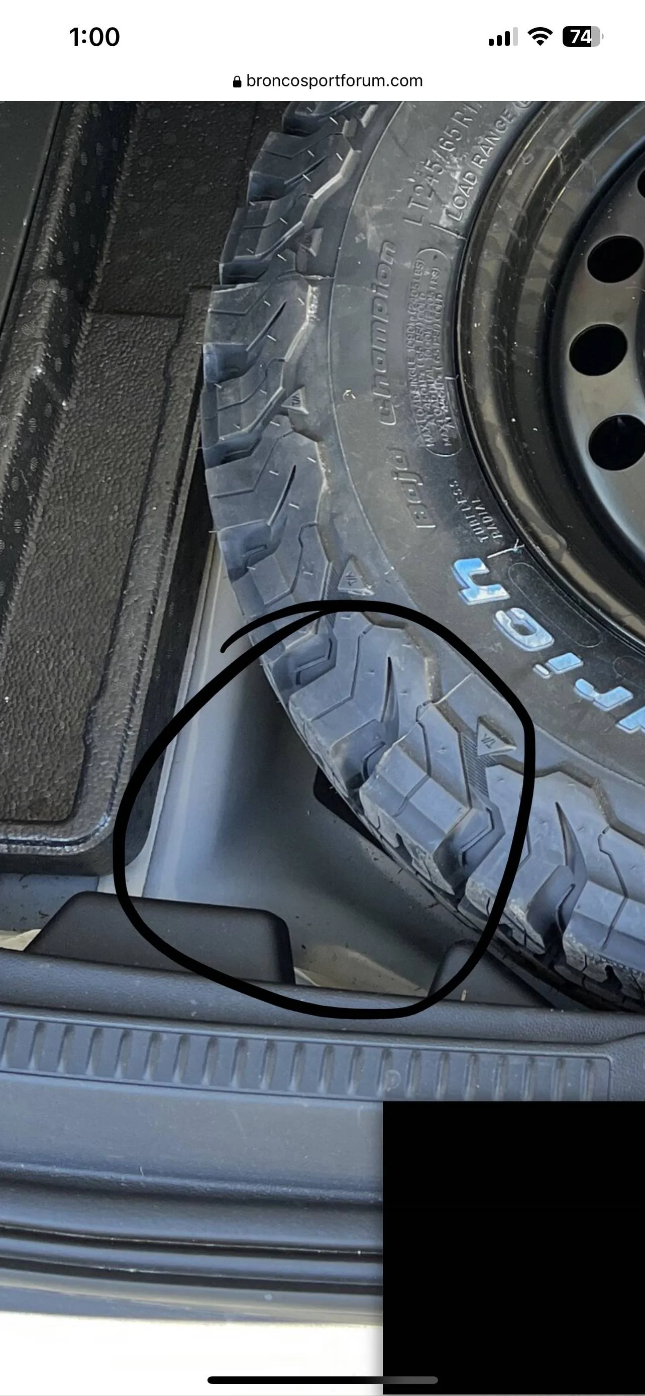

245’s will fit. Search the threads and you’ll find a ton of posts on this and pics
There is also a different spare cover correct? It sits higher to accommodate the larger tire? I think it even ā€œloses storageā€ I think badlands is listed at 3 cu. ft. Less cargo room because the taller spare cover. Hope someone can confirm that
I don’t think it’s different. There are 2 slots that it slides in to. A lower and upper. The full size spare just forces the cover to slide into the holes slot
