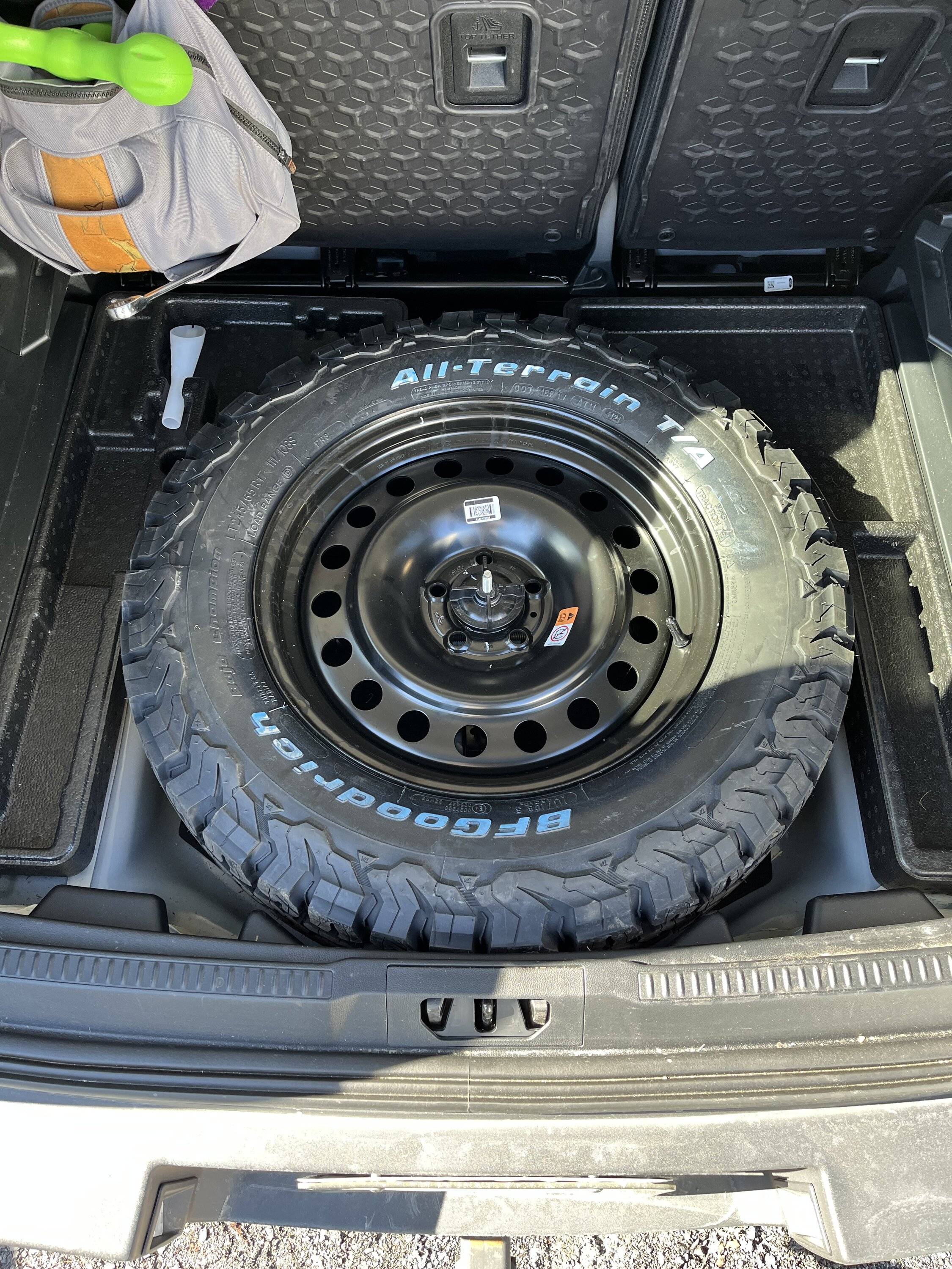

How big of a tire will fit in the spare location??
245/65/17 will fit with a shove. Just know, if you don't have a factory full size spare, the floor "lid" that covers the spare compartment is shallower (since it only has to fit the donut). There will be a gap and it won't sit flush.
