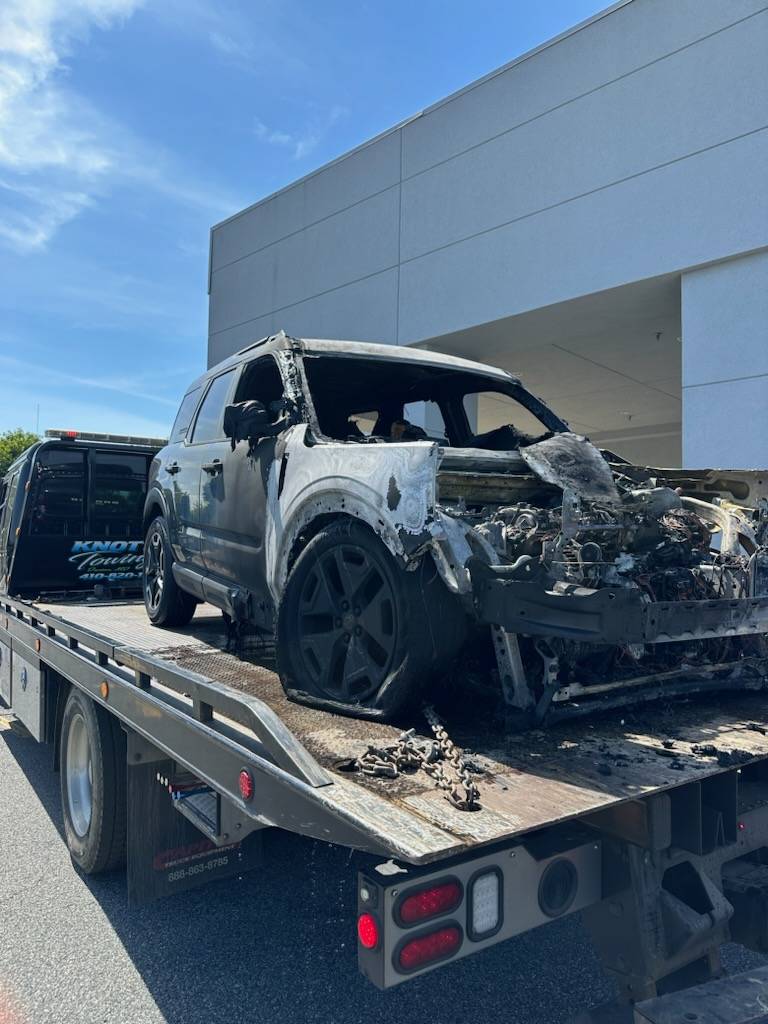

My partner bought her 2022 BS OBX on 1/6/23. She passed away in April. I sold her car back to the dealer where she bought it on 5/15/23. Being an estate sale there's some extra paperwork involved. I called the used car manager a few days ago to ask about it. Once he explained the paperwork he told me that the car burnt up. Apparently it was test driven and afterward the couple and salesman were looking it over, heard a pop under the hood and the flames started. By the time the fire company got there it was totaled. Ford is supposed to be sending engineers to look at it.
That car was in my attached garage most days that she owned it. It surely had the potential to burn the house down!

I reached out to the dealer I sold it to. He said they don't have an update from Ford yet, but he did send this pic.
