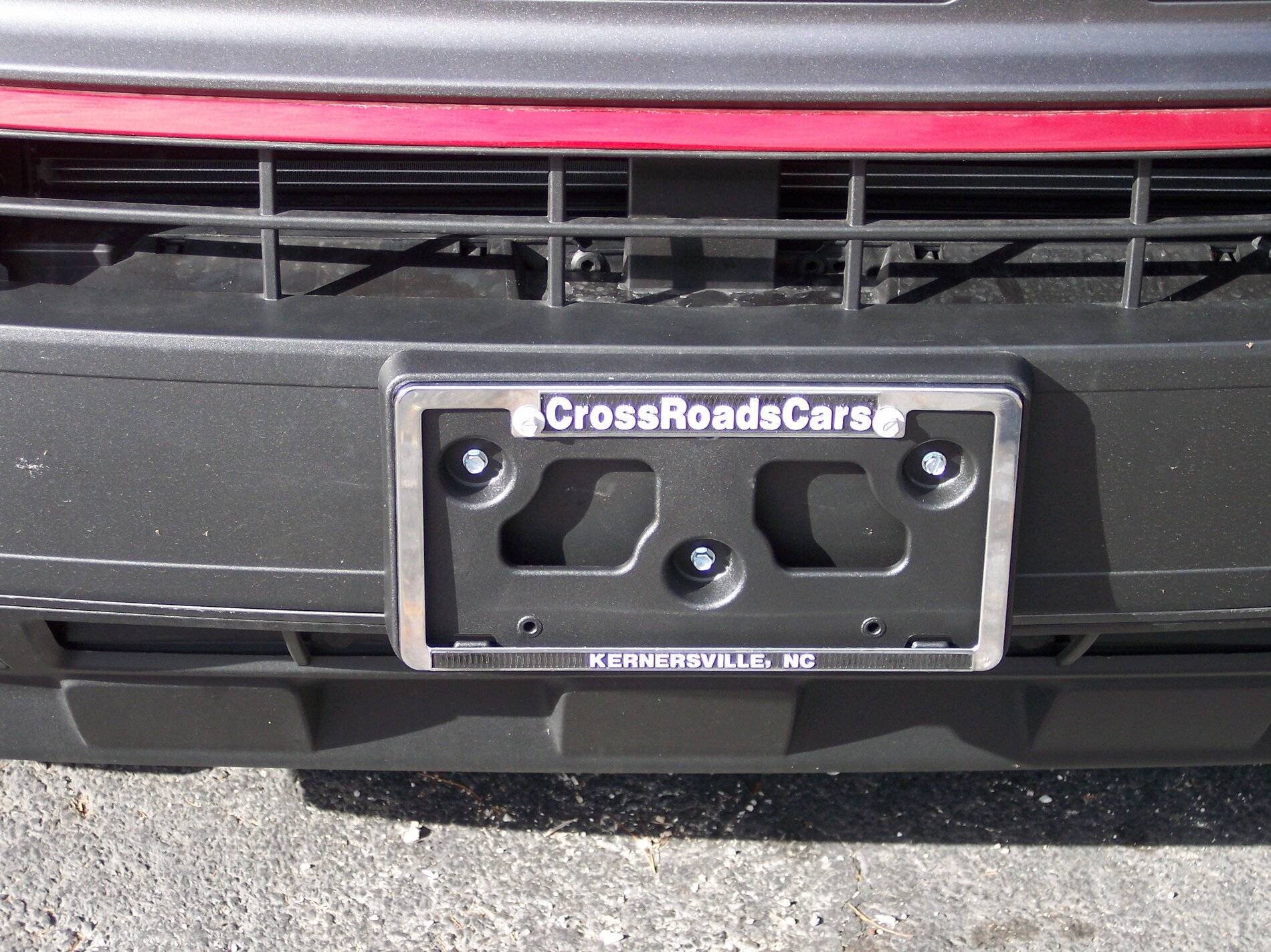

Does mounting the plate holder require drilling the bumper?

They are supposed to be pop riveted to the front bumper. I just installed ours since we purchased it in NC that doesn't require a front plate & we live in Virginia that requires a front plate. I used screws to mount our plate bracket. If you look closely at the front bumper there are 2 little dimples where the 2 upper screws/pop rivets attach. I drilled 2 very small holes at the dimples, held the license plate bracket to the bumper & installed the screws. Then once the 2 upper ones were tight I drilled a 3rd hole (middle lower) & installed the 3rd screw. Now all we need are our plates.

WHOA! You know it's illegal in all 50 states to drill that 3rd hole don't you!?

When drilling the bumper did you hit metal? Or is it just through the plastic and into foam?

Just plastic.

Yeah, there is no foam behind it. Just a plastic 'accordion' -looking piece, then the actual metal bumper.
