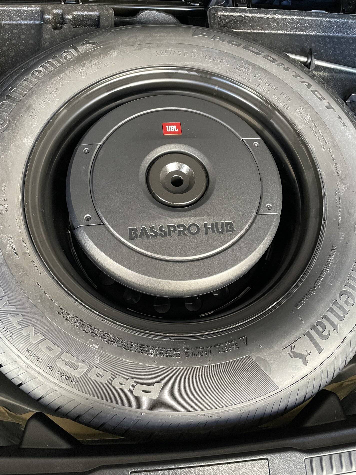

I’m installing a JBL BassPro Hub into my BS BB. It fits perfectly in my full-size spare, but the mounting post JBL included is too thin.
I need to get a threaded rod and cut it down to secure the subwoofer.

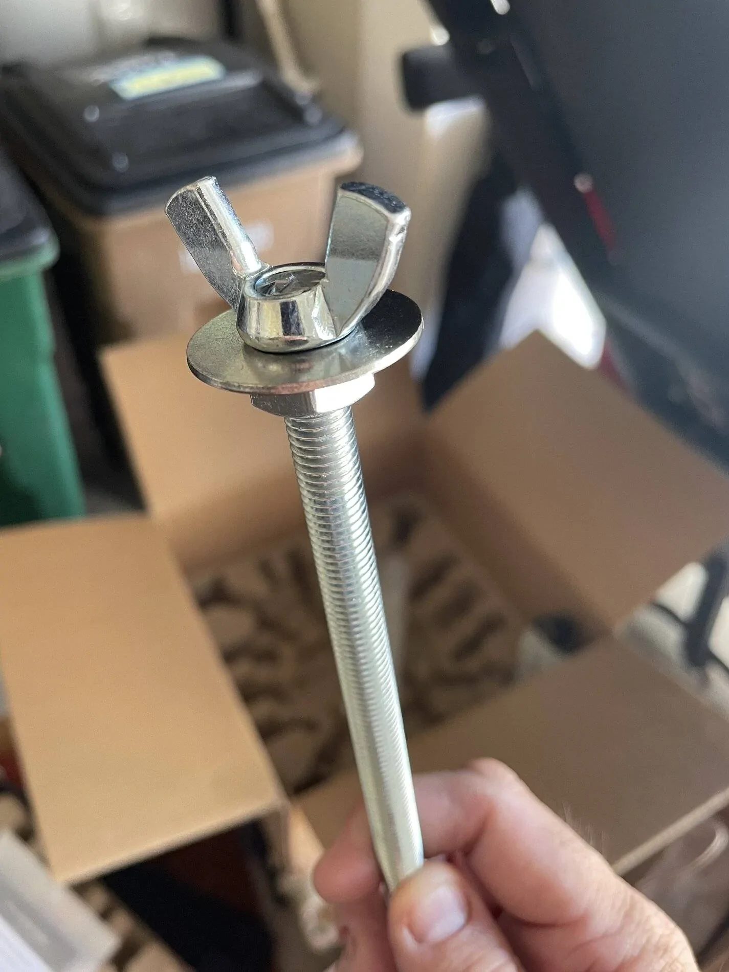

Got it figured out. Had to order an M10 rod from Grainger and cut it down. Picked up the rest of the hardware from Home Depot.

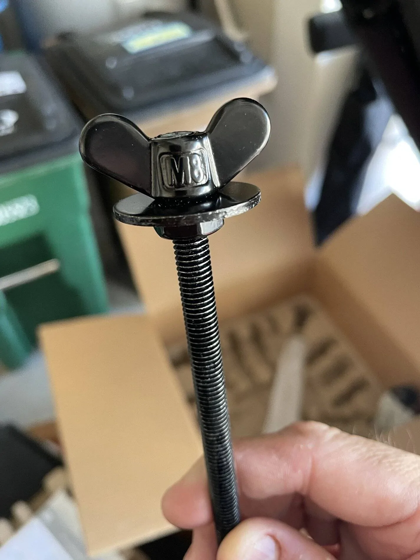

The M8 mounting post from JBL:
Ford Bronco Sport Ford Bronco Sport Metric or SAE? 704ADF39-5658-430E-A695-F14ABFD97906
My pain in the ass M10 mounting post:
Ford Bronco Sport Ford Bronco Sport Metric or SAE? F4B259A8-FECE-4AC9-B92D-BF78BDB7D254
