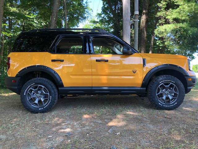

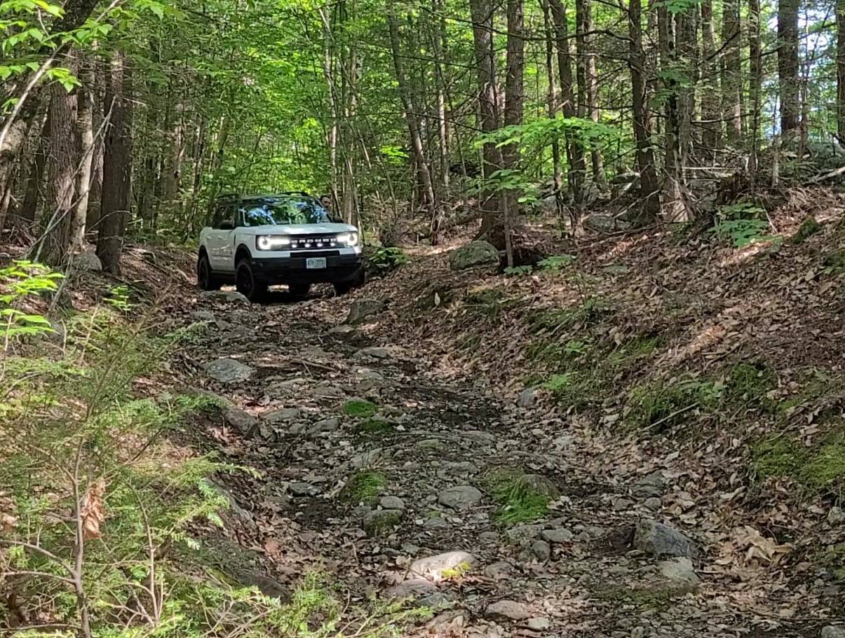

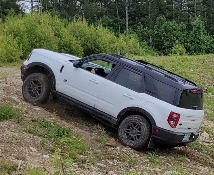

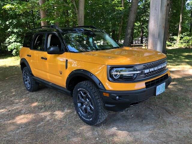

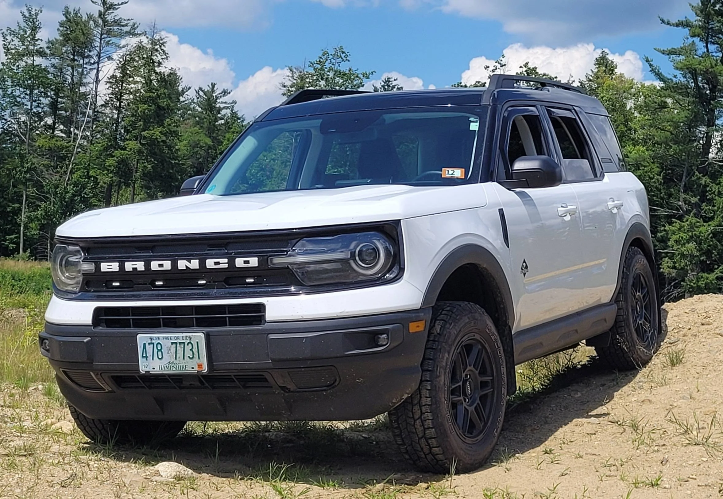

I just had HRG Lift Kit installed this week. No suspension issues yet, but it's still early. My MPG is down a few MPGs, but I think that's more related to the larger more aggressive tires and not the lift itself. I don't notice a significant difference in the ride. Again, the tires are impacting the ride more than the lift. So far, I am very happy with the HRG Lift Kit and would recommend it. It looks great too. I have included a few pics. I went with the BF Goodrich All Terrain T/A KO2s 245/65 R17.

Thanks for the info & pics. Are those the Bushwacker fender flares? Looking to possibly get some for my BL

Looks great! Did you happen to measure ride height before & after?
I suspect your hit on mileage is a combination of the tires and the change in height. The higher you stick something up into the wind the more drag you get. Drag is by far the biggest factor affecting fuel mileage for most vehicles. I would think it would be even more of a factor for a vehicle with a high drag coefficient. It's almost a certainty that an aerodynamicist would determine a Bronco Sport to be a "blunt" or "bluff" body as opposed to a "streamlined" body, which is literally defined as "brick" shaped.
Thanks Mark. The clearance measured about 9" before and about 12" after (combination of lift and bigger tires). I love my "brick shaped" vehicle! Took it off-road this past weekend and it performed amazingly well. The extra clearance (and new tires) seemed to make a significant difference.
