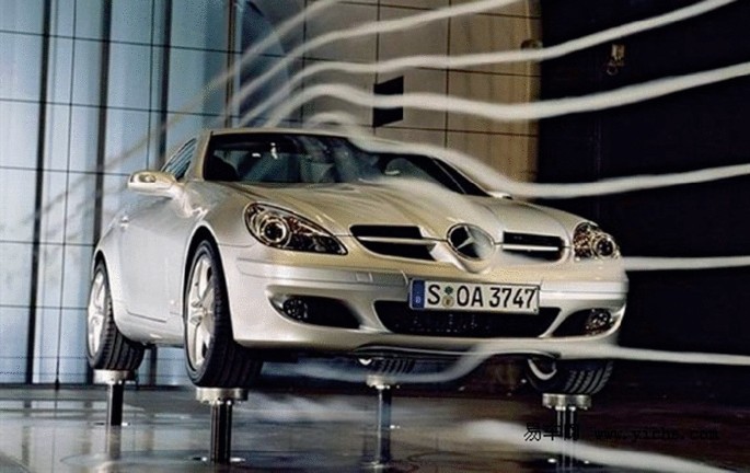

But that's not true. Turbulent air IS flowing air. Turbulence just means the pressure, velocity, and direction are rapidly changing. On a very small scale, you'll have pockets of air that may reverse direction as they tumble through the overall turbulent volume, but that overall turbulent volume continues to flow in one general direction. That's even illustrated in the video you linked at the 1:13 mark, where an image of a Mercedes SLS in a wind tunnel shows a smoke trail passing right under the car. Granted it's much closer to the ground, so here's a GLC and another SLS but on stilts. I don't know why, but Google seems to like Mercs in wind tunnels.
