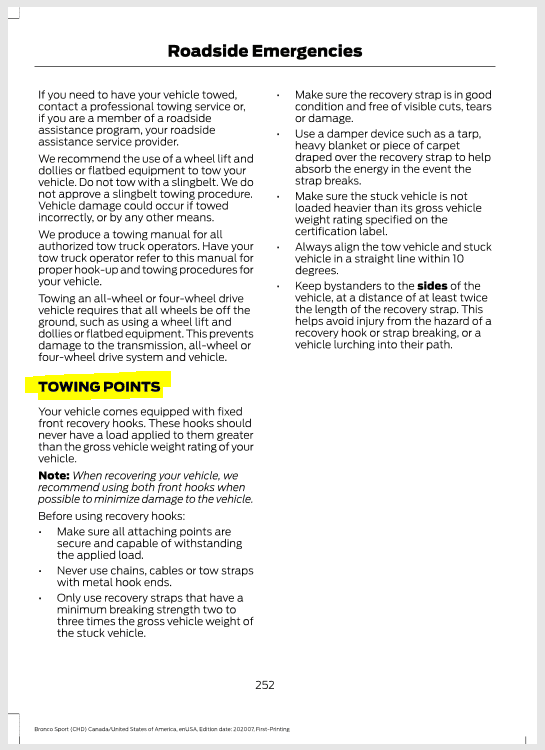

I just looked at that page in the manual, and noticed that if you go back a page there are two sections, one for the 1.5L ECOBOOST and one for the 2.0L ECOBOOST. If you have a Badlands with the 2.0L engine, it says that you will be using the front recovery hooks. The way I read it, the towing eye is only applicable with the 1.5L engine.
As I recall, the towing eye is applicable on any vehicle without the factory installed hitch.

That's what I wasn't sure of. I didn't see anything in the roadside emergency section (p264-p265) referencing the factory installed hitch, just the 1.5L ECOBOOST and 2.0L ECOBOOST. Perhaps I'm looking at an older revision of the manual.

It is vague.
Notice on p.264 it says:
"Carefully remove the front or rear towing eye attachment point cover."
Presumably that means there is at least one front and one rear attachment point.
That stands to reason since a vehicle might be recovered from the front or rear.
The recovery hooks on the front of the Badlands are suitable for a front recovery -- although Ford sure covers their butt on p.265 -- but the rear requires the tow eye or, if the factory hitch is installed, a shackle hitch receiver.
Bottom line, a towing eye is required for all BS trims except the Badlands with the tow package.
In addition, a shackle hitch receiver is required for rear recovery for all BS trims with the towing package.

And those with the hitch -- for front recoveries.
The only BS that does not need (cannot use) a towing eye is the Badlands with the factory hitch (like ours).

I have a Badlands with Towing. The frame underneath the bumper is different and doesn't even have a thread for the eye. But Ford in its strange, infinite wisdom did include the plastic cover to snap out where it would be. Even though the tow version of the bumper cover is a completely different mold from the non-tow version.
Edit: I also seem to have an older manual that doesn't even make mention of a "towing eye". My page 264 is all about fuses. This is the entire section for recovery hooks:
