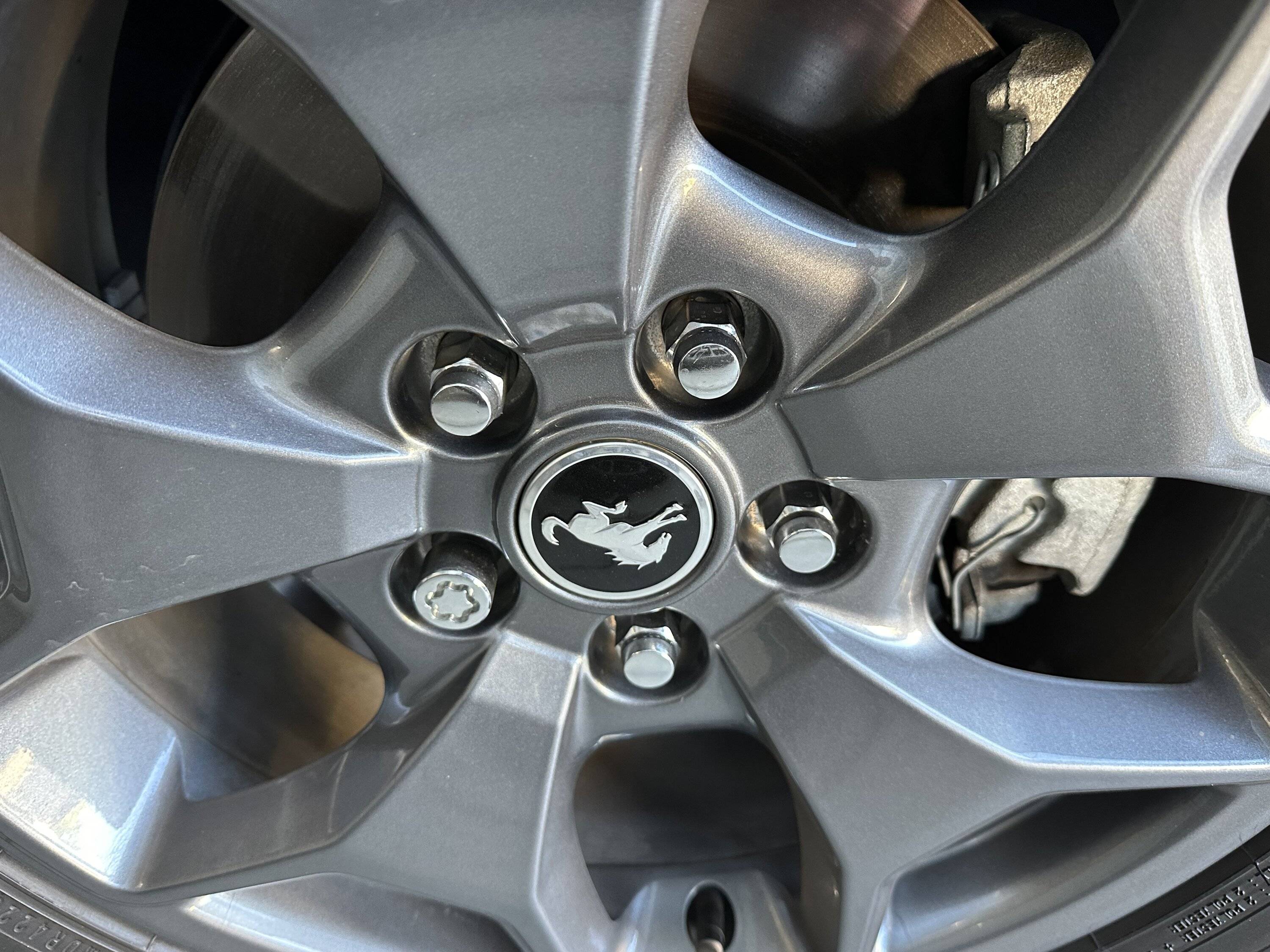

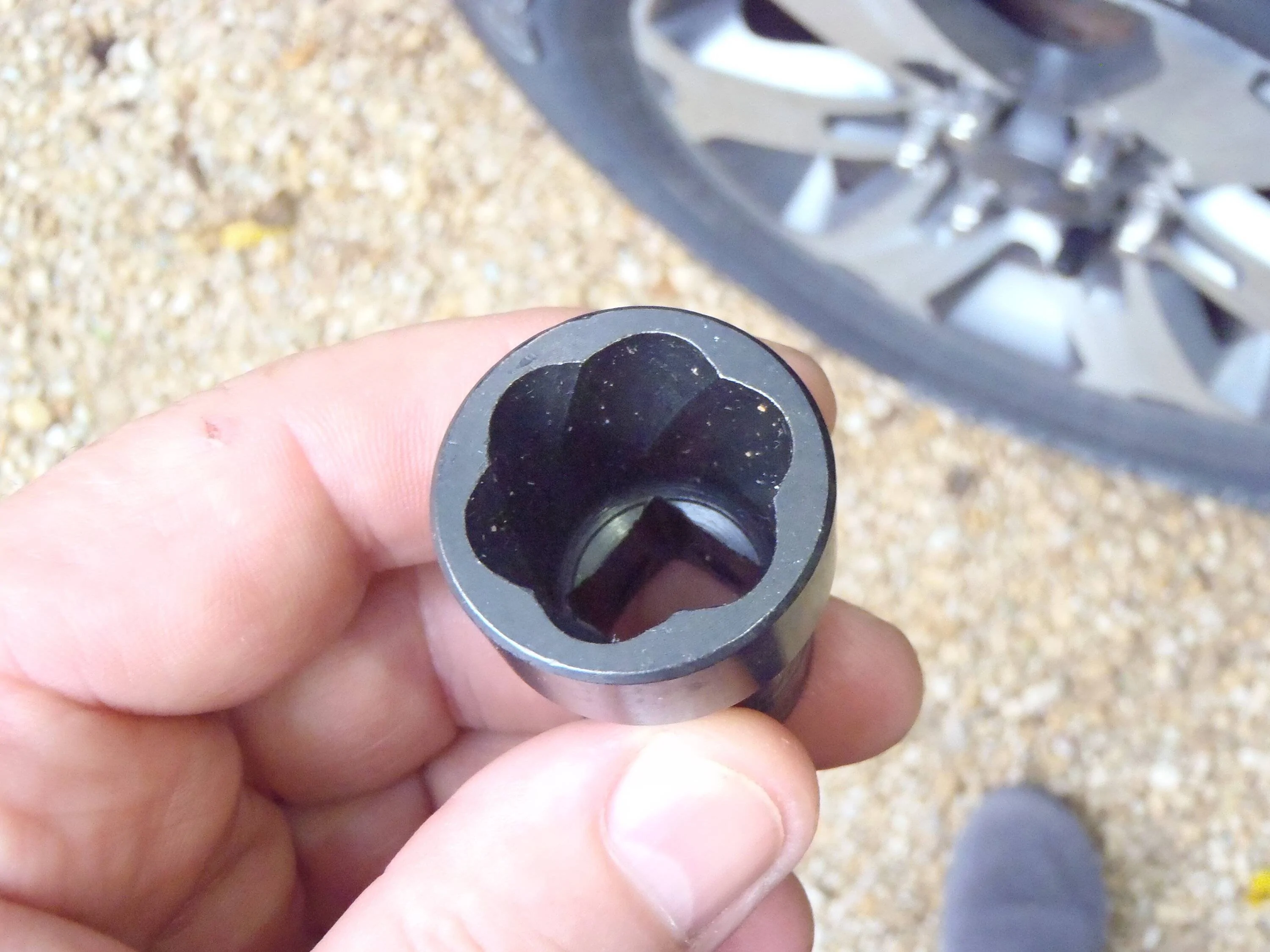

I didn't time it, but it couldn't have taken more than 5 mins. Kudos to Ford for the full-size spare (Big Bend), the jack and handle are actually superb in design, the lift points clearly marked. The acorn two-piece nuts are still original but I had a 'biter' socket with just in case to guarantee I could get them off. Had a buddy way out in the boon docks with a flat on his truck and one of those acorn nuts failed to come off...cost him a pretty penny to get help out there.

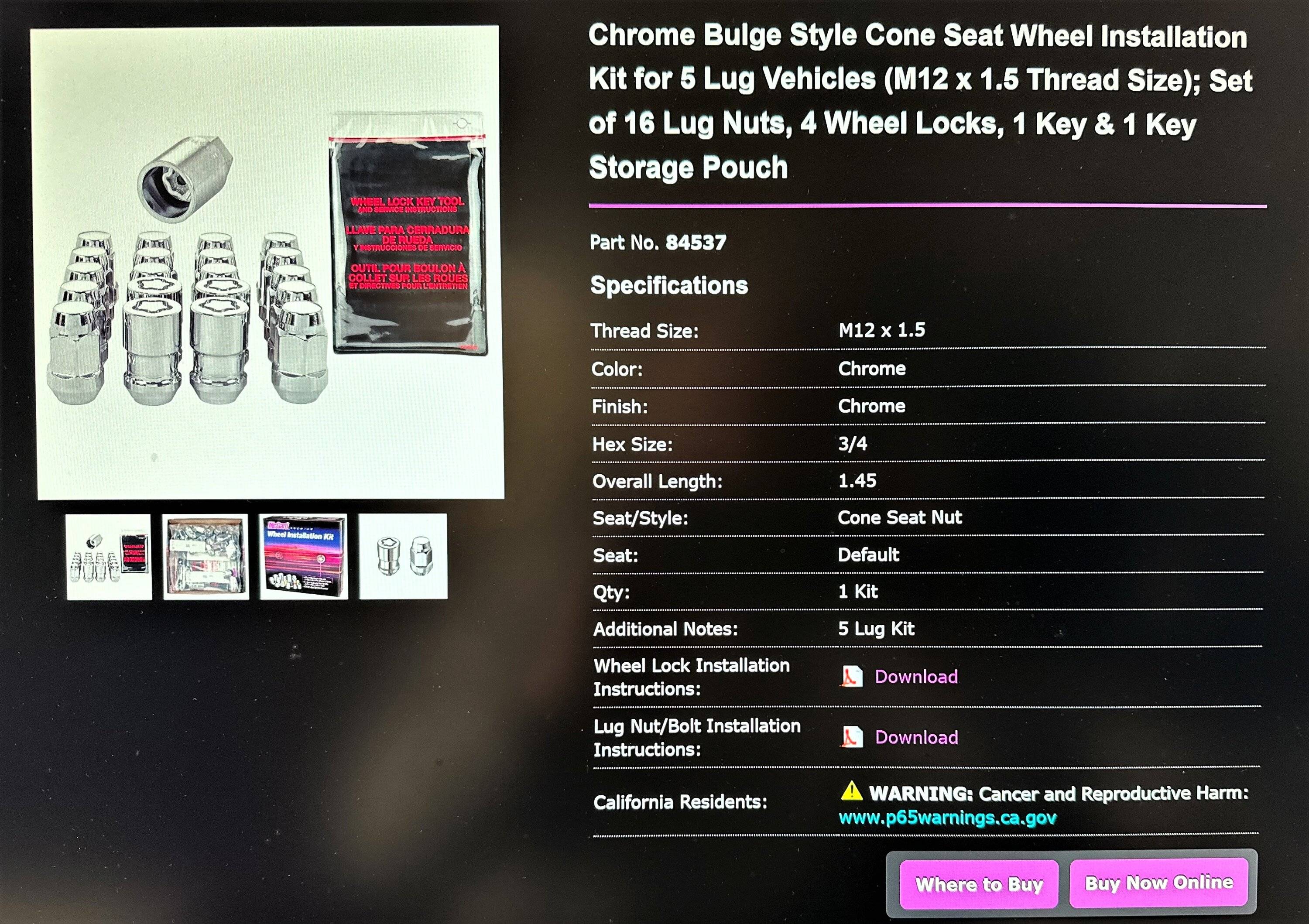

Suggest you buy a set of these. Locking or non locking, black or chrome are available.
There are other brands also.
Ditch those P.O.S. factory lug nuts, especially if you are in a harsh winter area.

I find most locks stick out farther than the stock lugs which I don't like. Do these? They look like they will.
wireman
Jan 19, 2023
113
1,183
2,231
Murrieta
2025 Bronco Sport

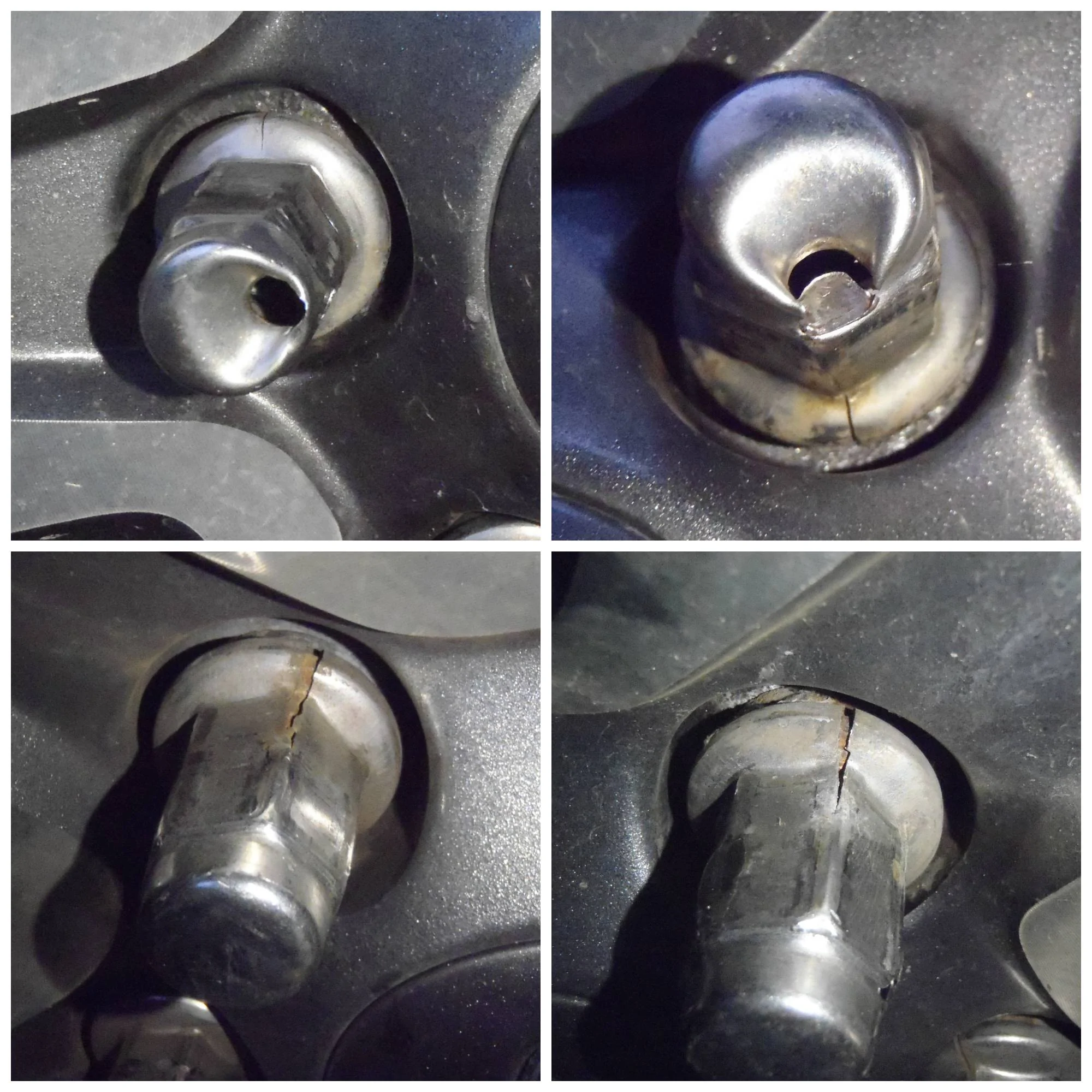

Yes they do. But if you ever have issues with the 2 piece lug nuts, you will be happy you have these.
I live in SoCal with no winter issues, but I had problems with the 2 piece one's on my 2 Ford Escapes.
Dealers using impact wrenches when rotating, etc. deformed some of them. A pain to get off.
Do some research, you may find shorter ones. Either way, they will be worth it.

I had a lock nut on the wheels on my '69 F-250. Discount put it on so tight, I stripped it with my lug wrench trying to get it off. Discount hammered a socket over the lock and removed it easily. If that happened out in the woods, life would be hard.
