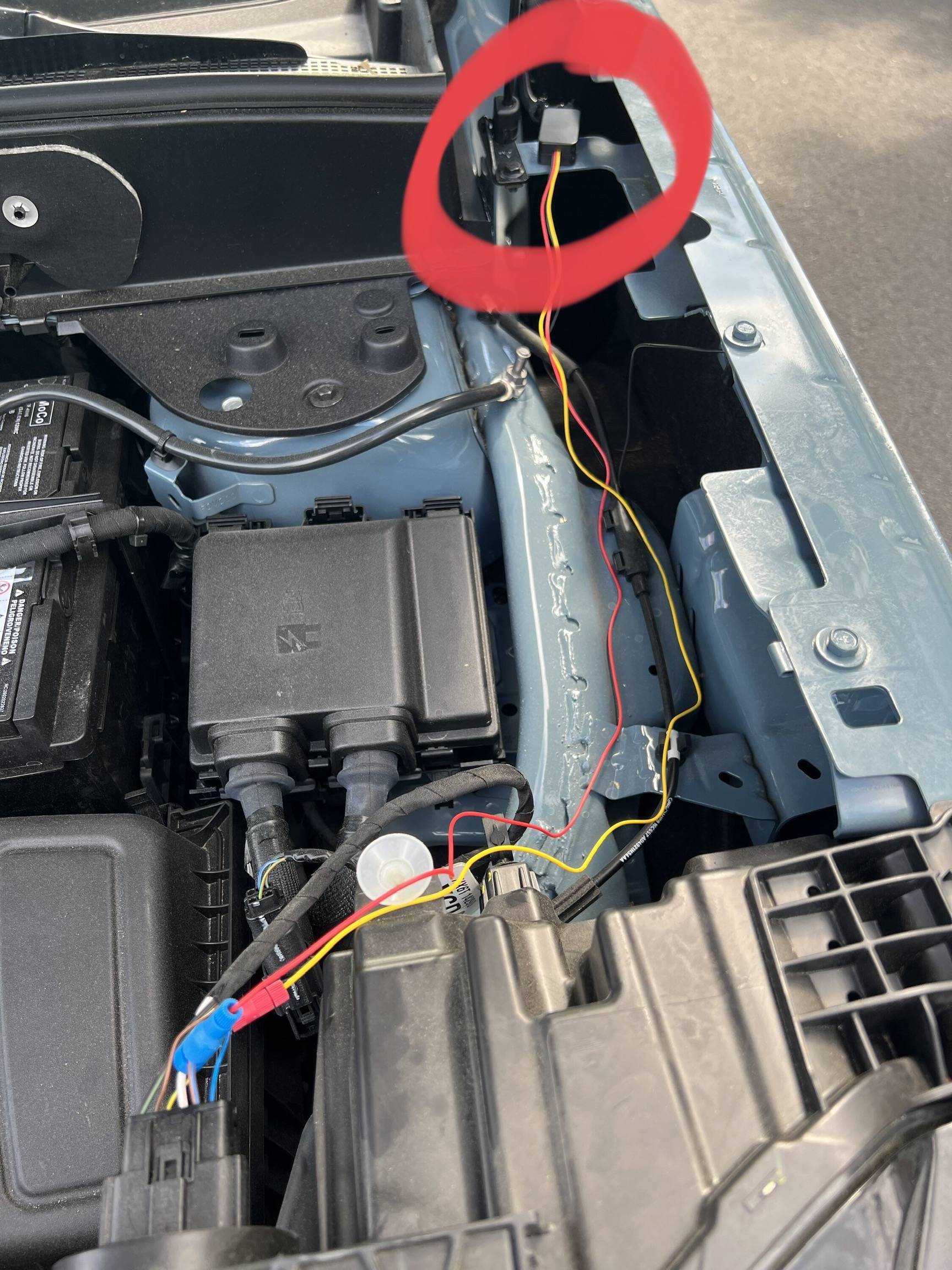

White or amber your choice just cut the red wire behind the black box where the white plug an black box is an connected them together them you have amber light wit turning light
Ford Bronco Sport Fender Side mark light IMG_1158

Looks good Rhel. I did this on my Badlands too, and really like the way it came out.
Though I was a wuss and paid the dealership to install mine.

I did just do it bye my self very easy.
there is a law here in my country, only amber light at side , white at front red at back

I would love to see pictures. I can't believe a dealership would leave the wiring looking like that.

@Rhel so you are saying that yours are Amber and on all the time, but also blink when you activate the turn signal?

Were did find them I ordered a set from Amazon and they were junk.
