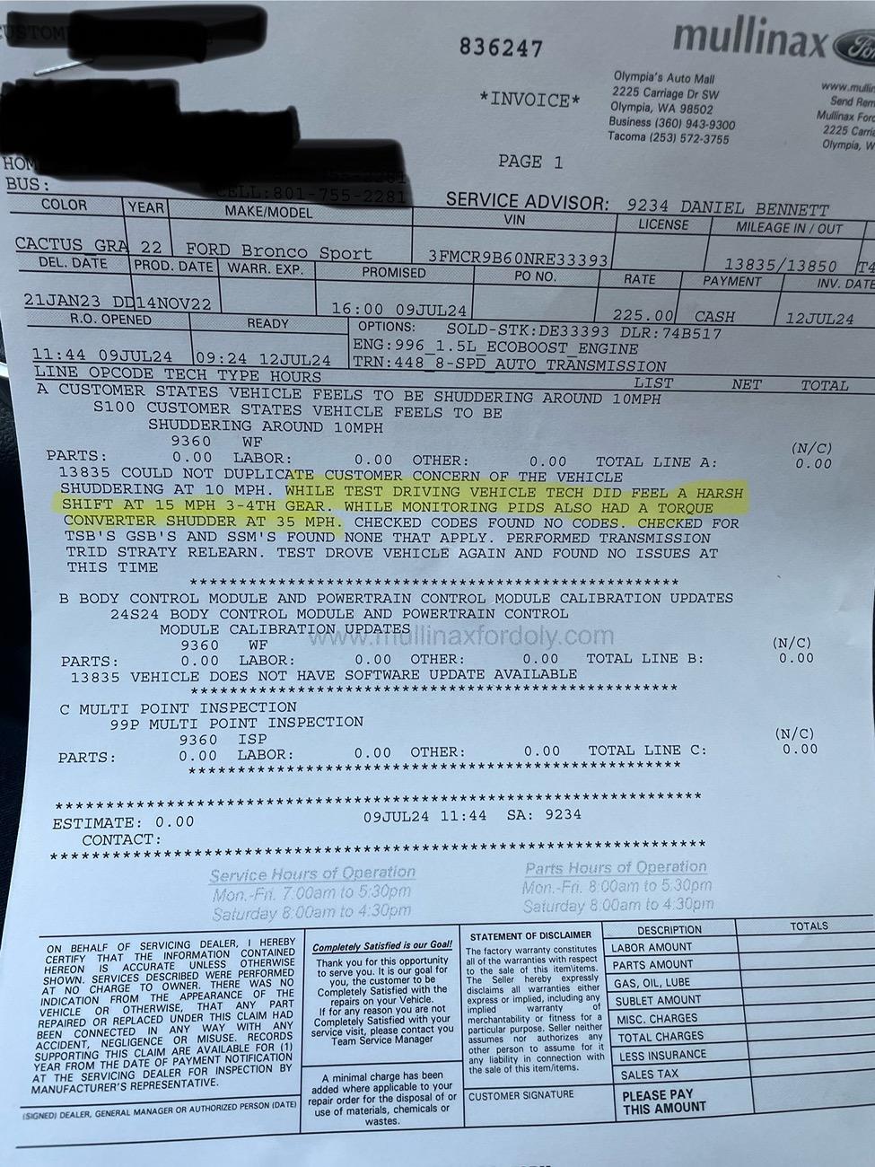

Thought you might find this work order interesting after bringing it in for the sudden onset of shuddering and rough shifting. Atleast I know I’m not crazy lol. Whether it’s related to the recall I Cannot say and am weary to have a strong opinion on it. But interesting none the less

After the 24S24 recall reprogramming is completed, the car's transmission has to relearn. That is accomplished simply by driving it normally.
In Ford's letter to Dealers, it says on the very last page:
"NOTE: Advise the customer this vehicle is equipped with an adaptive transmission shift strategy which allows the vehicle's computer to learn the transmission's unique parameters and improve shift quality. When the adaptive strategy is reset, the computer will begin a re-learning process.
This re-learning process may result in firmer than normal upshifts and downshifts for several days."
