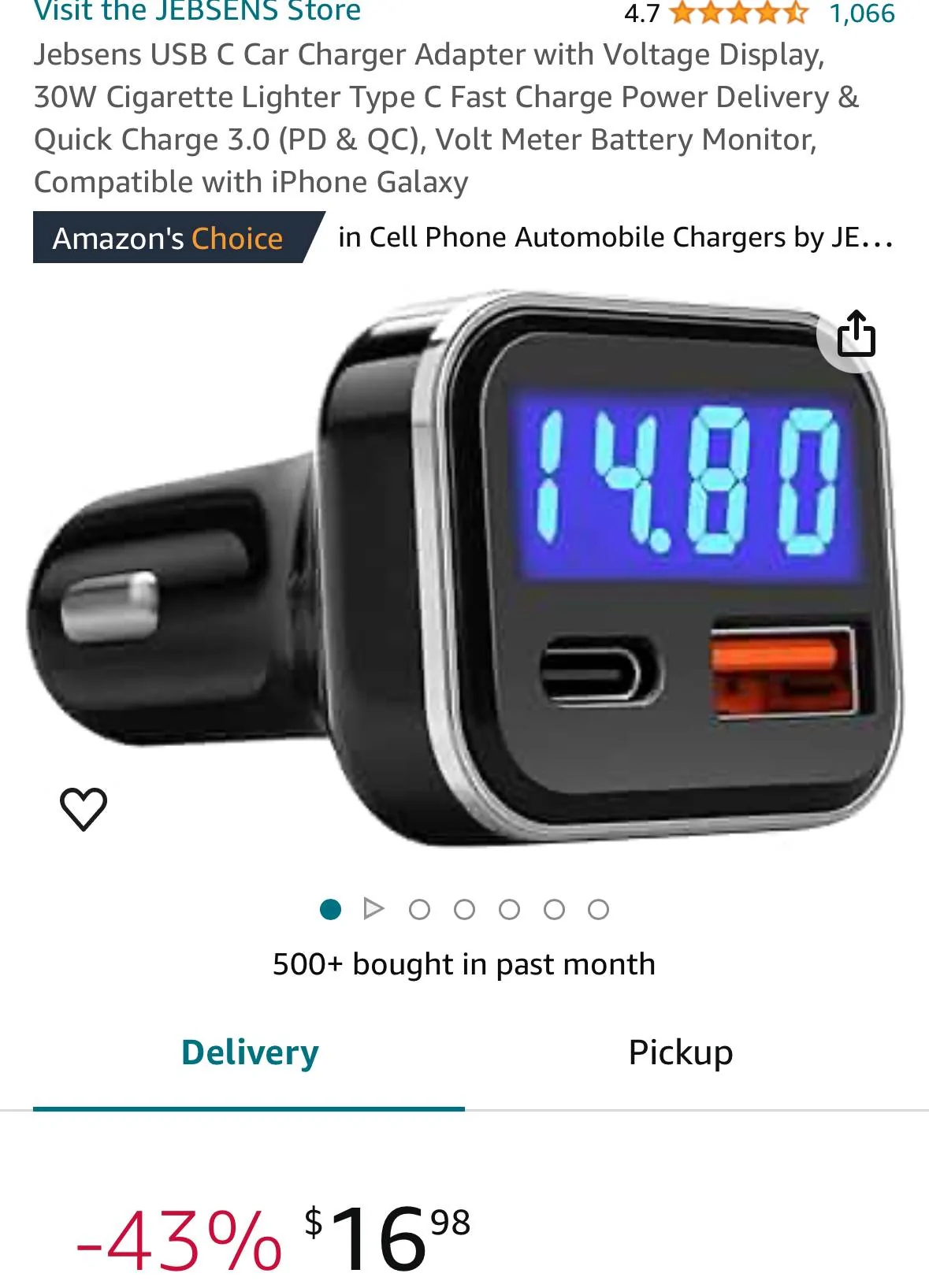

I keep one of these plugged in (below the 8” Display. It’s going to have a small voltage drop because it’s not measuring at the battery so is more of a “quick and dirty” test. When I know the battery is low I will video the device as I start the vehicle to see how low the voltage goes while starting.
Ford Bronco Sport Electrical Battery problems blank screen IMG_1515
https://a.co/d/glj6YK9
Was $13.59 during Amazon sale days last summer
From the Amazon page:
"Bright LED display monitor the voltage of the vehicle's battery with high accuracy (+-0.2Volt)."
Needless to say, it is not reasonable to expect (say) +/-0.01V accuracy from a $17 device, but +/-0.2V is quite a spread. If the actual voltage is 12.4V, the meter might read anywhere from 12.2 to 12.6V -- or 60% SOC to 100%.
Still, if the readings are consistent and repeatable it could be helpful (even if it is not particularly accurate).
Measuring the minimum voltage while starting might be difficult. In fact, it's hard even with many expensive Fluke meters. For example, my meter has a "min/max" function, but in addition to that, what's needed is a fast sampling rate. IOW, the minimum voltage displayed probably will not be the actual minimum -- unless you get lucky -- and there's no way to know.

No harm in that. It sounds like the current varies. If so, getting an average for you calculations might be difficult.
Yep I agree with all that and it’s the quick and dirty ballpark measurement that I use for
trends not for knowing 12.6 vs 12.5
