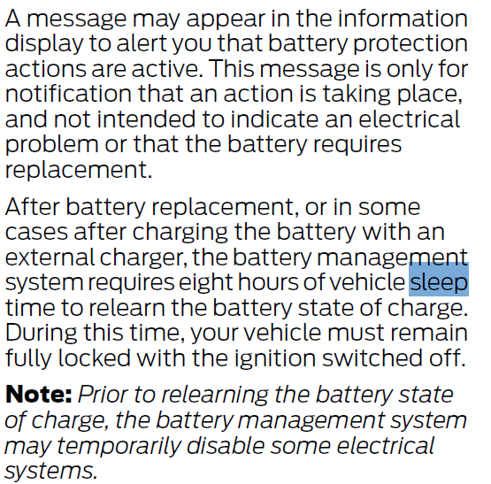

I'm not sure about when "Sleep Mode" is activated. If "Deep Sleep" is 14 days, maybe Sleep Mode is just a few days?
I just searched the manual for "Sleep Mode" and found nothing. The only thing close is:

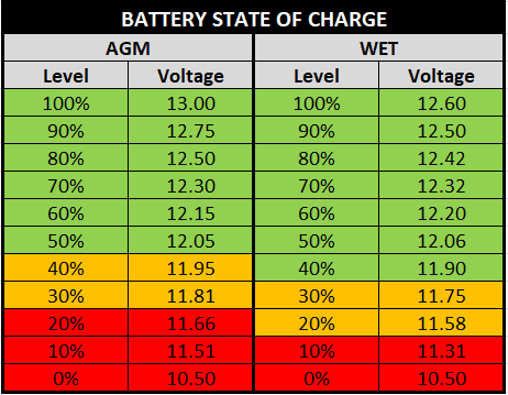

I agree the 9.5V in Ford’s article seems unrealistic
As far as remaining above ~12.6V, one of these days I’ll do the calculation using the battery Reserve Capacity Spec. The Bronco Sport AGM and EFB are both rated at a Reserve Capacity of 120 minutes. That is a separate spec from Cold Cranking Amps.
Reserve Capacity definition: “a time measurement in minutes for long a fully-charged battery can deliver 25 amps of current in an 80°F environment, before the battery is discharged down to 10.5 volts.”
Using the “average” parasitic current draw for Bronco Sports I can do a calculation. I do not know the average so I’ll need to measure mine in a steady state condition after things settle down but I suspect is between 50 to 100 milliamperes (0.05 to 0.10 Amps per hour) but might be much higher given the number of Bronco Sports we’ve all seen posts on that seem to drain pretty quickly but then probably aren’t kept anywhere close to a fully charged state (and probably not at 80°F in the winter). Maybe they are on average in 60% charge state or less and the 120 minutes of Reserve Capacity is going to drain down fairly quickly but should still be well over 7 days before reaching 10.5 volts.
The Bronco Sport does wake up many times in a 24 hour period for various “housekeeping” tasks which adds to current drain. There is a video where someone instrumented their vehicle to demonstrate that.
Let’s assume the 40% SOC is accurate to enter deep sleep mode (AGM: 11.95V, EFB: 11.90V), it’s not going to be too many days from say a 60% charged battery but I’ll do the calculation once I know a good number for parasitic current draw.

No doubt the battery in the WRX has a lower parasitic load. I was just pointing out that the parasitic current draw in the BS seems excessive.. There may be a good reason for it but offhand it seems like a poor design.
For now, you might consider just measuring the resting battery voltage. It would be interesting to know the current draw, but the main consideration is the battery voltage/SOC. It sounds like the current can vary, so depending upon what's going on when you measure it, it could be above or below average.
You said, "Maybe they are on average in 60% charge state or less and the 120 minutes of Reserve Capacity is going to drain down fairly quickly but should still be well over 7 days before reaching 10.5 volts."
Just to be clear, a battery should never get anywhere near 10.5V/0% SOC. That is very harmful. Lead-acid batteries like to be kept at 100% SOC.
