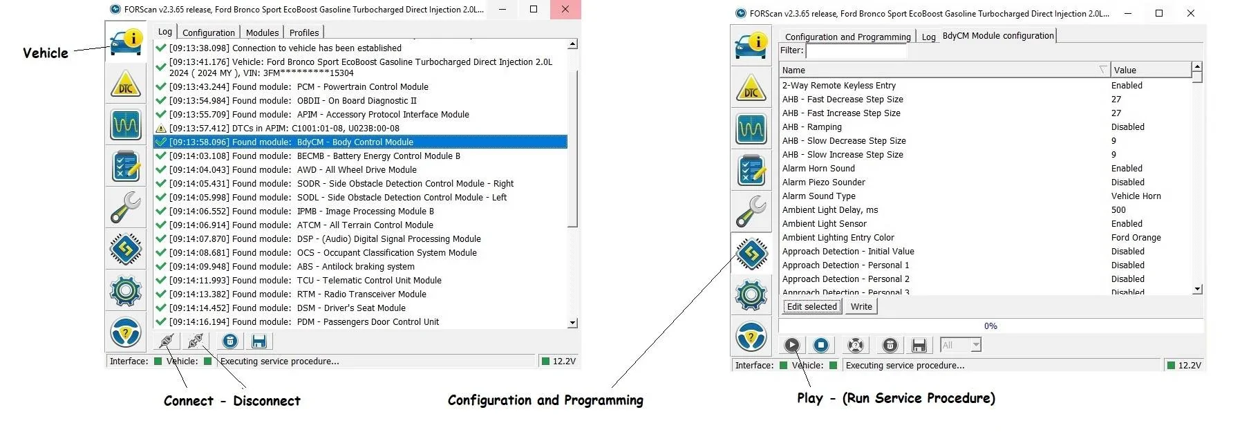

Jumped into the FORScan mystery machine. There really needs to be a FORScan for dummies thread to lead a novice thru it. For less than what the ASS Eliminator costs, you can do that and so much more.
I already have the ASS Eliminator on the Bronco so left the ASS alone.
Did switch off/on as applicable these four things:
Double honk disabled - this alone is heavan on earth.
Panic alarm mode - Lights only
DRL include Park lamps
Using front fog with high beam (Bambi mode)
This USB 2.0 cable worked fine - strung out my office window to the Bronco.
If you have a laptop so much the better - no cable needed.
https://www.amazon.com/dp/B0777MR56X?ref=ppx_yo2ov_dt_b_fed_asin_title

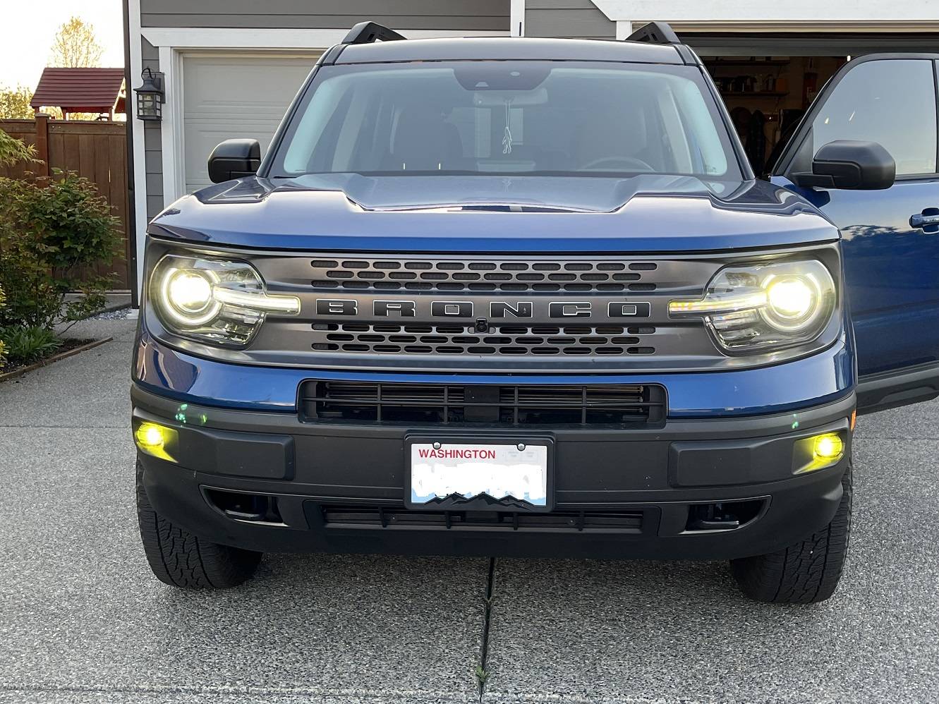

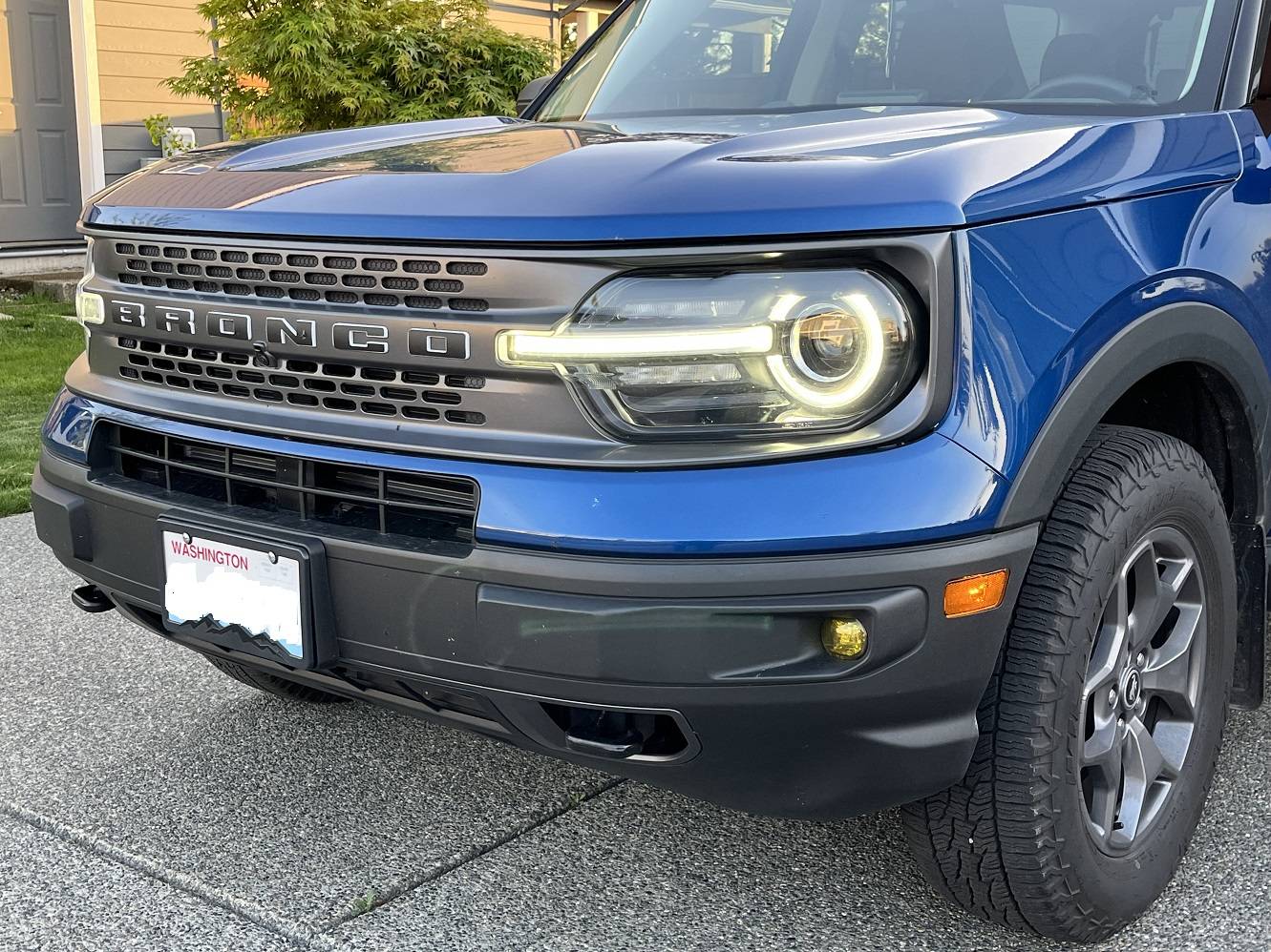

Headlights in auto position. Daytime Running Lights include park lights test:
