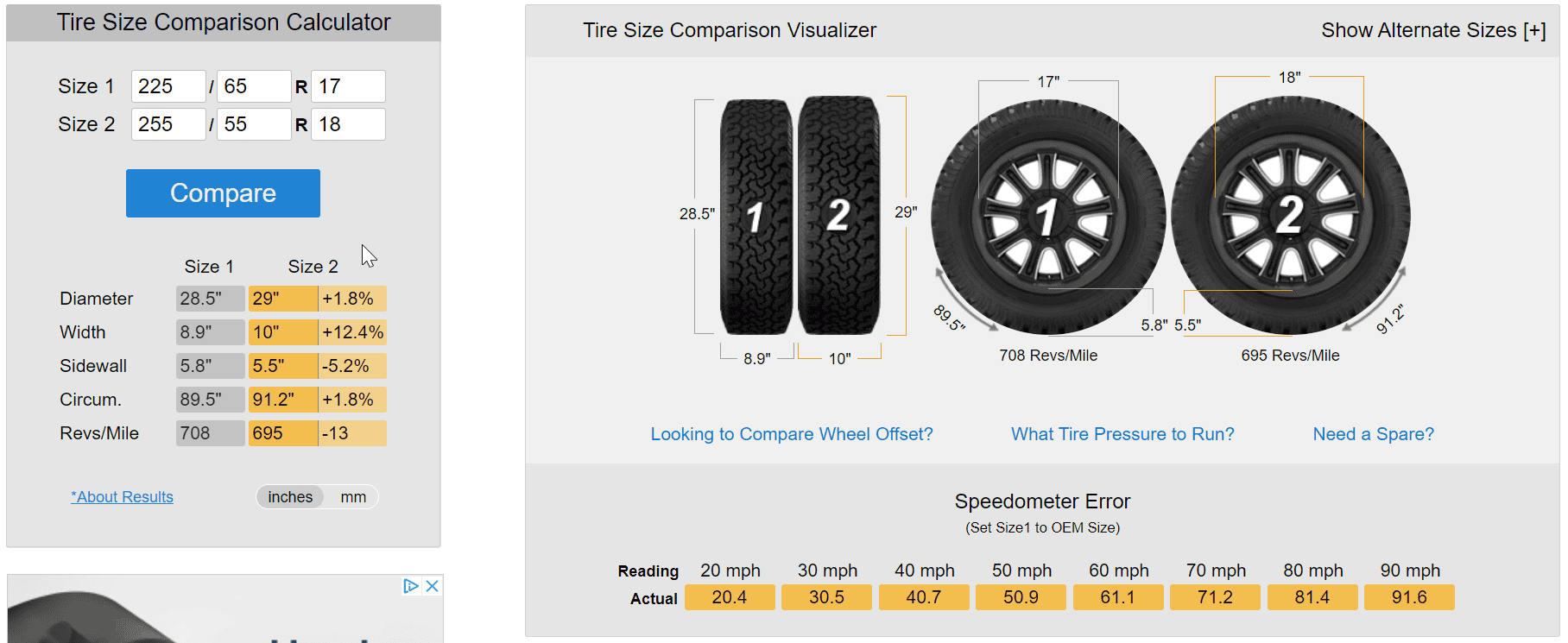

I think it should be fine. The diameter is less than the limit of 29.5", above which some rub in the front can happen with some compression and the wheel turned. The extra width should also be fine. There doesn't seem to be much issue with wider tires. Lots of 245 width tires have gone on (mine included) and there is nothing close to rubbing, so adding another 10mm to the width should be fine. I know that there is at least one person on here that has installed a 255 width tire.
TireSize.com
Ford Bronco Sport Do 255/55R18 109H tires fit the 2023 Bronco Sport Badlands? 1693398938976
