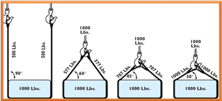

Yeah, using a bridle with fixed length legs helps when you need to maintain alignment. Using a sliding bridle does a better job of distributing loads when things arenā€™t aligned perfectly.
A tow strap run from one hook, through the pull line, to the other hook will self adjust to a large degree. Youā€™ll keep some load on both hooks, even if you arenā€™t pulling straight inline. With fixed legs, if either vehicle turns enough, one leg will go totally slack.
Also, the longer your bridle, the less extra load youā€™re adding.
Ford Bronco Sport Distribution Recovery Link IMG_0532
101
5,321
10,006
I would be very careful about adding ANY metallic objects to a recovery rope/strap. These can become deadly missiles if a tow line breaks. If you need to increase leverage on a tow line then I would look at a pulley system that's designed for the task. Even then, I would be very careful about how the pulley is rigged to reduce/eliminate the danger posed by a snapped tow line.
This is some great info and diagram. Thank you!
