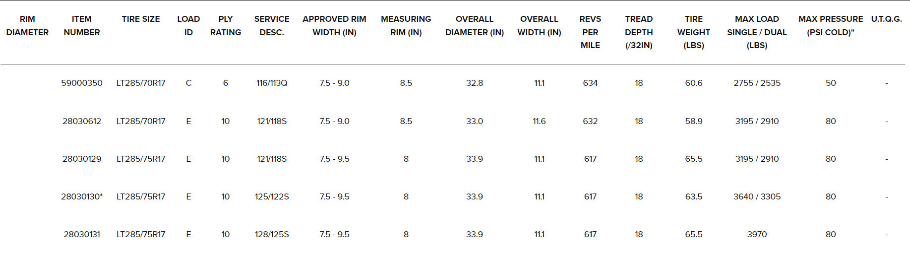

For example:
Ford Bronco Sport Explainer: why OE tires are different. 1708459343540
For the top two 70-series tires, the load ID/ply rating is different.
The 75-series tires have different max load ratings (lbs.) -- and the first 2 are rated for single or dual use, the 3rd one is single use only, although at 3,970 lbs. it is rated much higher for single use.
Nothing vendor specific there.
That begs the question -- why do all of the 75-series tires have the same E/10 ply rating?
In any case, I can find nothing to indicate that Costco's tires are any different from those sold elsewhere. Every source I found says they are exactly the same.
If they were different, they would have to have some unique identifier.
The claim that Costco (and Sam's Club, etc.) sell inferior products -- from tires to toilet paper -- has been around a long time. I have never seen proof of that. It's likely that the rumor was started by smaller competitors since they cannot compete on price.
It's hard to imagine a reason why a respected name brand mfr would degrade the quality of their product for any retailer -- even one as big as Costco. If word got out it would damage their reputation, and Costco's.
Also, while it might be possible to set up a completely different manufacturing and distribution system for ONE retail chain, it would probably end up being more expensive than making one high-quality version of a product.
