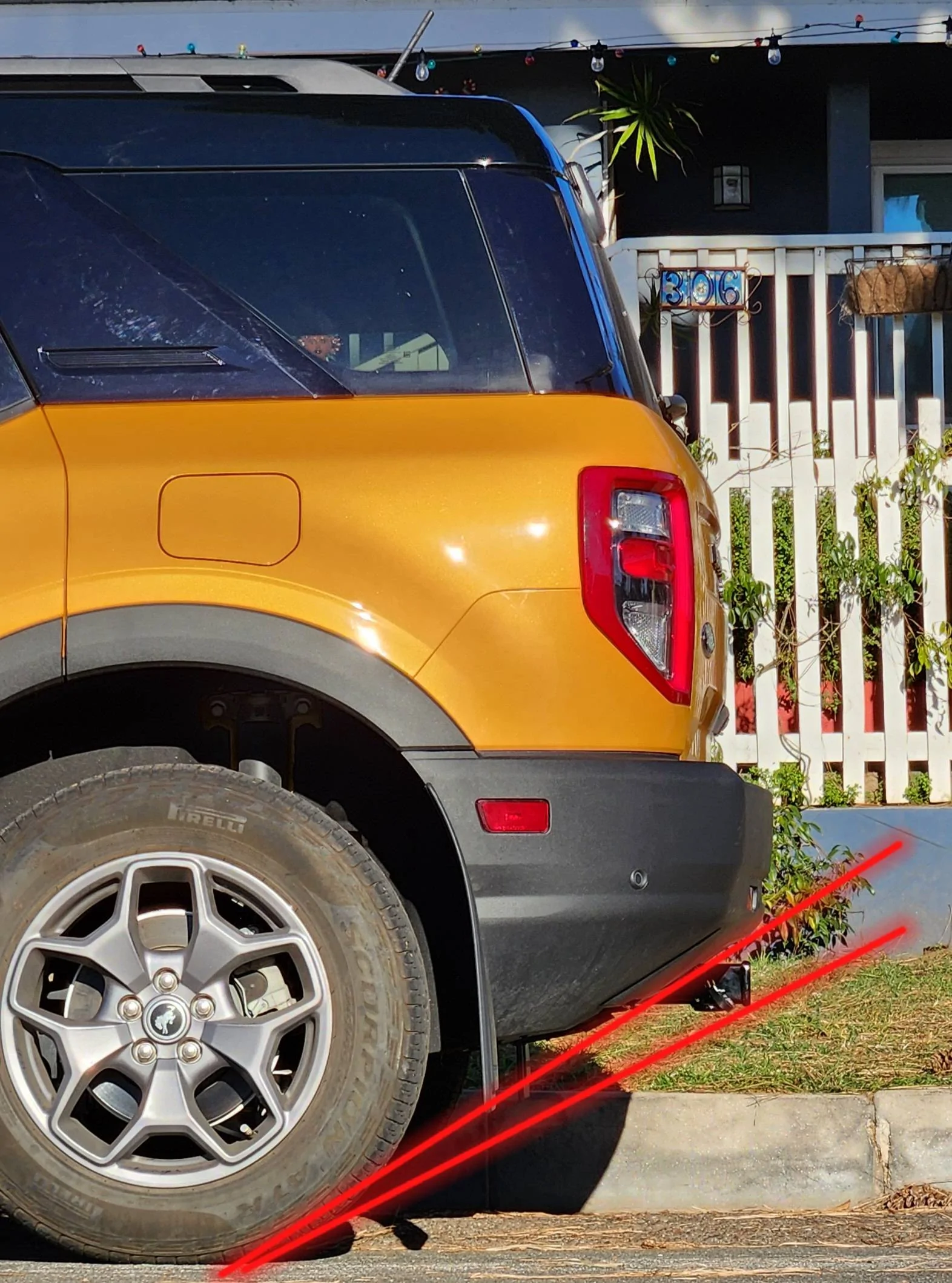

I was having trouble finding many photos of how much the Curt hitch stuck out, reduced departure angle, etc.
Here's a photo and a garbage phone drawing approximation. I went the U-Haul route and it was around $560 with wiring.

Nice contribution to the forum.
I measure a loss of about 3 degrees of departure angle, from about 30 degrees (no hitch) to about 27 degrees with the hitch.

Sounds about right! I wish it was zero loss, but making the sacrifice seems reasonable enough. I wonder if the OEM hitch is tucked enough that the departure angle is unaffected.

I used a graphic editing program to measure the angles.
I'd measure a stock hitch too, if I had an appropriate photo.
I'm a couple weeks away from delivery of my BS BL, or I'd shoot a pic of mine and measure it.

Various sources quote the Badlands (no hitch) departure angle as 33 degrees, and above, I measured about 30 degrees.
Because camera height, vehicle leveling can all affect the measurement from a photo, there is some error in this measurement.
In the new photo here, I measured the difference between the stock hitch and the no hitch as about 1.5 degrees.
I'd go as far as to generalize that the difference between the Curt hitch and the Ford hitch is about 1 - 1.5 degrees in departure angle.
Or interpolating using the 33 degrees as starting point:
No hitch (Badlands, First Edition, or Heritage Limited)) 33 degrees
Ford hitch: 31.5 degrees
Curt hitch: 30 degrees.
IMO, that's still very impressive for a soft roader.

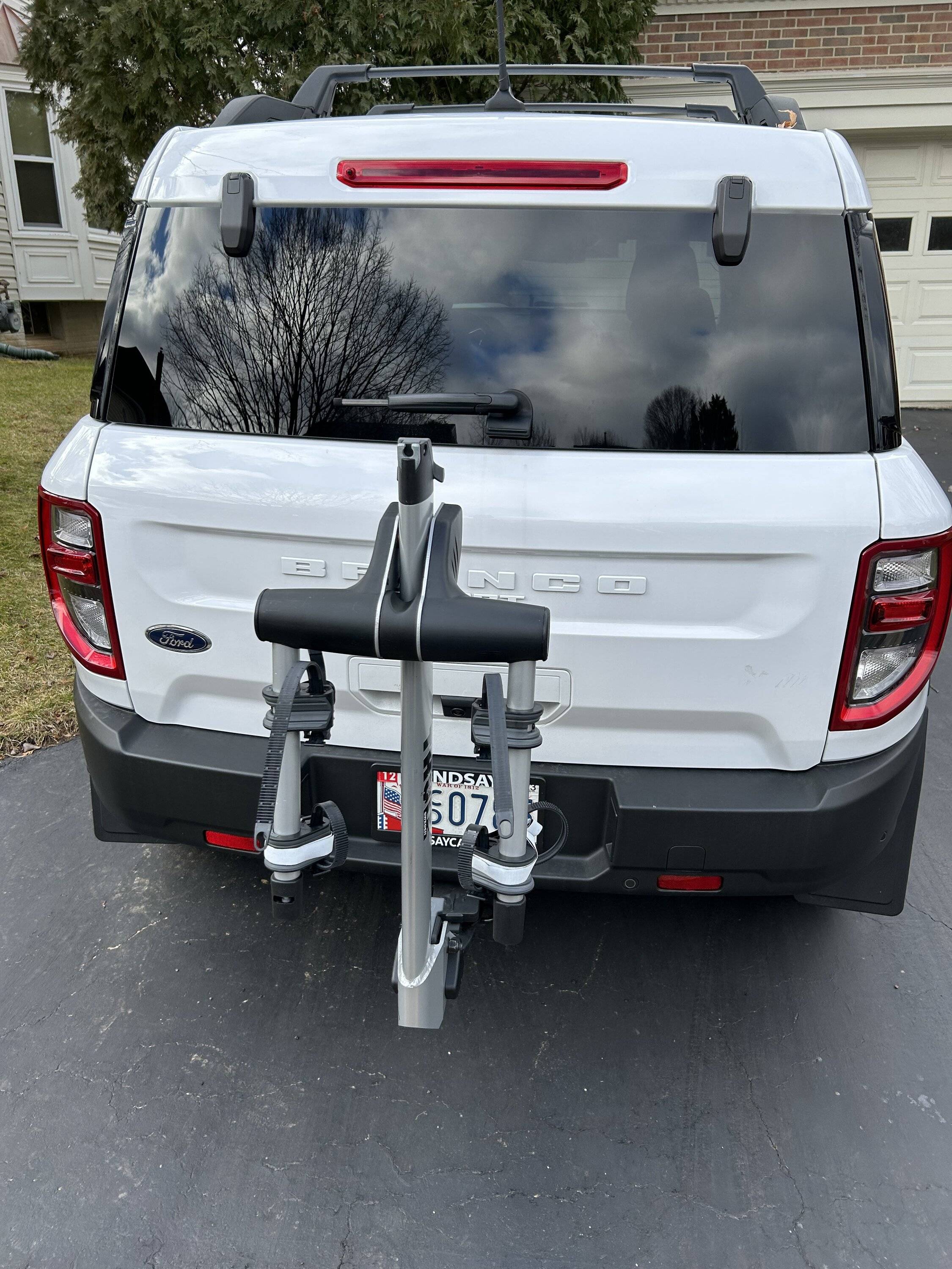

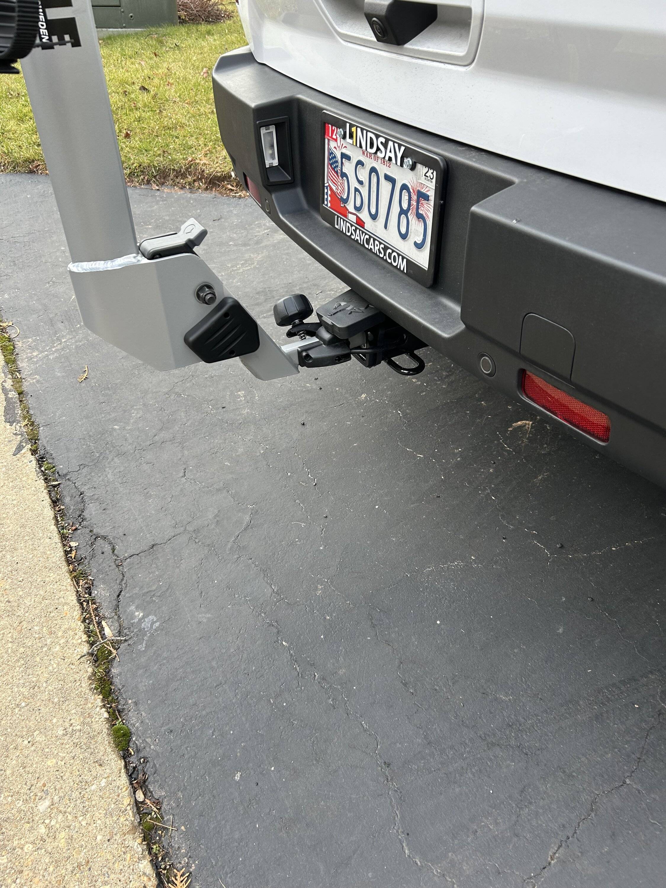

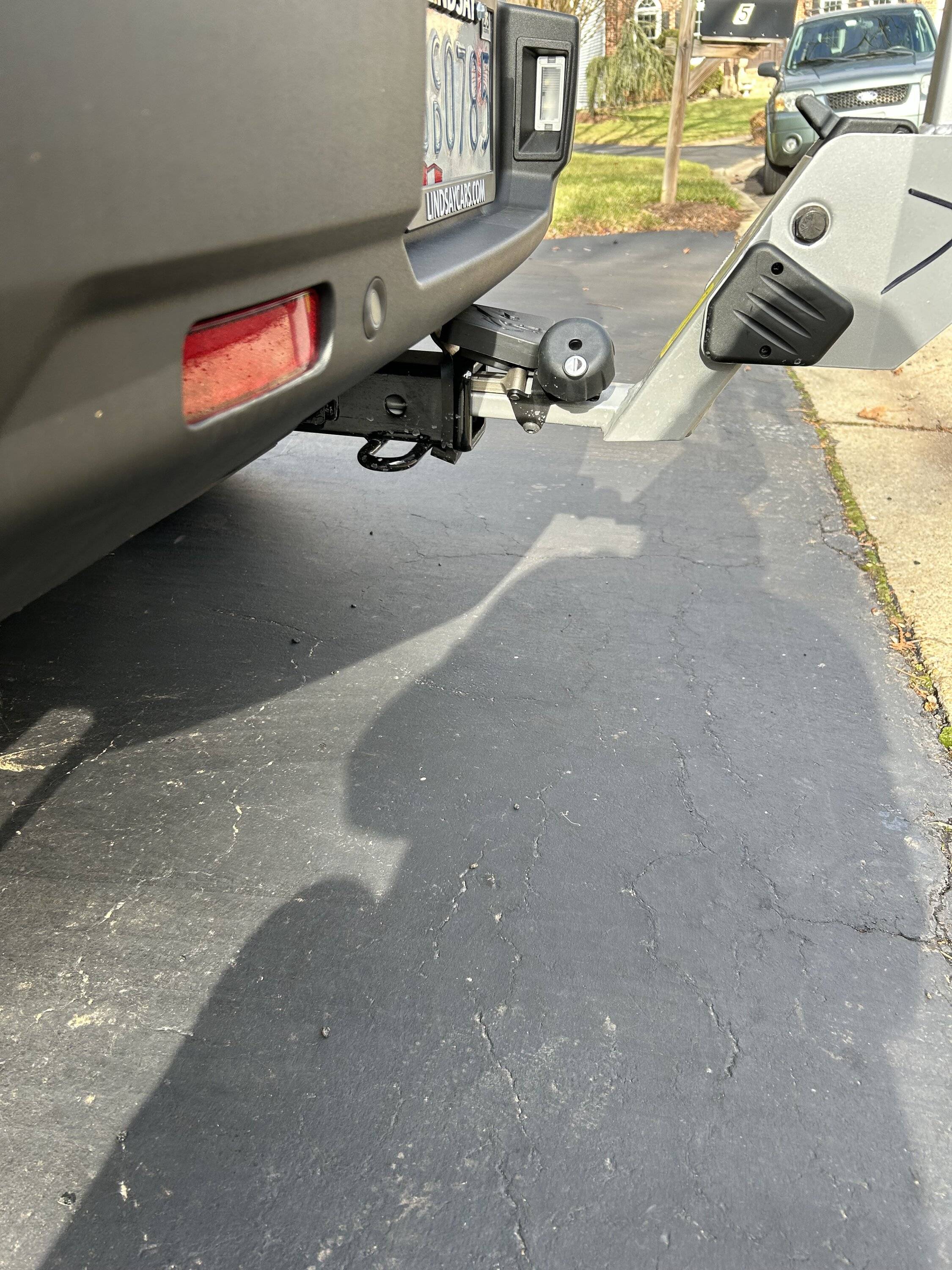

Here is mine. I did not do the wiring so tow hitch and installation was only $307. Bike rack was another $130 from Craig's List.
Ford Bronco Sport Curt Hitch Installed IMG_3710
Ford Bronco Sport Curt Hitch Installed IMG_3712
Ford Bronco Sport Curt Hitch Installed IMG_3711
