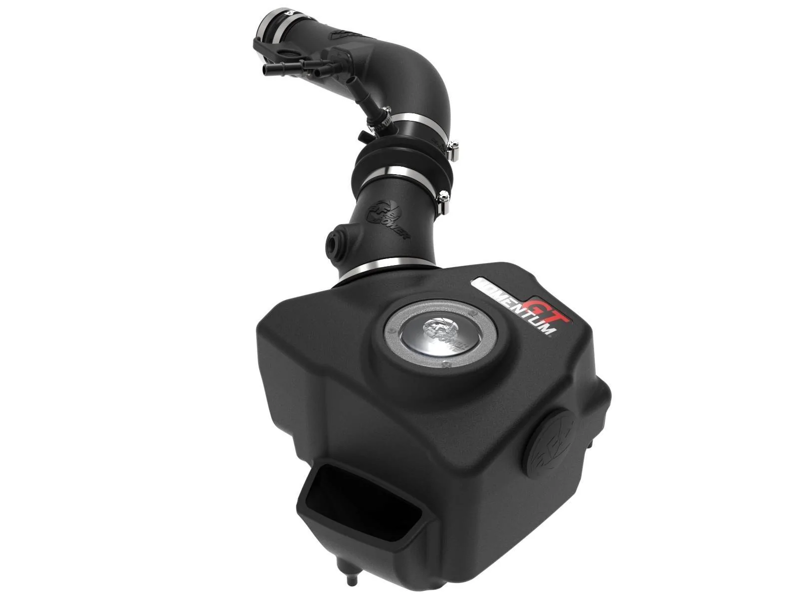

This is the first real intake system I've seen for the BS. I've seen lots of ppl throw the K&N filters claiming "gains"; which I'm very skeptical of. I've had a few intake systems installed on cars and had noticeable increase of HP. (Or maybe it was the $300+ I paid and I kept telling myself there were "gains" to justify my purchase)
I love how it's enclosed for when we splash around and get the engine bay muddy; the filter will stay dry ??
Has anyone installed this yet?
https://www.stage3motorsports.com/50-70079d-21-22-bronco-sport-maverick-20l-afe-power-momentum-gt-cold-air-intake-system-with-pro-dry-s-filter.html

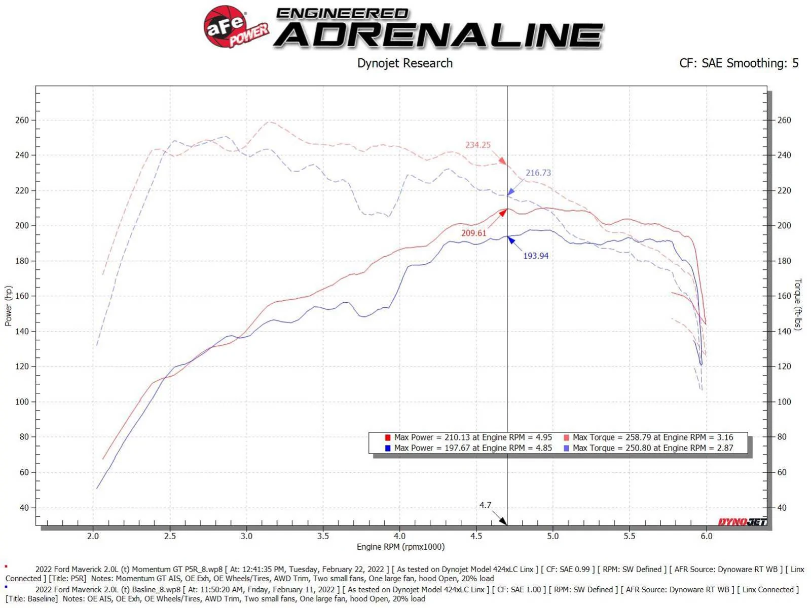

I would be curious to see how these numbers stand up when tested by an independent authority.
Thoughts? Wouldn't even be close? I don't have a lot of experience with CAI systems.
