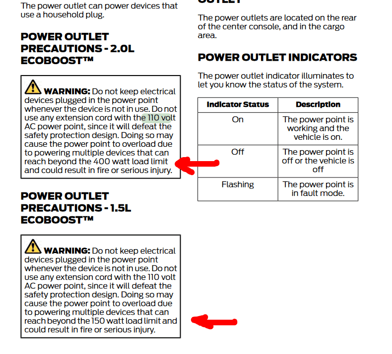

Glad you posted the question OP otherwise I would have missed this oddity in the amperage levels between the 1.5L and the 2.0L. (See O/M, pg.174)
Seems the 2.0 BL model gives you a better footing on carrying enough power for at least 400 watts while for some reason Ford significantly dropped the muscle on the 1.5 engine inverter. Really cheaped out with only 150 watt max.
So to partially answer your question OP, sure you can do it. Just work your way backwards when configuring what you need. Start with the compressor you're looking to use and determine the amps or the watts it will demand. Adding a few more to that level for a safety margin keeps you below popping fuses.

Thanks for posting that. After seeing the original OP post I actually became curious about adding one to my BB as well, for things likes small compressor or similar for when I go off mountain biking. Knowing I have a 150w headspace helps. Following this thread, if anyone has done the power point themselves I would love to hear about ease or issues with the install!
