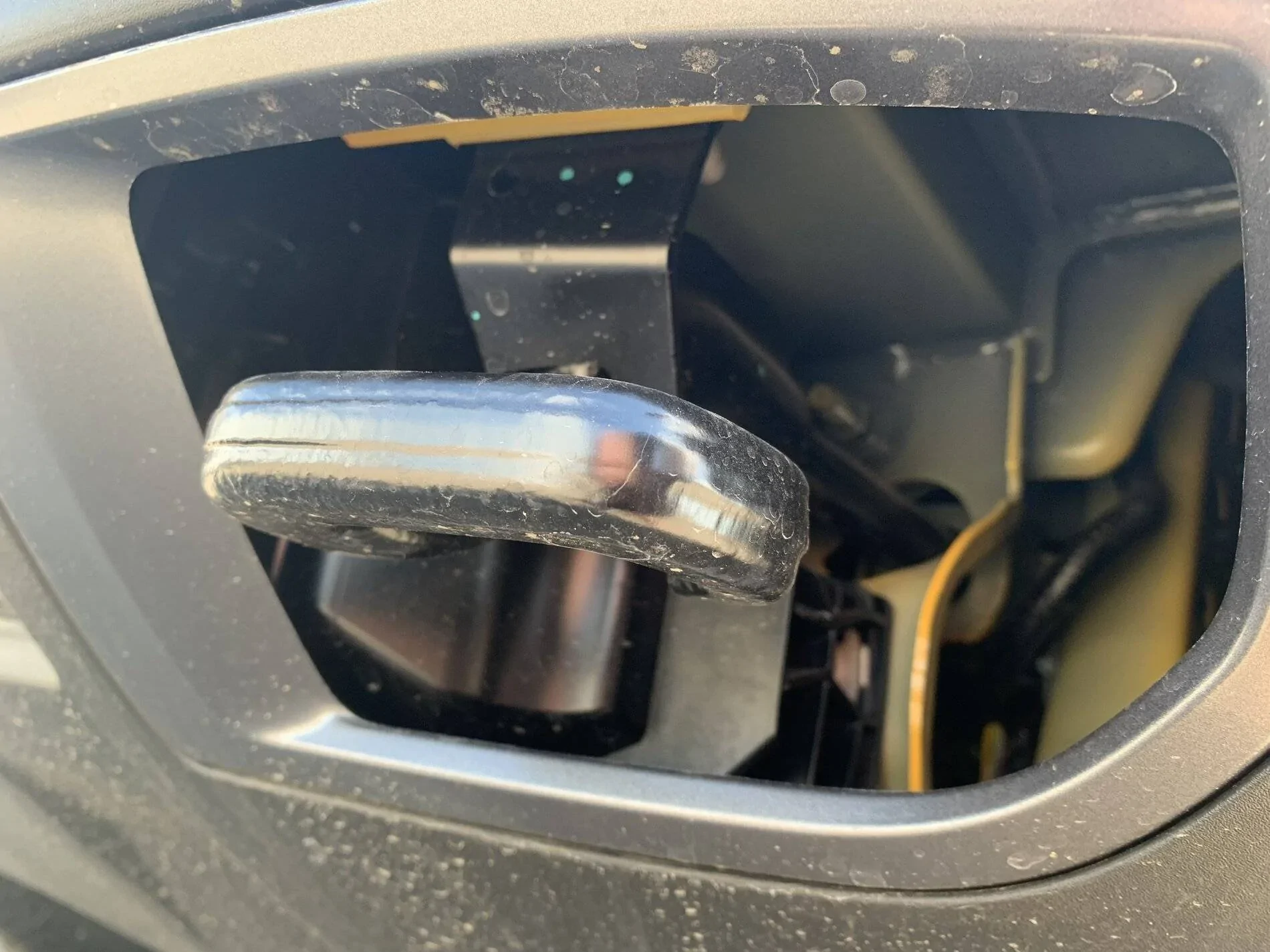

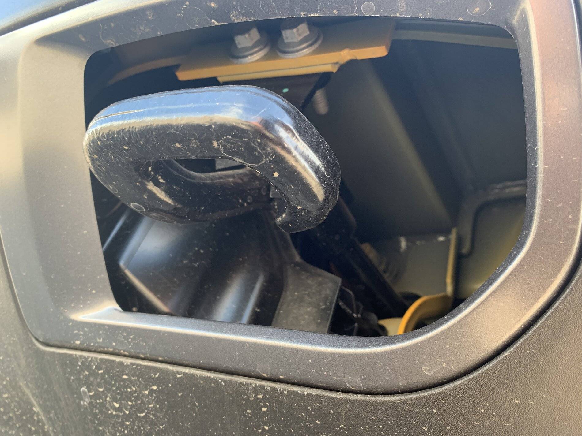

There's extra bracketry that is welded on to the front structure of Badlands models. The rear threaded portion of the hook slides into that structure and is secured with a nut.
