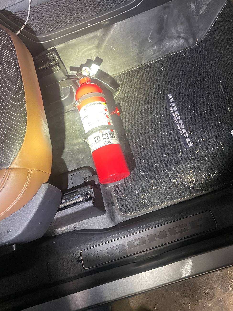

I also made a sweet fire extinguisher mount, quick release easy access.
Ford Bronco Sport Bull bar/nudge bar/front sensor question IMG_6035

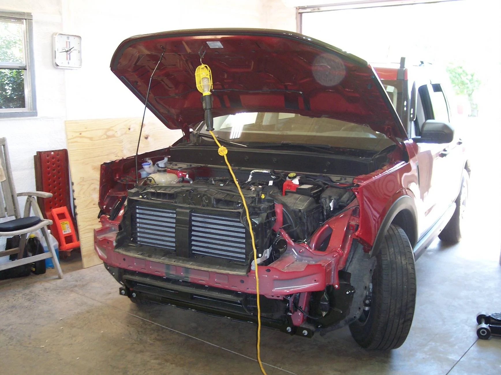

When my wife & I installed the Rough Country nudge bar to her BS/BB we had to remove the front bumper & grille assembly to attach thew mounting brackets to the frame.
Ford Bronco Sport Bull bar/nudge bar/front sensor question 100_2062

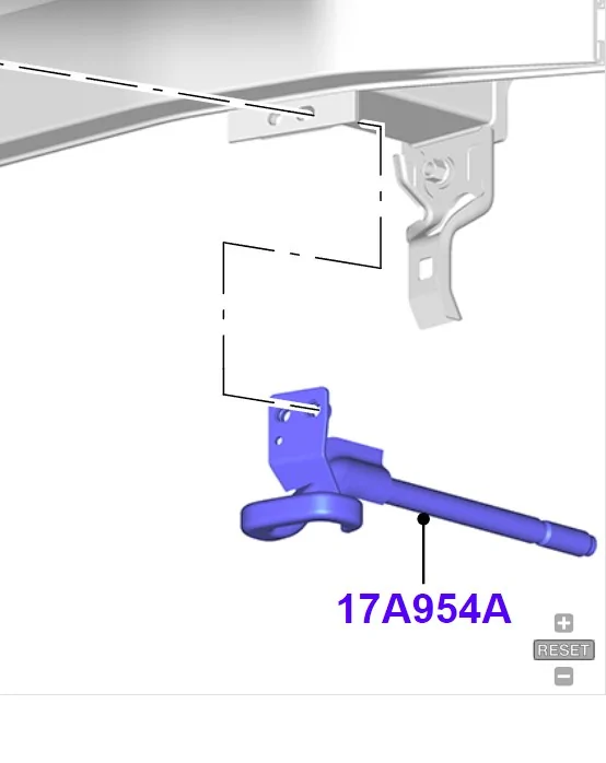

the badlands (and first editions ) have an extra piece in the subframe about 12 inches deeper than those mounts you have there, it is an additional mounting support that hat is clearly designed for pulling forces.
The 2.0 engines have an additional structure right behind the hook about 18 inches back. Made of a reinforced loop of roughly 1/4 inch
Thick by 2 inches wide , that is designed
To take a flange nut and transfer load feom
The hook to the frame. The lower trims don’t have this and pulling might go VERY badly.
Here is a diagram of the lower trims and the hook that Both use.
If there wasn’t a reason to have the giant pole on baxk what have it? Except it is cheaper to have the lower trims and upper trims share a pet, but adding the lower xtra grams struxture
Would be a significant expense so they don’t do
That.
Ford Bronco Sport Bull bar/nudge bar/front sensor question IMG_7102
6,731
13,134
The back of the tow hook is threaded. It goes though a mounting bracket and is secured with a nut. The bracket is welded to the subframe. You can view a photo of the assembly here.

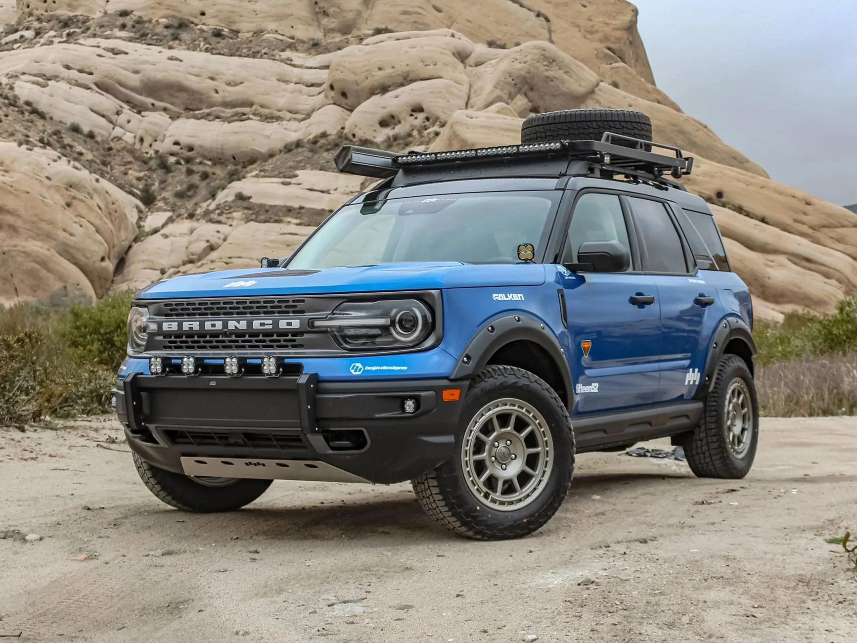

Has anyone with Adpative Cruise control on their BS tried the Rally Innovations bar and not have it block the sensors? I've emailed them and they say it does not but it seems to come a bit over the lip to where the sensor is located. Really like the looks and functionality of it. Plus the tow hooks remain in place.
Ford Bronco Sport Bull bar/nudge bar/front sensor question 2022BroncoSportRLBFront3_4_1024x1024@2x copy
