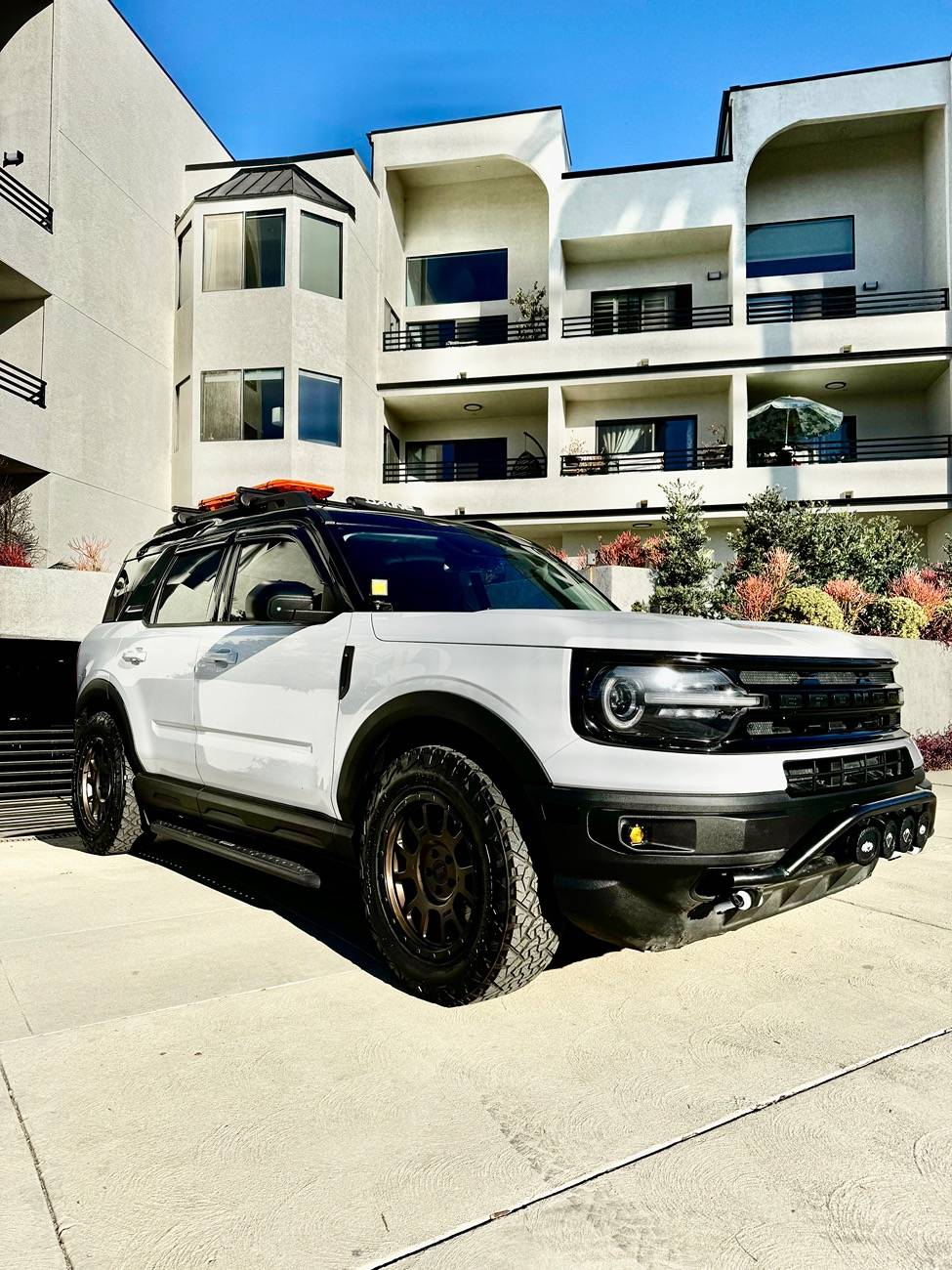

This is pretty impressive man. What all have you done/added to your rig?
So far..
- Wheels / tires (245/65/r17)
- Nudge bar w/ lights
- ditch lights w/ hood mounts from FordRangerLifts
- cross bars
- s1 pod fog lights kit from Baja Designs
- Running boards from GoRhino
- Illuminated LED side markers (Amazon)

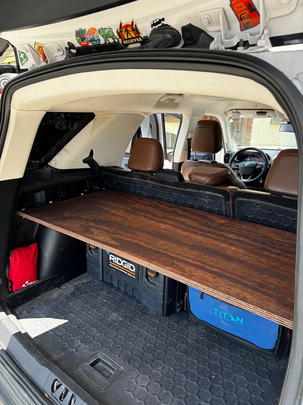

- Custom built in trunk shelf (Mounts were fabricated by someone on Facebook)
- AVS window visors
- Vinyl wrapped rear ford emblem
- Blackout the front grill letters
- Tinted windows, tail lights, bumper lights
- Wolfbox rear view digital mirror
Next..
- FordRangerLifts 2 inch lift kit
- 245/70/r17 tires (pinch weld must be shaved)
- Trailer hitch
- GoRhino roof rack
-Auxbeam light controller

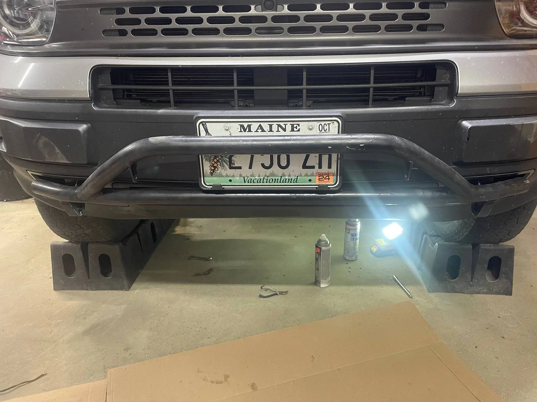

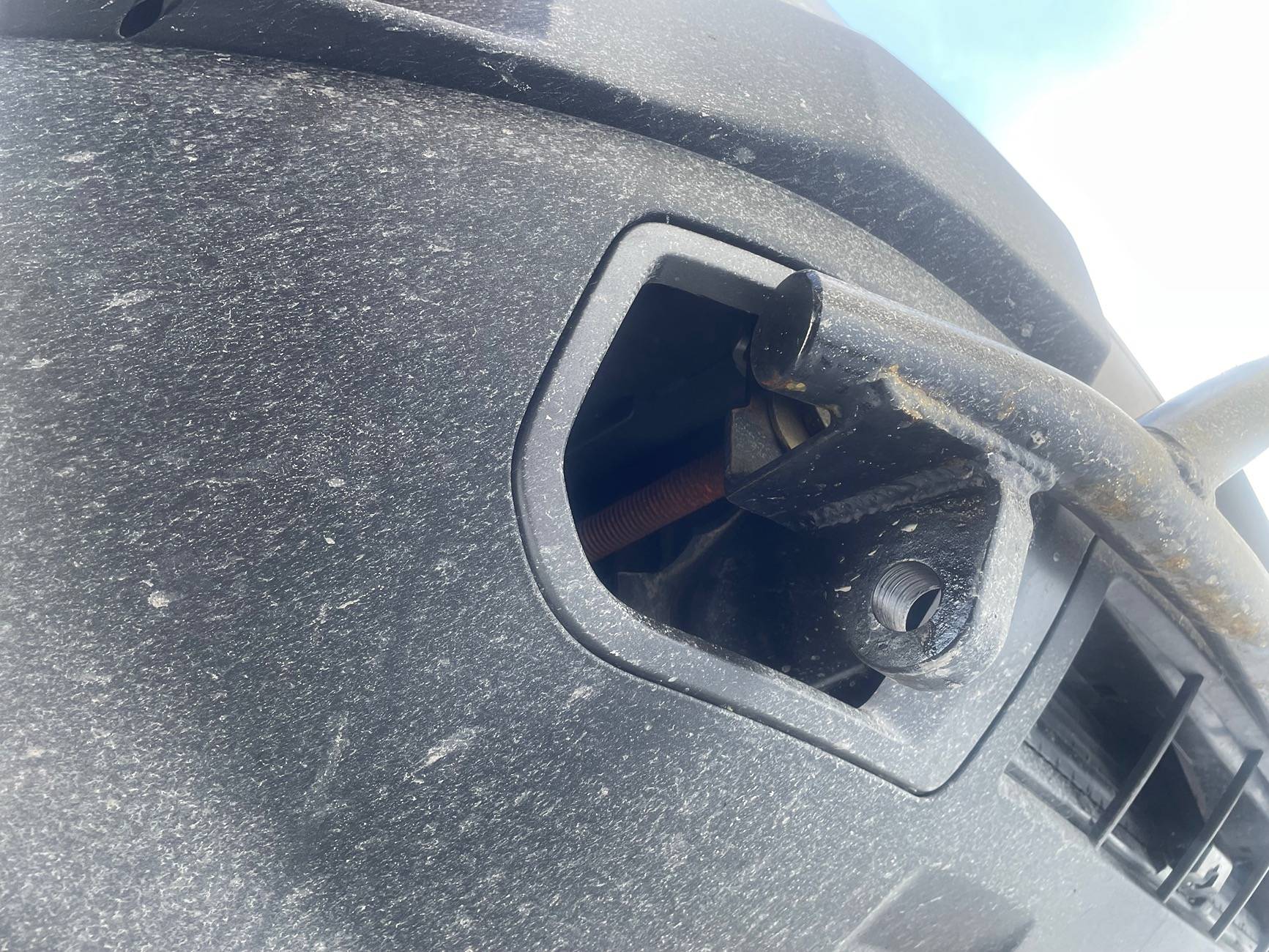

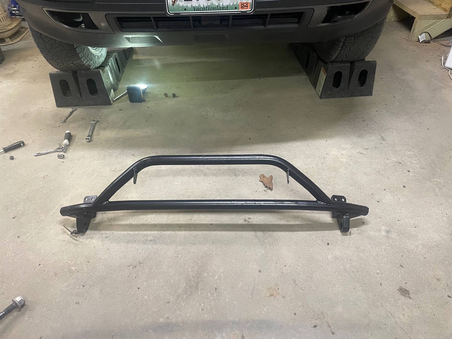

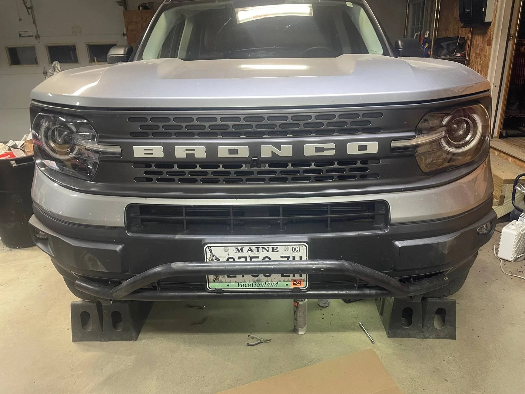

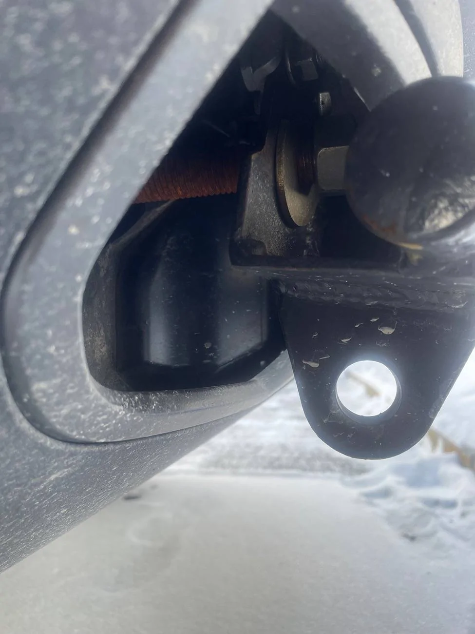

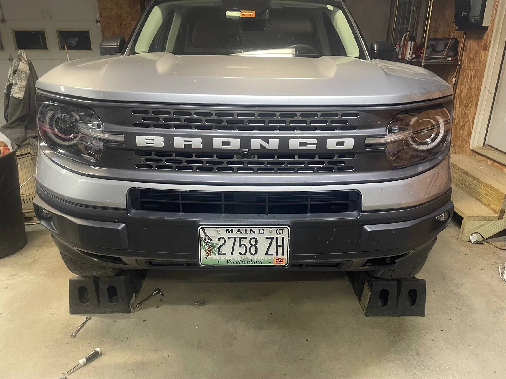

I have the ford ranger lift bar on my 22 Bad lands. It requires removal of the factory fromt Tow hooks and mounts to the front of those brackets ONLY it does not mount to the factory installed recover frame mounts inside the sub frame (about 16 Inches behind the front bumper with a LARGE 3/4 inch nut to transfer tension). While the mounting bracket will hold up a nudge bar or light bar, those brackets are NOT designed for actual recovery as they are fairly thin. And the FRL design puts stress directly on the 3 3/8th bolts ONLY, I feel that any sort of actual recovery using them Alone would cause damage to vehicle. Recovery might work with the FRL tow points and with a bridle to spread the recovery load but I didn’t feel comfortable with that.
So I had local metal shop bore out the center of the ford ranger lift bracket in line with the factory shaft on the factoey Hole. I then put grade 8 all thread and welded the matching Bolt on front.
The came through the front bored hole through the gap that matches up with the place frame mount area That the factory recovery hooks were mounted. As I understand it ONLY badlands and first editions have The extra reinforcement point for the factory hooks indicating this was intended to
Be used , for recovery and suicidal deer mitigation(I do some Off-roading so I wanted functional and utility ).
the hardest part t to get the large nut at rear mounted, getting wrench turned in the cramped space I could get to was bad, I would recommend a ratcheting box wrench, in appropriate size as actual space to turn was about 2 inches of arc. All in all It was about a 3 hour job from pulling the factory hooks to install of bar.
Also FRL bar arrives in unpainted sand blasted condition. I live in salty New England so I went with black gun kote. So far so good but it has only been 2
Months
before and after photos, I didn’t get any of
The hole I had bored at metal shop. Also I don’t get any of install.

And here is a photo of the “secure to frame” all thread and , forgive Bad angle. It’s cold out.
Also I can use front crawl camera with no issues
