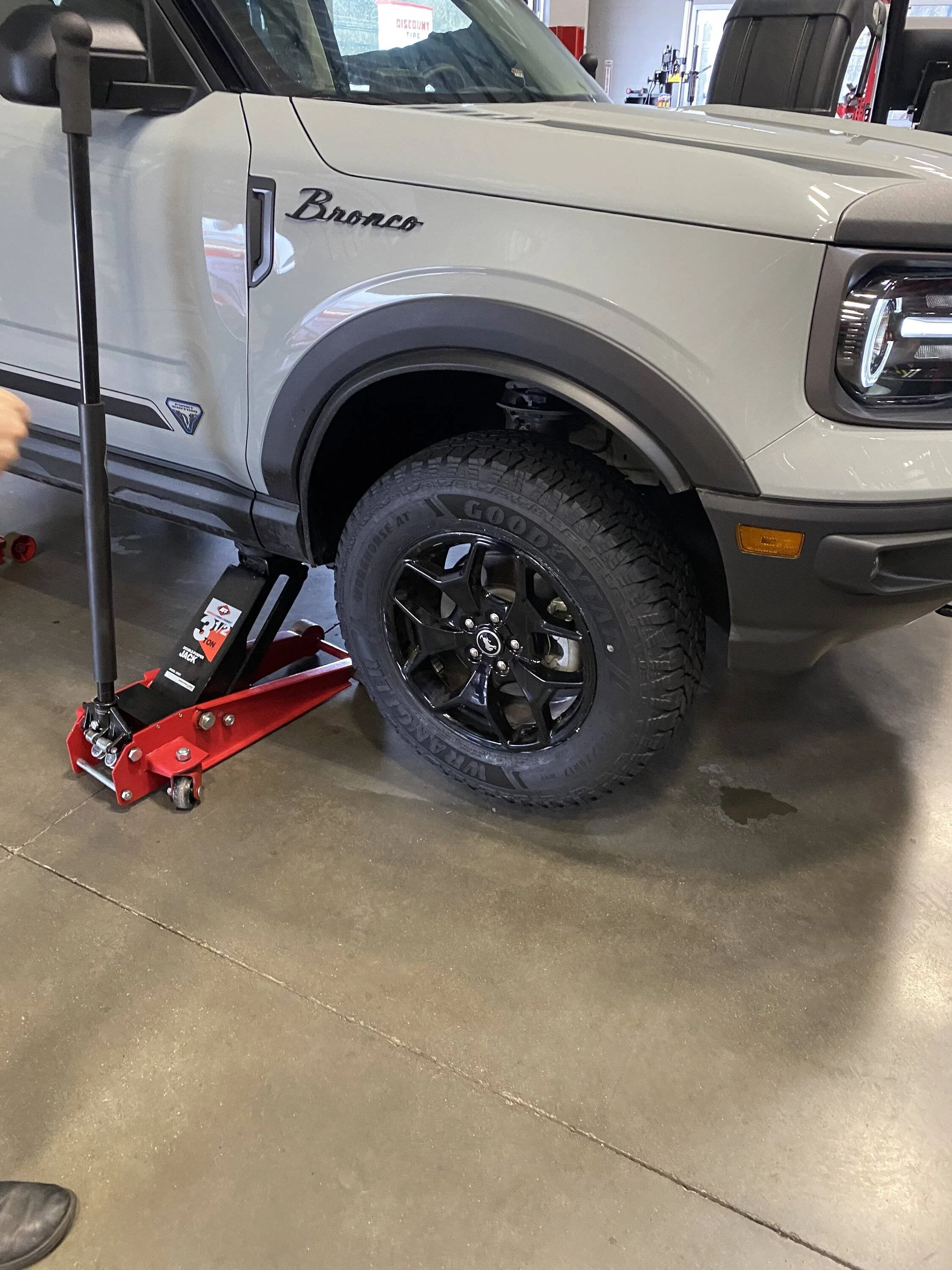

Iam a first edition badlands owner 10 months ago I had 235/70/17 Goodyear wrangler at 30 inch fits perfect, no lift needed, I do no off road driving.
Ford Bronco Sport BS Badlands Lift kit IMG_1199
In that pic those tires look too big, even though you don't offroad they will rub at some point, awfully close to the backside of the front wheelwell.

The rear of the front tire looks quite tight on that photo. But you are the second person going with that size, an vouching for a no rub fit... thanks for sharing!

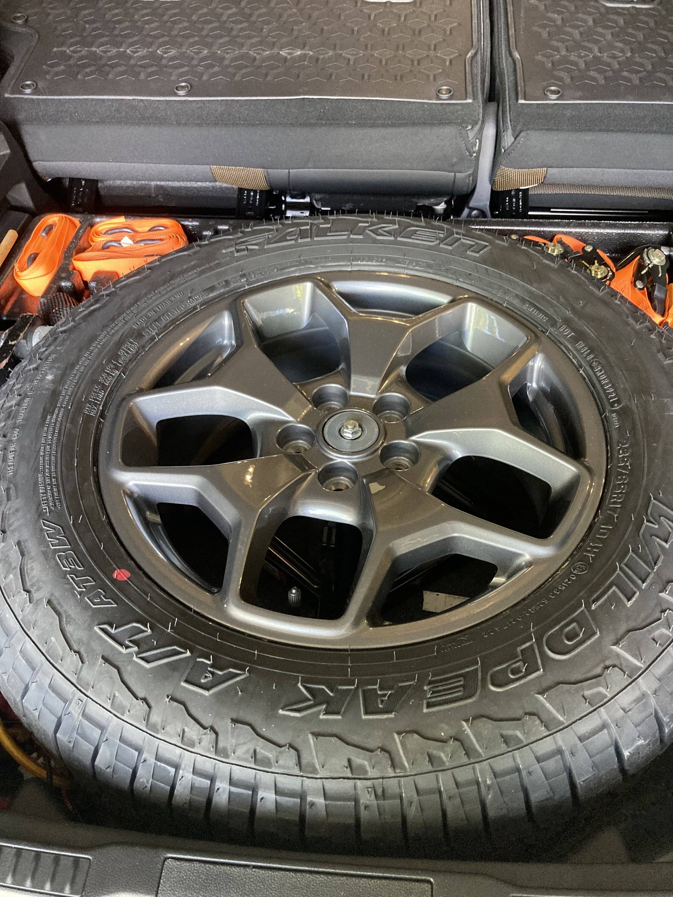

The OE Falken WildPeaks 235/65-17R are relatively low noise and a great ride in my opinion. Not terribly aggressive looking if that’s what you are after. Spare fits in the well with no modification too.
