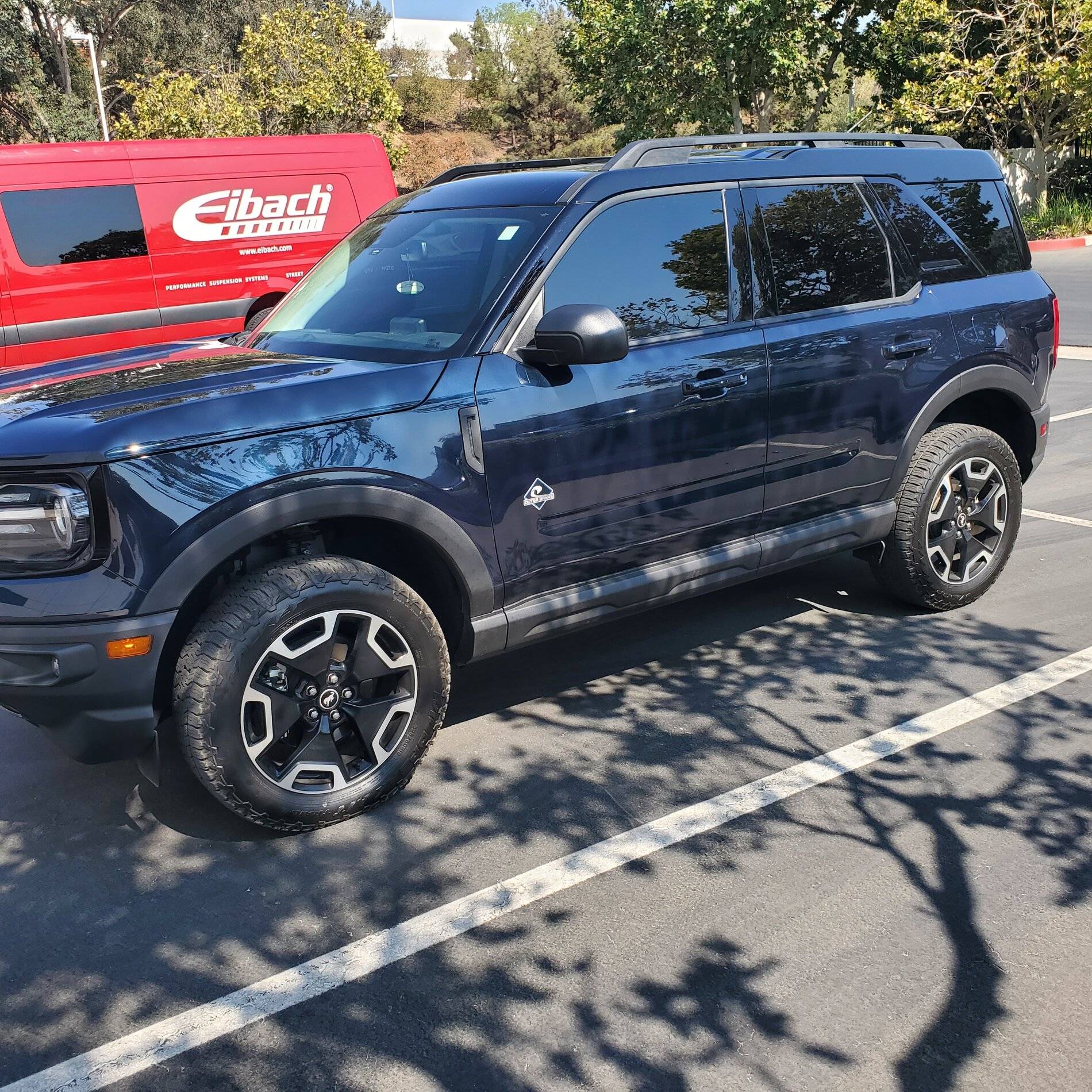

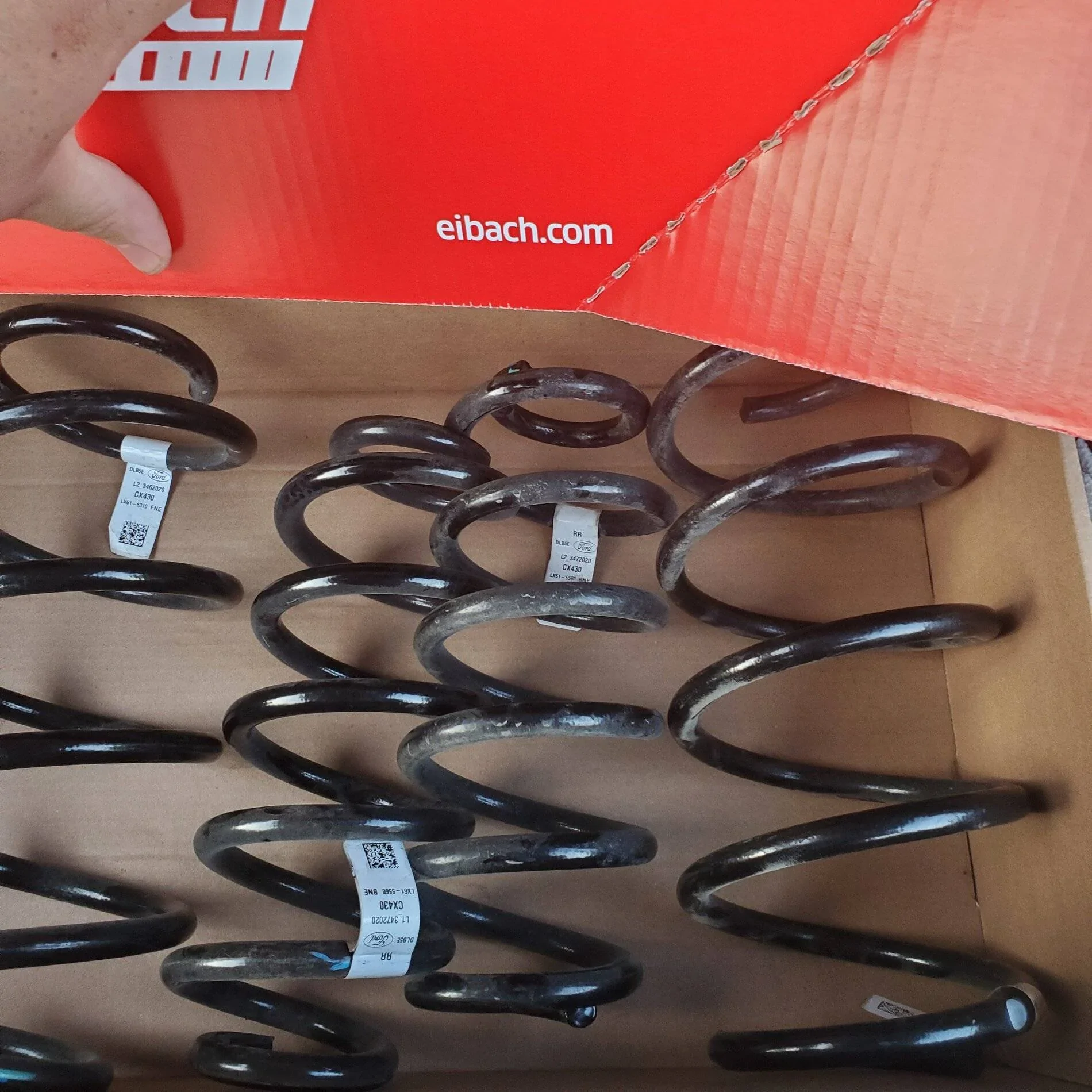

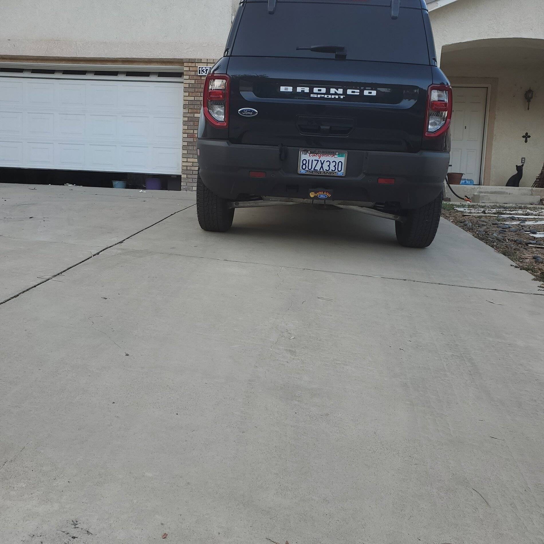

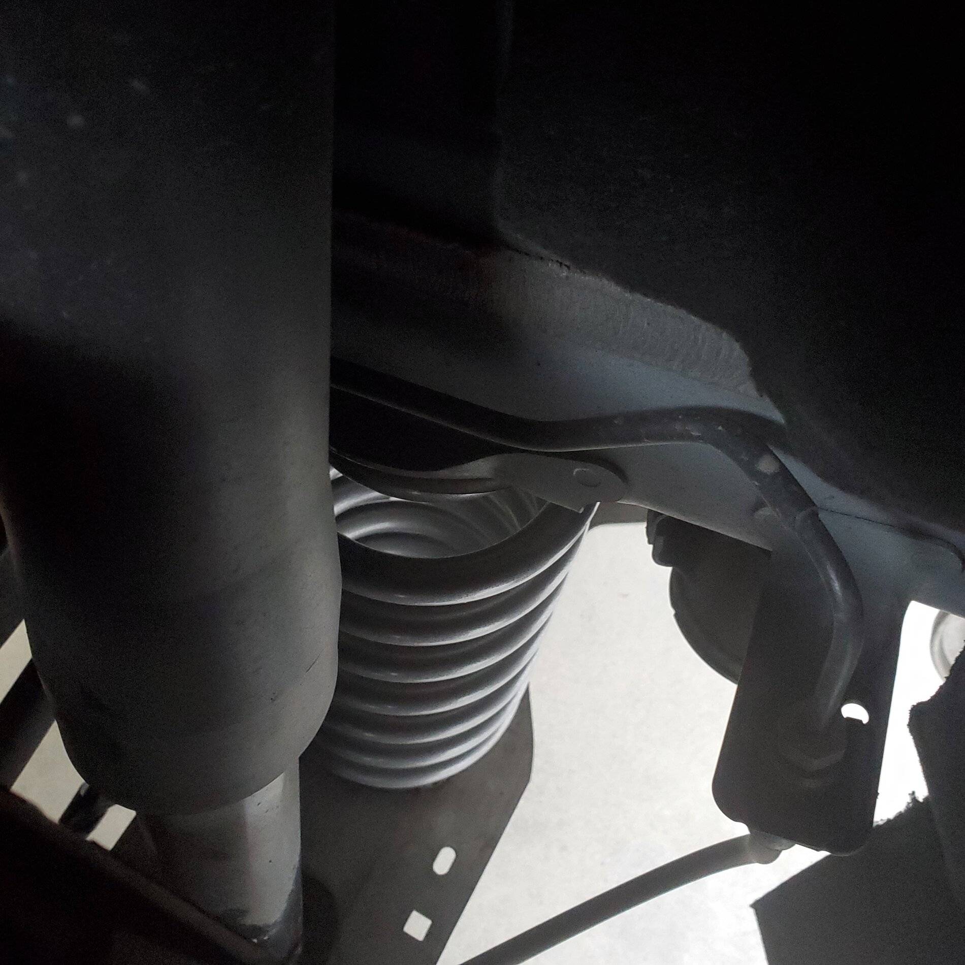

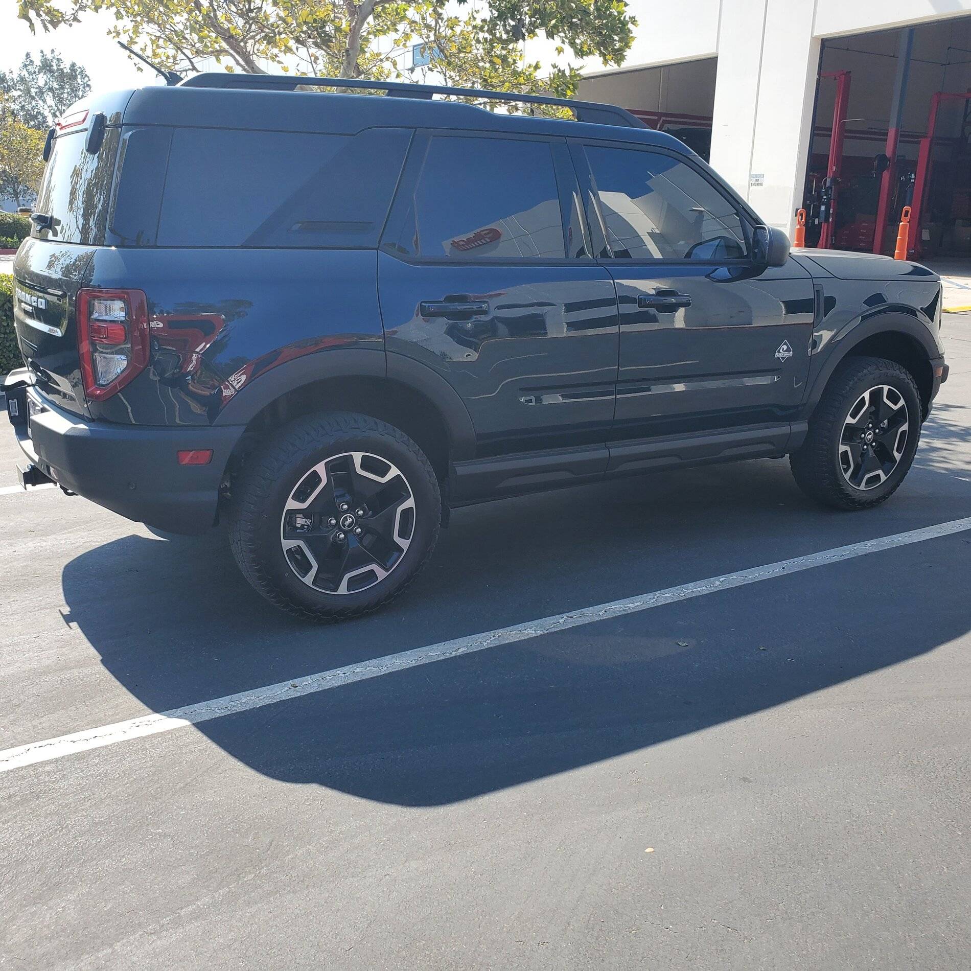

So back in March, in a bronco sport facebook group, a rep from Eibach posted asking if anyone wanted to bring their bronco to their corona California location for a prototype lift kit. Me living in corona, I jumped on it. In March they had it 2 days for measuring and one day, today for install and ride test. They were able to get 2 inches in lift. This is an actual suspension lift and not spacers. I'm super happy with the look and extra clearance I have now. Especially from a reputable company like Eibach

How are the springs? Are they stiff or soft compared to the oem Ford springs?

My 1st thought is how does that lift affect the articulation of the suspension. Extention and compression are equally important.
With those springs the suspension must be close to being topped out, and possibly will not allow much drop if a wheel were to go into a hole or when going up a slippery hill there will not be as much weight on the front end to help provide traction.
Geometry wise, It's probably not quite doable to have longer struts or shocks for the Bronco Sport like Eibach does with the Ranger lift.
It all depends what your needs are and will be interesting to hear your review after you put on some miles.

ride IS louder for sure, but im playing music constantly so i never notice. any unexpected bump or pothole is louder too, but it takes a lot more to be noticed than the regular springs. it was free due to it being a prototype
