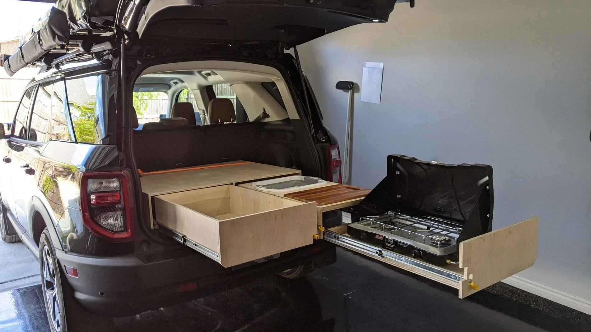

That looks great! What’s your plans for finishing touches paint and the stick on edging to cover the exposed plywood?
It's going to be painted with a black satin polyshade paint and the edge covered with neoprene rubber trim. The top will have countertop laminate. I will post update photos

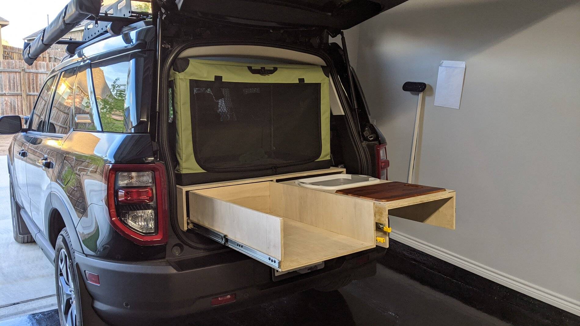

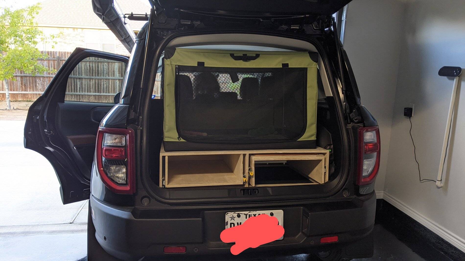

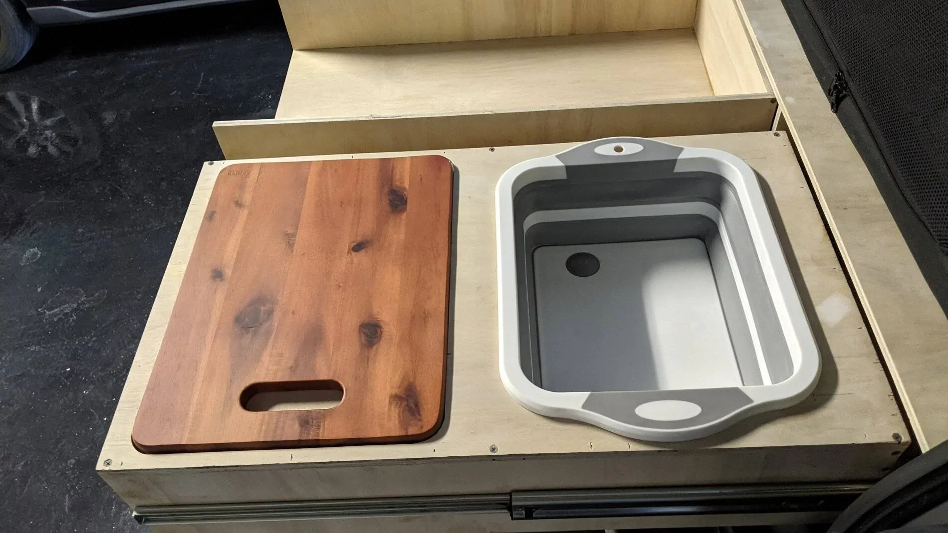

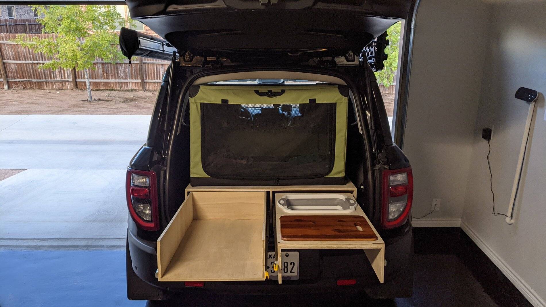

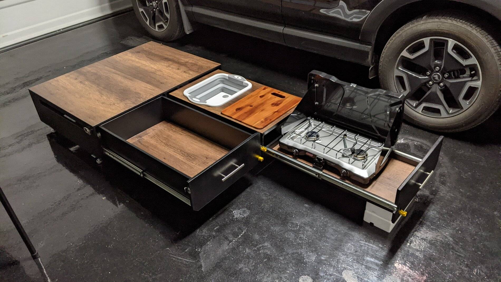

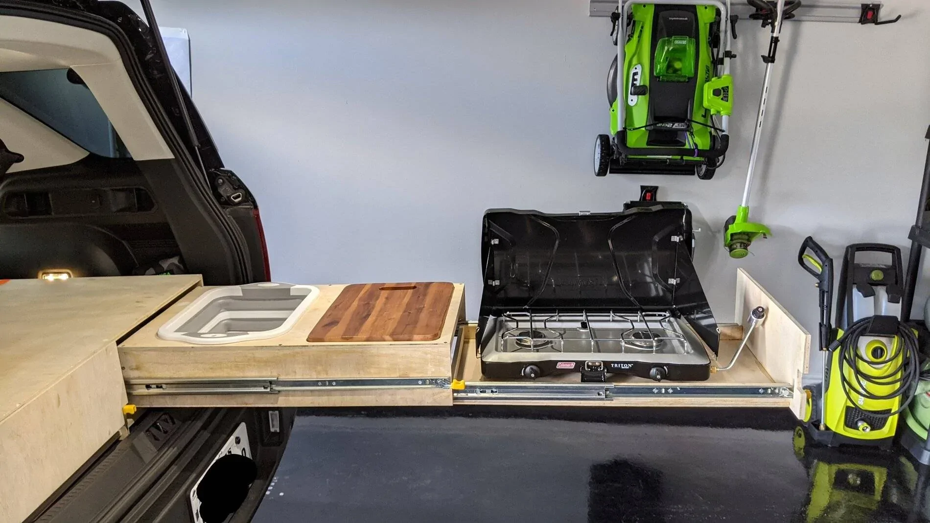

Update:
Here are updated photos of the finished build just painting left to do.
Ford Bronco Sport Bronco Sport camp kitchen build PXL_20211024_203153371~2
Ford Bronco Sport Bronco Sport camp kitchen build PXL_20211024_201247875
You might want to put some thermal insulation / fireproofing on the areas facing towards the stove when deployed in operational configuration. Something like grade 1401 millboard to reduce thermal transfer would work.

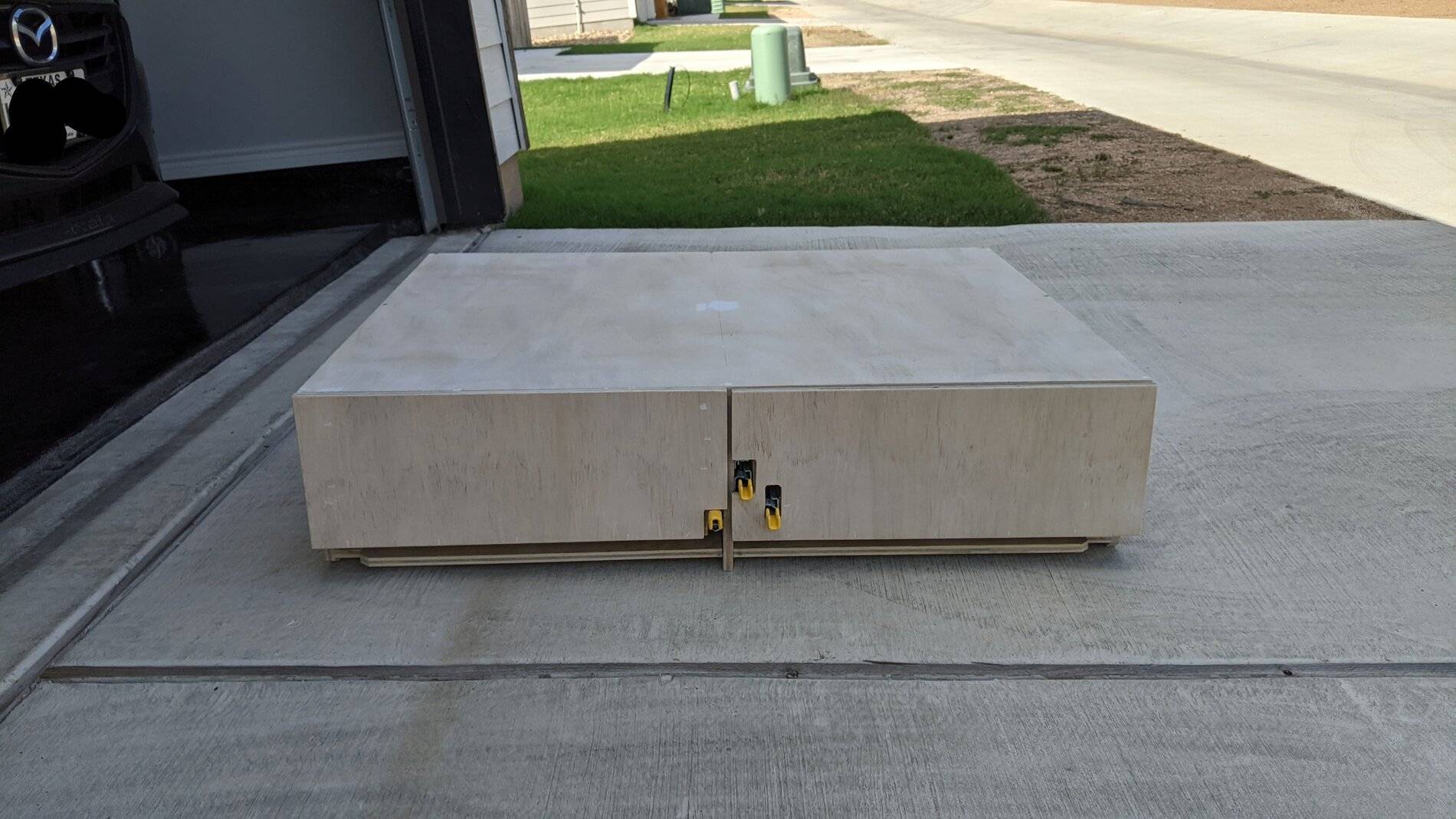

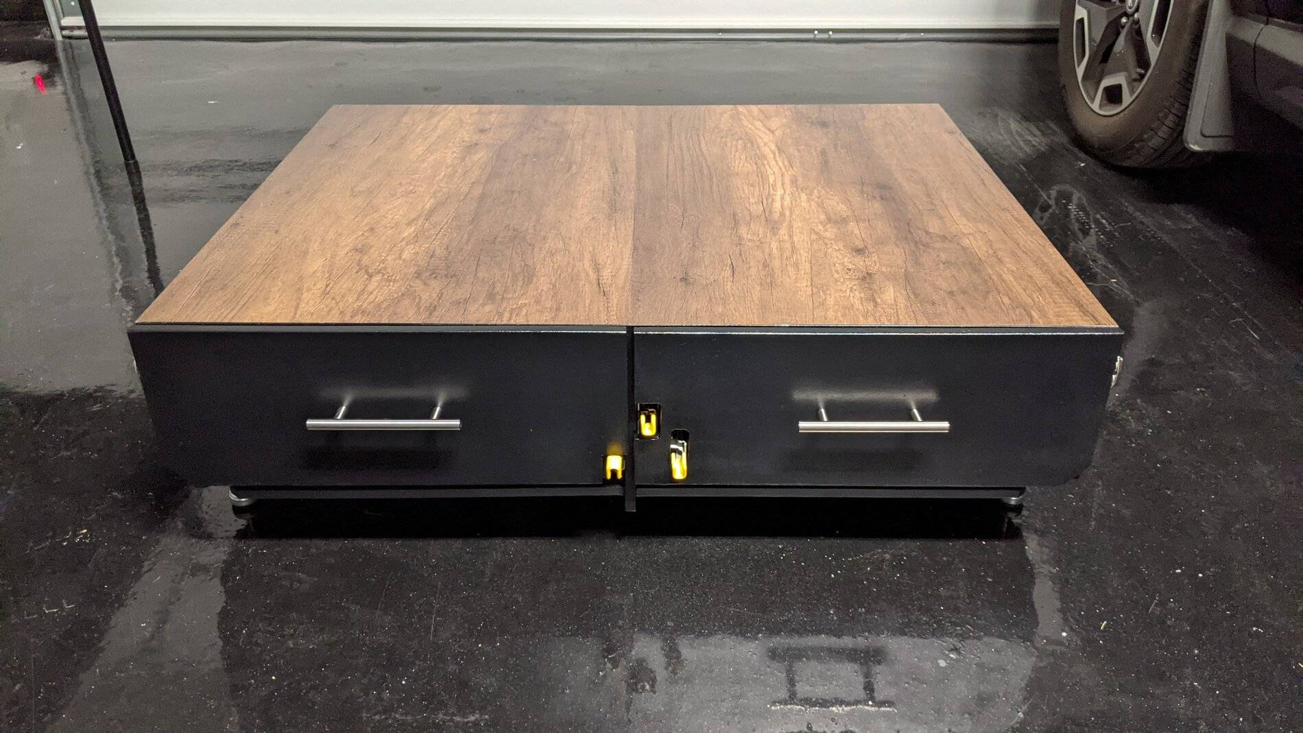

I see you have it held down with a ratchet strap, any further thoughts on how to keep the box in place? I’m thinking of doing something similar but about half as wide. Without a tie-down point in the middle, a strap won’t do much.
Ideally something like cam-locks or lever-locks to the four-corner cargo tie-points would keep it anchored firmly. Skip all the flex and stretch of straps.
