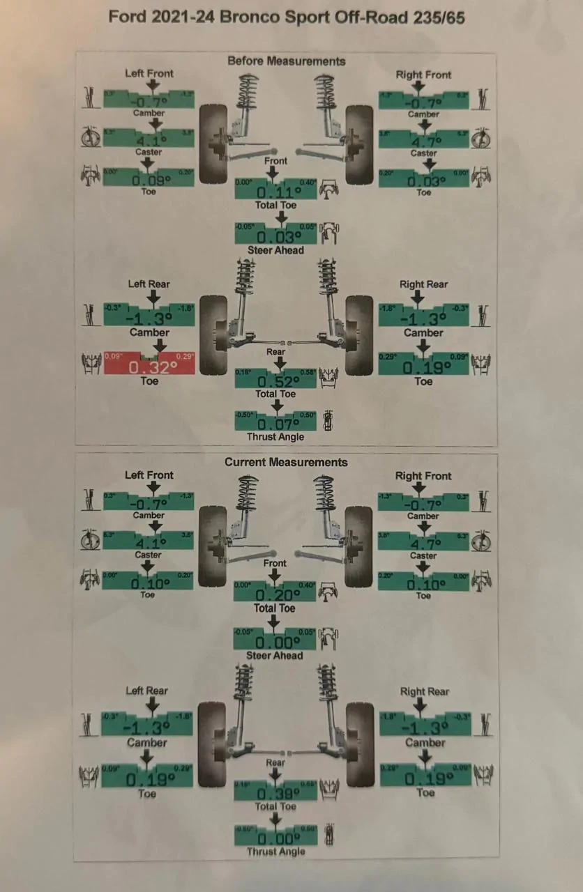

No issues with a recent alignment.
I had a 4 wheel alignment done last week (see pic) on a ‘22 Badlands because one of the factory Pirelli tires had a somewhat different wear pattern than the other 3.
A few weeks before the alignment I had Falken 235 65R17 tires installed.
Here’s the pic of before and after for the alignment (‘22 Badlands ‘22 Badlands).
Front camber before/after and Front caster before/after are no change.
Rear camber also shows no change from before to after.
Dealership should charge less lol as not much work to do for an alignment ?
