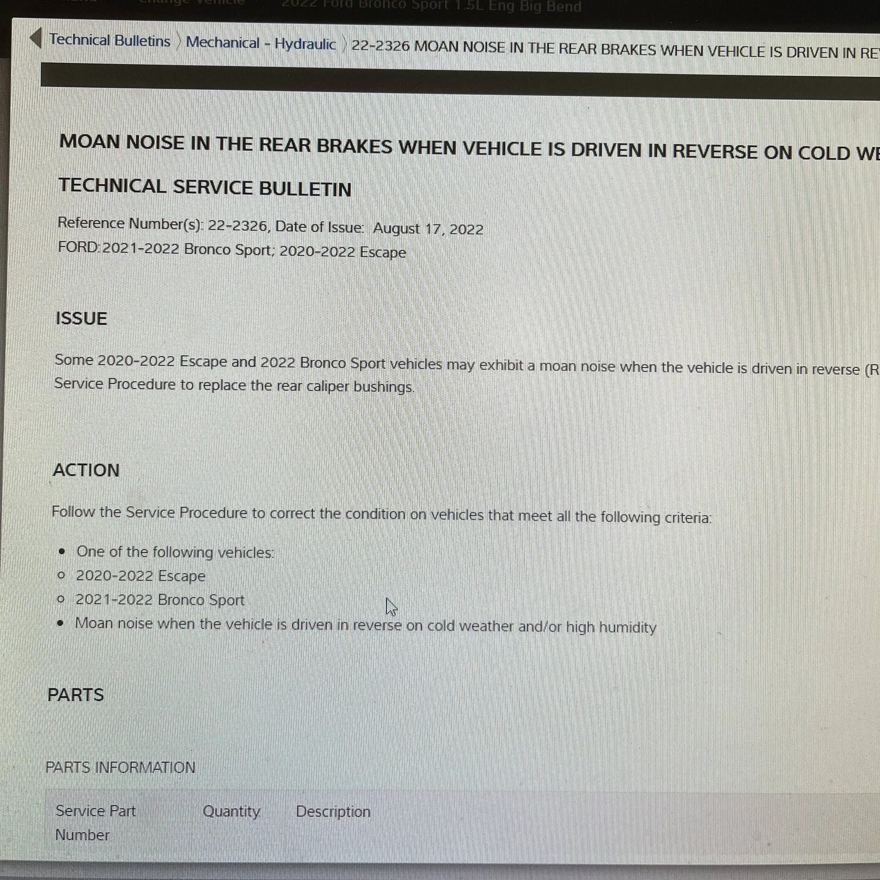

Here is a tsb I found on prodemand for this issues. Scheduled our appointment for the warranty of this is feb(soonest we could get). Sorry for low quality photo. It was a quick lookup and grab off the computer.
Ford Bronco Sport Brake Squeal (in Reverse) B97F1BC8-4DFF-4611-820B-63A4CD0CA6B8
