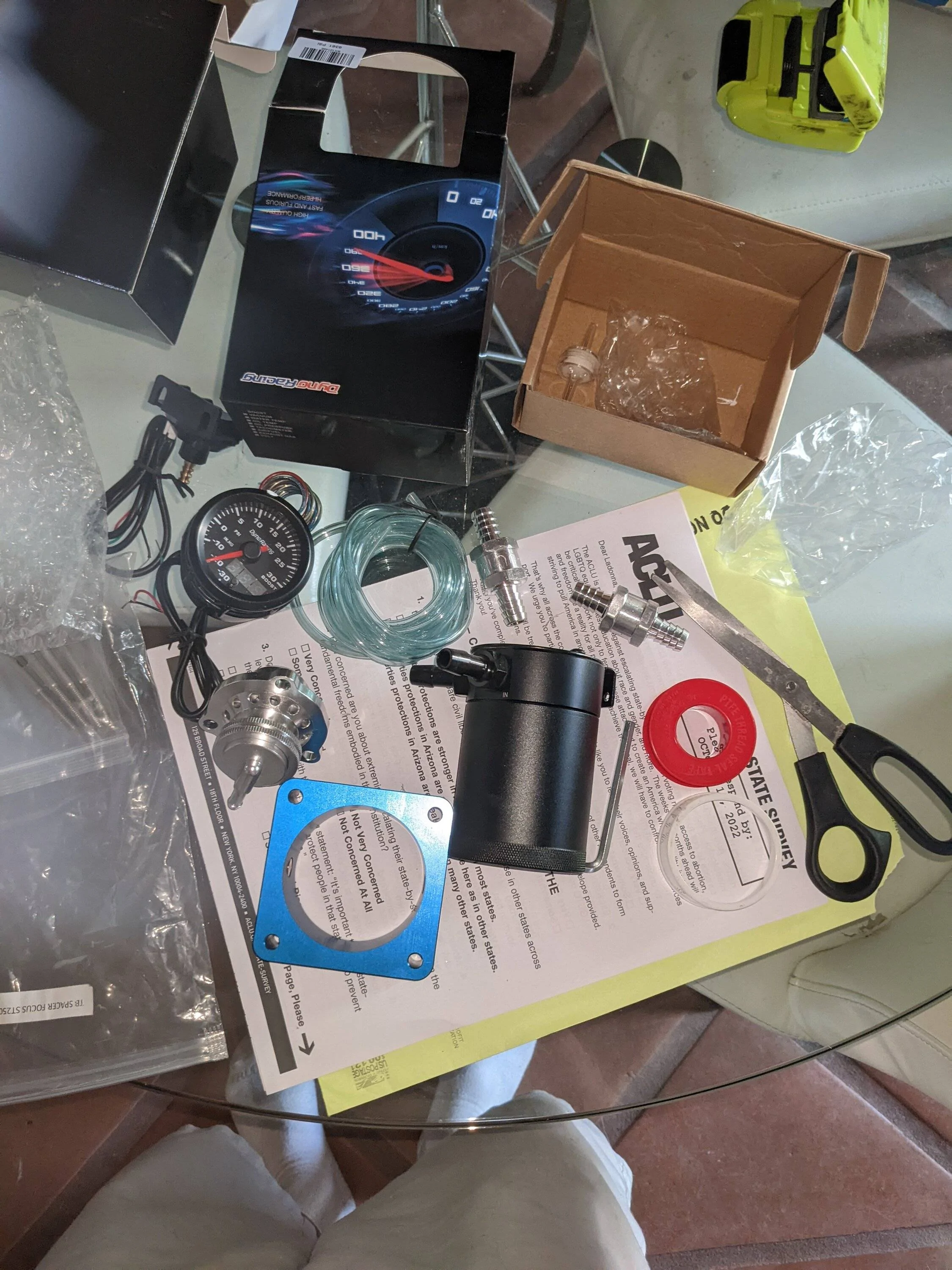

Hello, first thread I've started here and I wanted to do weeks ago but I've been busy with work but with a 3 day weekend and all my parts in I'm gonna try to get my boost gauge, catch can and blowoff valve put in and hopefully explain how in case anyone else wants to do it this way. I'm using basically the same parts I had on my 2014 escape 2.0 so I'm hoping it'll go smooth. I put a pic of the parts. It's a throttle body spacer (useless but for the two ports it gives me to reference vacuum and pressure after the throttle body. It cost like $40, up from the $25 I paid on the escape years back before covid, it's a vacuum/boost gauge by glowshift (I've used them in a number of builds since 2012, all positive experiences for a cheap gauge $33 this time. It's electric comes with sensor, has analog and digital, it's easy to wire up which is saying something cuz I hate doing electrical stuff, and it changes 7 colors so I can match my MyFord color thingy in the BS (that's what I call mine cuz the price was BS) also two check valves which cost $14 for both and an old eBay catch can I got years ago for about $25 and forgot about (I've used the $150+ ones and these are 9/10 as good as long as you do the hose right that's what's really different) and the blowoff valve is for a focus rs (the spacer ones didn't fit right on my escape 2.0) was $24. Only things I still need I can get at AutoZone down the road which are an addal a fuse which I prefer to use when doing stuff like that is and some hose for the catch can which I usually just use cheap heater cuz it's always worked in the past just make sure not to use qormgear clamps use the solid flat ones, I'll put a pic of on in case I'm not explaining it well but it helps to prevent cutting into the hose or the hose moving to the cuts the worm gear turns in.

I'm about 2 hours in and my blowoff valve that I used on my 2014 escape 2.0 won't fit it's too deep and the bolt flange is just barely different. Ordered an adapter for the full size broncos and seems like that will work got it for $33 supposed to be here next week but that at least is fairly easy to get to don't have to remove anything. The intake manifold is a huge pain in the ass and still not off there's one big part of the wire harness on the way and I had to remove the egr and intake tube And tons of vacuum lines and wires that have those terrible plastic holders you just had to rip out basically. Also the rubber boot of the intake piping to the throttle body is pain to get to one ac line runs right in front of it along with some vacuum lines I'm thinking about deleting all of them cuz I can't see any neees for them except the ocv and my catch can setup will take it's place and be better. Also have lost two one socket one ratchet two bolts and a screwdriver and it's the Badlands so in addition to the plastic belly pan I usually just throw away on all my cars I have to get past the skid plate I will definitely keep so I assume they will all fall on me when I remove that to do my first oil change this weekend as well. I still love the car but for working on it it gets a big old negative 1000 on a scale of 1-10 so far. Also the intake valves are already looking bad so whatever Ford said they did to prevent that for a direct injection engine doesn't work or not enough I still don't get why they didn't do dual fuel with port and direct injection on this one too when so many other for engines have it. Seems like Ford typically cost cutting in the wrong areas that ruins what should be a great product with no negatives. Unfortunately. Not surprised at all they been doing it for as long as I've had fords. I would like to speak with the engineer who designed the engine bay layout well not speak more like punch in the face and then make them work on their own car and see how they like it. Anyways my phone camera is down. But I'll try to find a way to post pics and a video.
