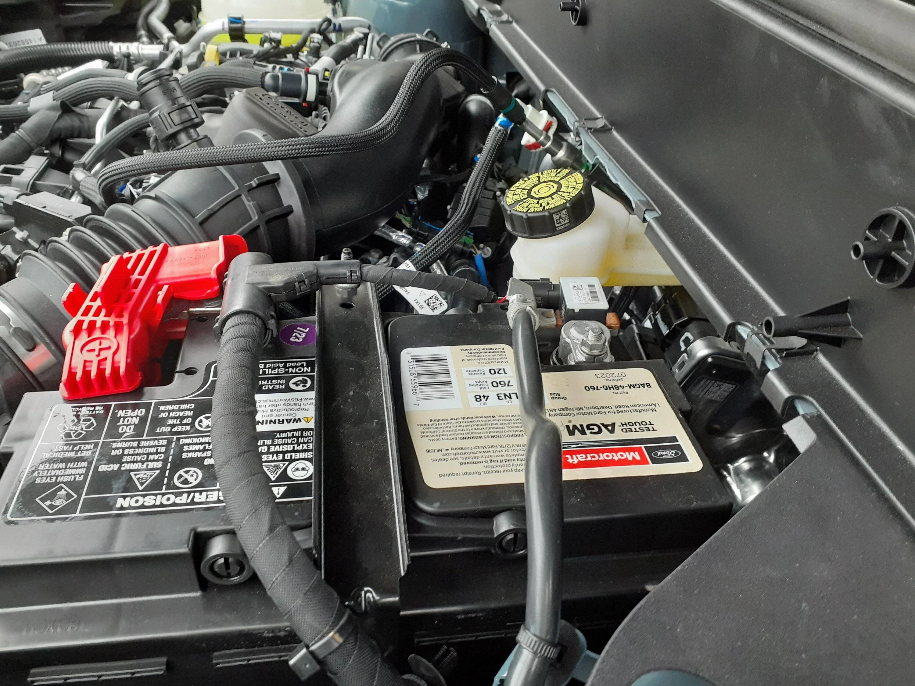

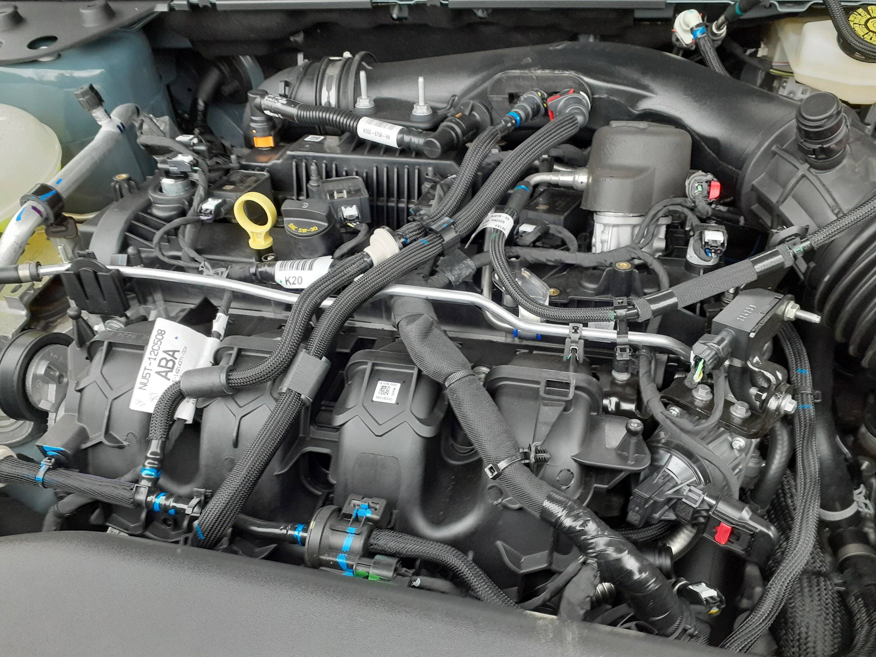

well I did a sound recording and took 2 photos, 1 of the engine and the other the replacement battery.
It seems I can't post a voice recording of the engine noise, it won't allow the the m4a extension.
I'll try something different.
Ford Bronco Sport Bronco Sport Badlands 2.0 Eco-Boost engine and deep sleep mode 20231122_154314 Ford Battery
Ford Bronco Sport Bronco Sport Badlands 2.0 Eco-Boost engine and deep sleep mode 20231122_154327 2L turbo Eco-Boost
