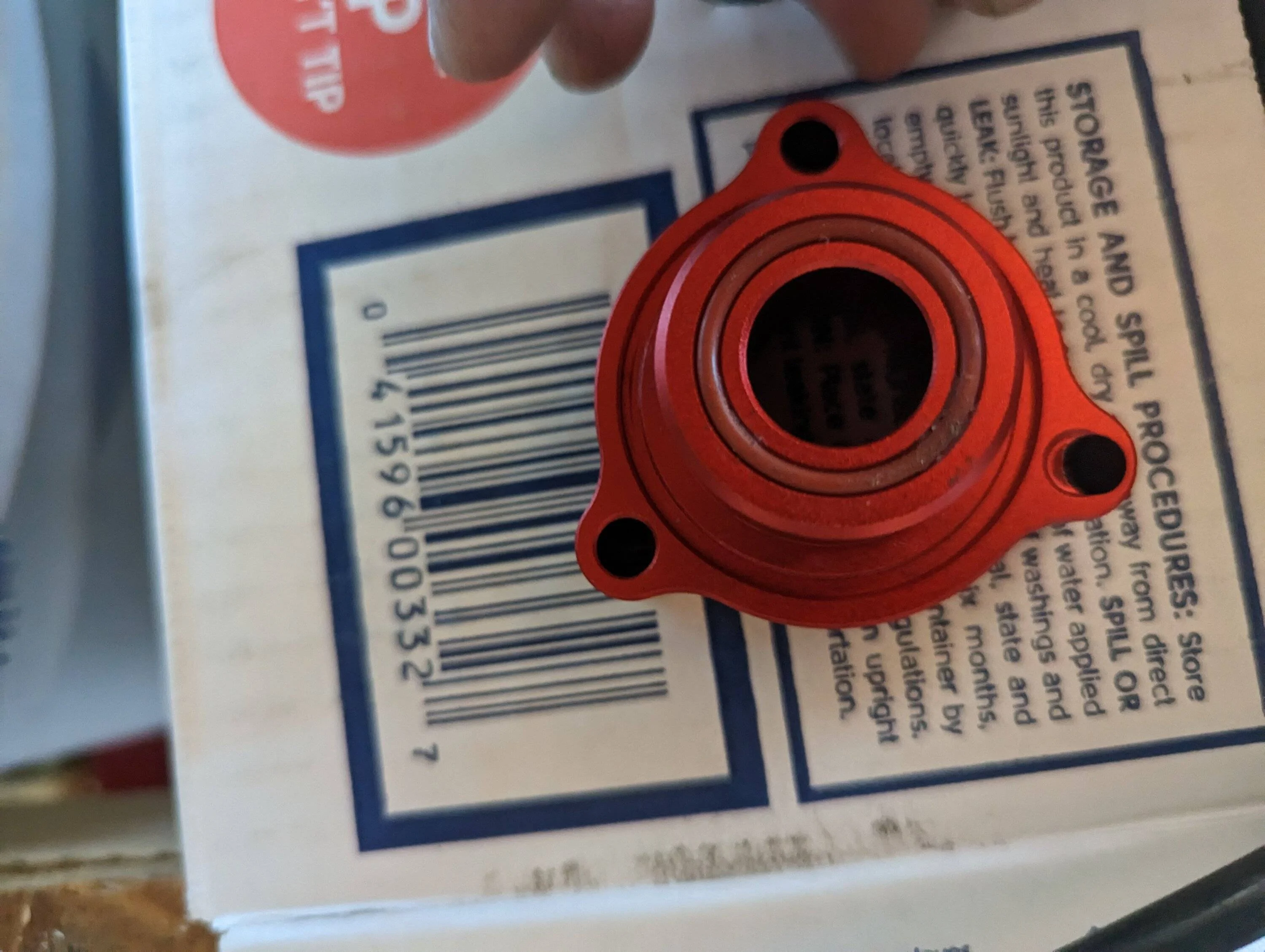

I've been busy with work but I did get to do a little bit of stuff this week. I got my adapter for the blow off valve but they didn't drill the holes in the right spot. The one that's off you can even see where they made an indent of where they were supposed to drill and then how they drilled like an eighth of an inch off.
I didn't want to have to deal with returning it waiting like a week for the new one to come in. So I used my drill press. I was able to just drill out the hole to where it was supposed to be and it seems like it should work. I'll be putting it on later but when you order these parts make sure that you give them a good look over because while this one doesn't take much to put on it's still sucked and cost me like 10 minutes when I realize it wouldn't fit after fiddling with it for a while.
Hopefully you can see the indent where they were supposed to drill and how they drilled too far outside and then you can see where I just took my drill press and drilled down from where the indent was to expand it so that the bolt should fit now.
And when I put this on I'll also be putting on my catch can which will include the outlet of where I'm going to reference boost for the gauge. So hopefully soon the whole point of this thread will be shown of how I do the gauge.

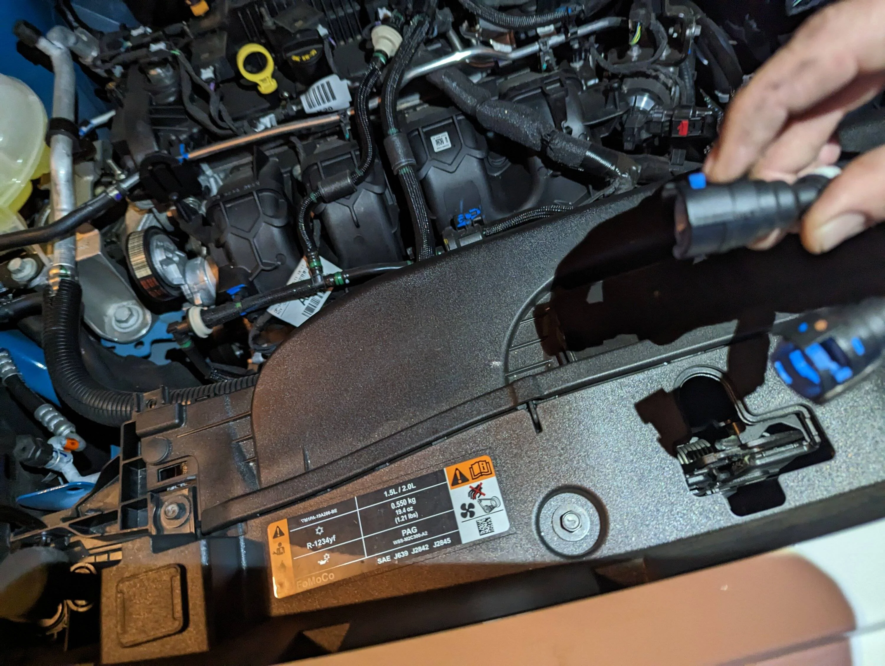

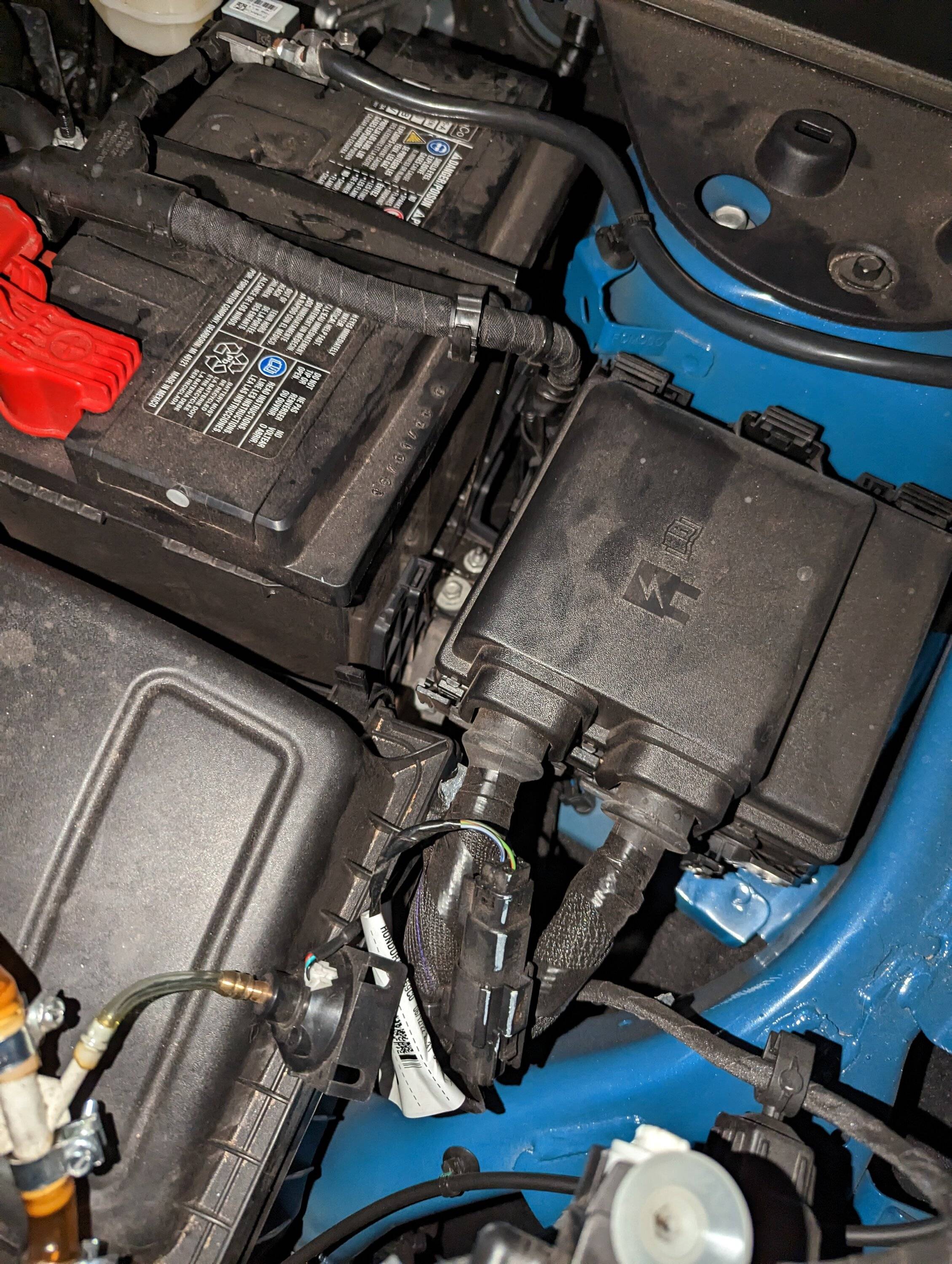

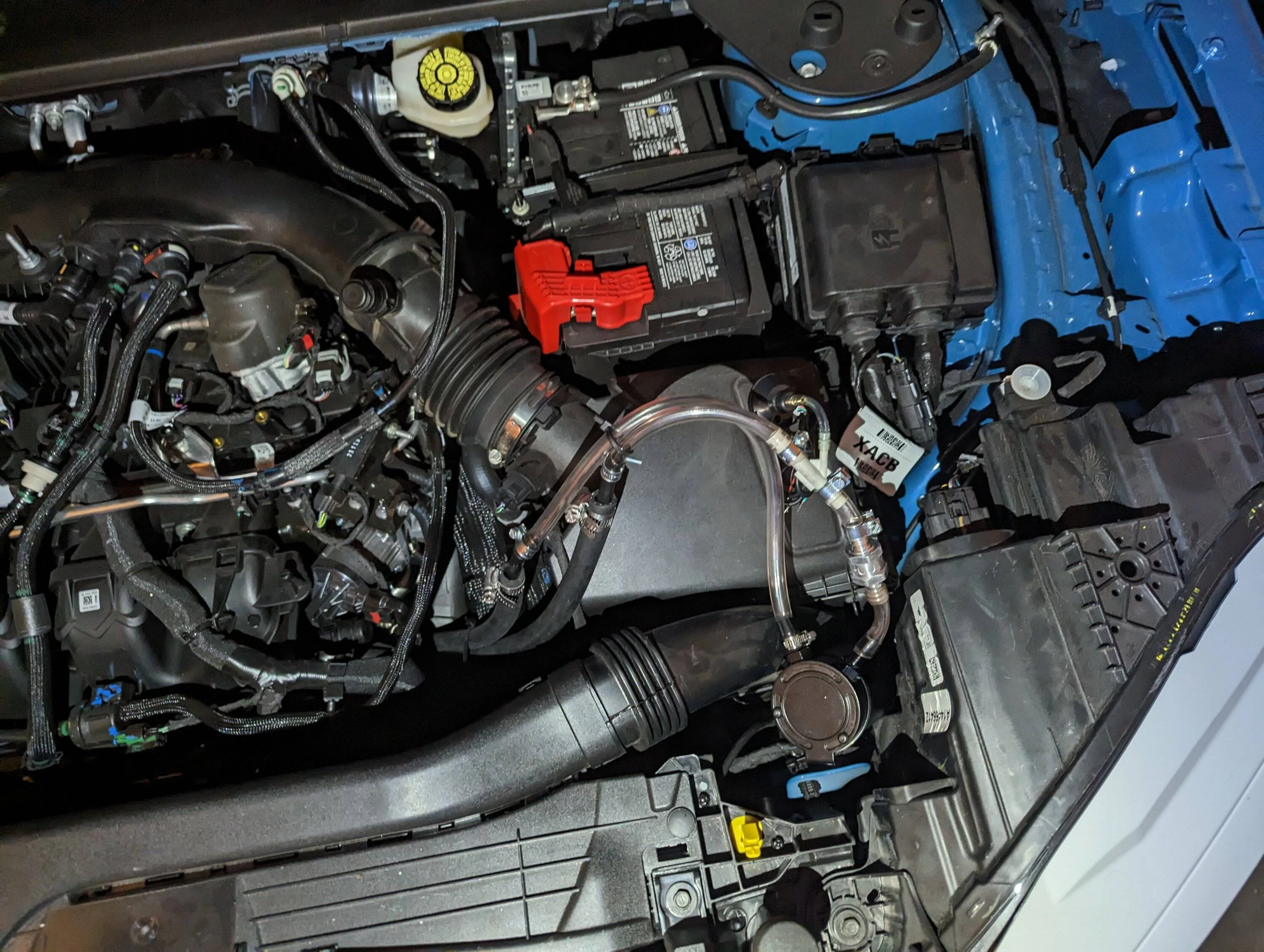

So I finished my catch can routing. There are some different sizes hoses and I left them extra long in case I don't like where can is now but I wanted to put a pic of the stock PCV hose cuz it seems like a huge pain and I even pulled the intake manifold completely off on my 22 Badlands to get to it but you can easily reach it and take it off with one hand.
You can see me pointing to the blue part in the 2nd pic. You basically just got to get your finger and push that clockwise or to the side and that'll open it up so it's slides over the lip where the hose connects to. You need to do that for the one on the back of the intake manifold and there's one like an inch to the right of it. That's on the back of the block that goes to the PCV valve.
You might have to do some feeling around but you want to start in that kind of opening to the right of the intake manifold and you're going to reach under that metal EGR pipe that you see and kind of go under it and then raise your hand up again a little bit and you'll feel the hose and just follow the hose to the connectors and push the tab on each of them to the right and they'll slide off as you pull back.
The first picture is the catch can hose routing and it looks kind of crappy because first there's black heater hose and then it goes to clear plastic hose and there's all those clamps but leaving it like this lets me move the catch can around if I don't like the position it's in right now and then eventually i'll cut it down shorter and make it look better once I know where I'm keeping it.
You can also see there's a tee fitting. Well it's really the shape is a y and that's going to go to where my boost gauge sensor is that references the boost or vacuum. And if you're doing a catch can

yourself, the hose you want is 5/8. So you want to make sure that the nipples going to your catch can or 5/8 mine or smaller. I think they're 3/8 and that's why I have two different types of hose but I only did that because I got this catch can for another car. So just make sure that your catch can has 5/8 nipples on it to connect the hose and it should only have to have two hoses. And then you'll want to put a check valve between the intake manifold and the inlet of the catch can because you don't want boost blowning in there.

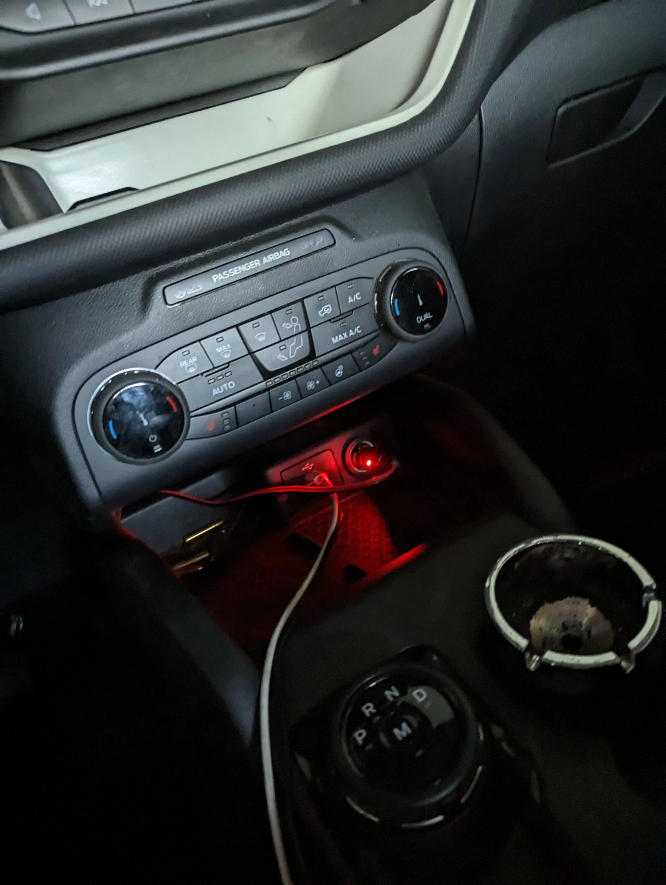

So with the warning light scare when I was trying to take out fuses and use the add a fuse power source, I've decided to just use a 12-volt adapter that plugs into the cigarette lighter under the AC controls and use that for the power and the ground. And I mounted the boost gauge with some double-sided tape that the gauge pod came with. You can see in the picture.
Since my trip to Yellowstone's coming up soon I'm just kind of tuck and wires away for now. I'm trying to be real careful not break anything but these interior parts just don't want to come off. So I'm just going to route the wires outside for now but I'll at least hopefully by the end of Friday be able to get everything wired up and powered on and I can do a short video for y'all and we can see what it shows the max boost as at least I guess

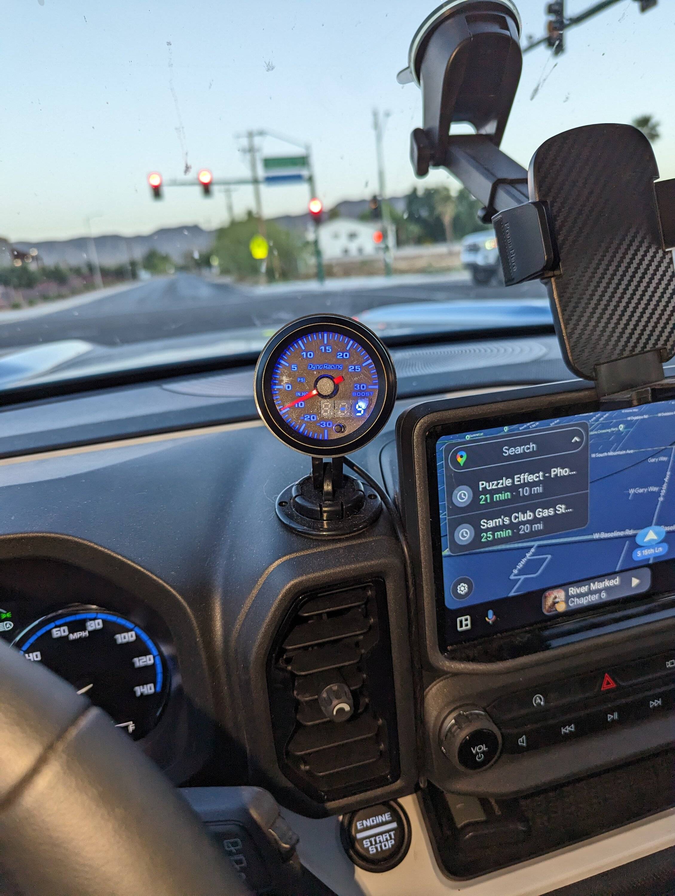

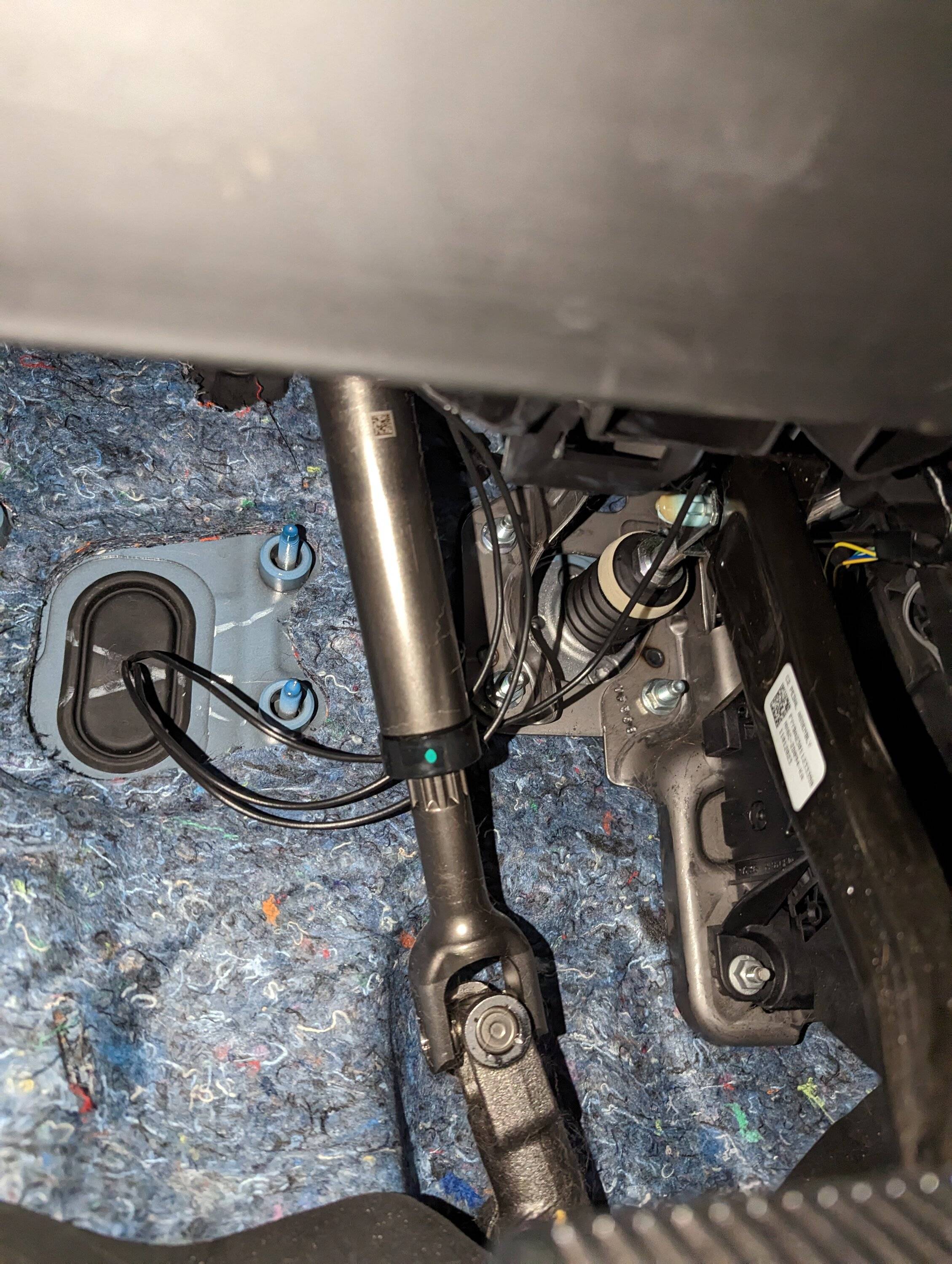

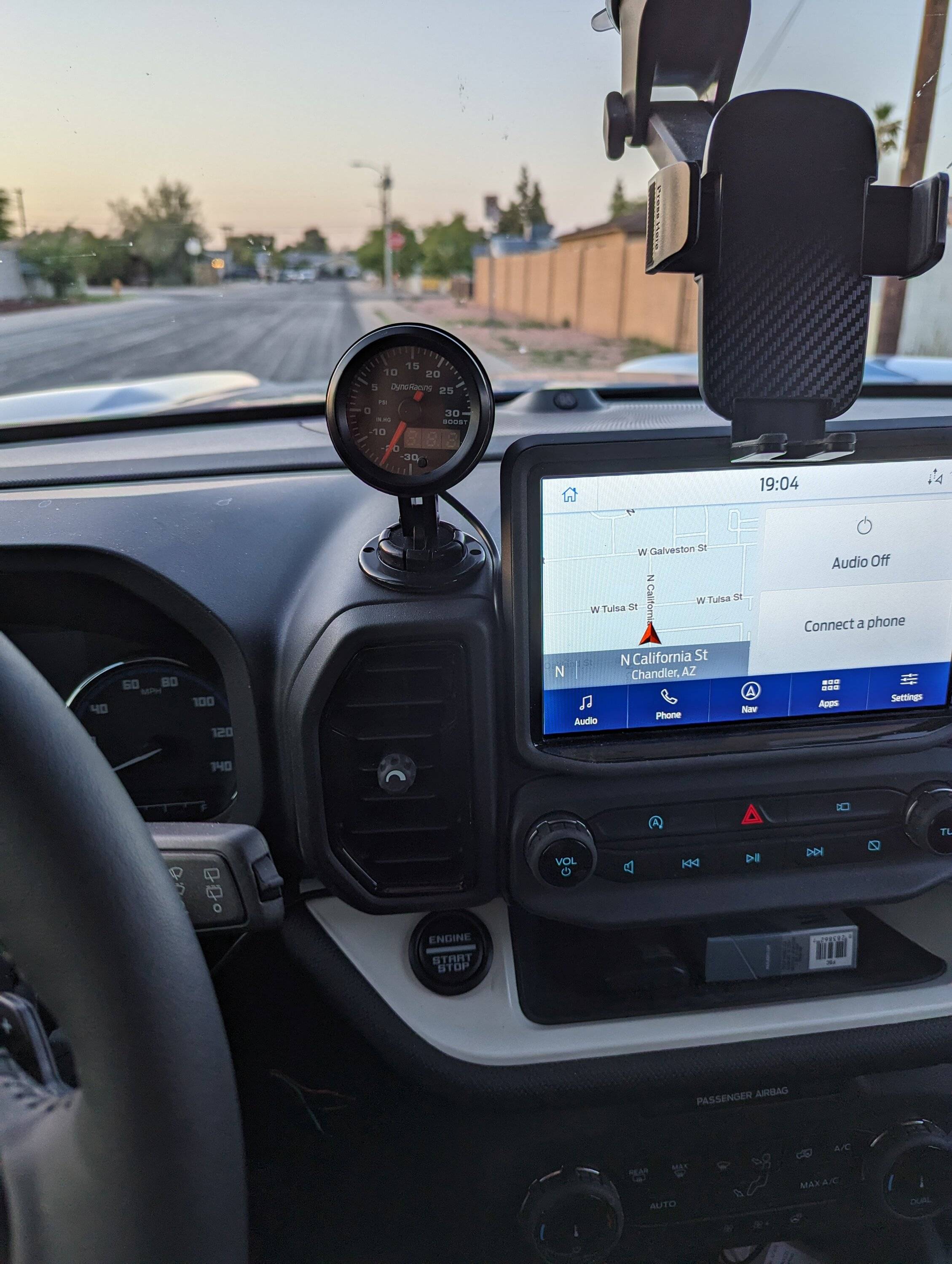

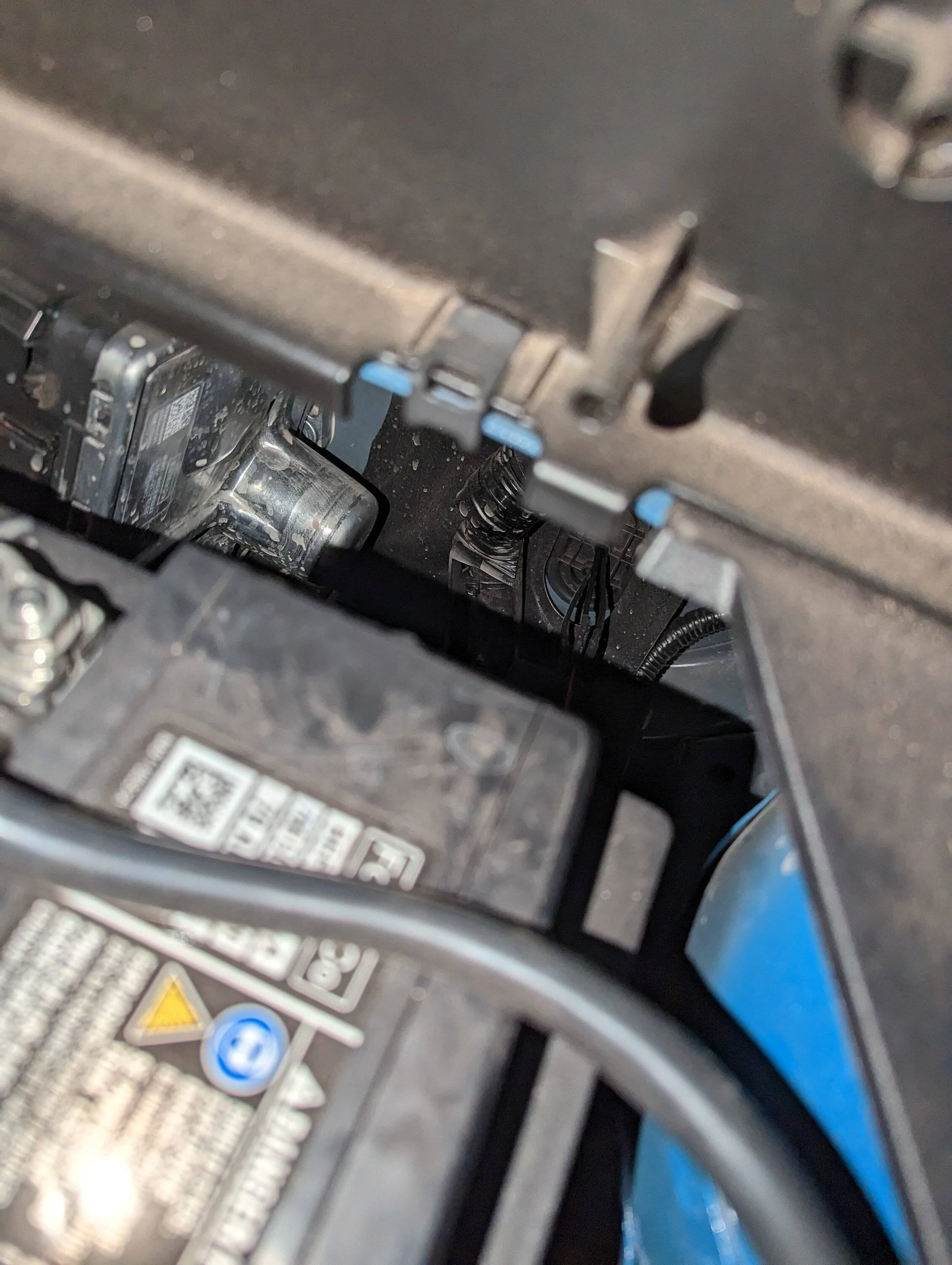

Sorry I haven't posted in a while. I got busy with some stuff but I got the boost gauge done. I'll post a couple pictures where I put the wires and how I got power. It's not up really permanent way with the wires. Really hidden that most peoplr would want, but it's really easy to take off and it doesn't leave any permanent changes to the car and it was just easy. And maybe it'll help people get ideas on how else to do it.
Also, when I was trying to use an add a fuse the fuse diagrams weren't right or there was something else going on because it was messing with some of the systems so I was lazy and I'm just using power from a 12 volt plug-in adapter that goes in the DC outlet by the wireless phone charger So the actual power source isn't like hardwired into anywhere.
Basically I just used a vacuum tee from my catch can before the check valve to reference vacuum and that just goes off of the PVC nipples on the intake manifold and the block behind the manifold and then ran the wires between the battery and the fuse box on the driver side of the engine bay and then through a little rubber grommet that's kind of just below the brake master cylinder and the rubber on the grommet is easy to poke a hole through and it kind of like flexes around the wires so it seals around them without having to do anything extra which is nice and it's pretty easy to get to.
From there I merge the power wires and ground wire that came from the 12 volt outlet by the wireless charger if you have one with the power and ground wire from the sensor that's in the engine bay so they both take power from that 12 volt outlet by the wireless. The data line from the sensor is merged with it's corresponding where that goes to the gauge to read the data from the sensor onto the gauge and it all tucks under the plastic below the steering wheel kind of nice. I haven't zipped tied anything up in case there's issues, but I've driven it and it's worked fine. The readings are a little weird though.
At idle once it's warmed up, I'm getting like 9 to 10 hg and so far Max boost I got was like 28 psi but I didn't stay in it. So I think that's just a spike from flooring. It and downshifting. It seems to want to rest around 15 to 18 whenever I get on it just every time I have a chance to test it. I have to slow down real quick so I haven't been able to really get on it and stay on it whenever I think about doing it. Also, whenever you are just regular driving and just barely getting on it, it seems to want to stay around 7 psi with just a little throttle which is all I've really needed to get around most of the time. Also, whenever you are accelerating decently it really jumps around and I think that's just from the transmission shifting. And you know it's an 8 speed so it shifts a lot.
