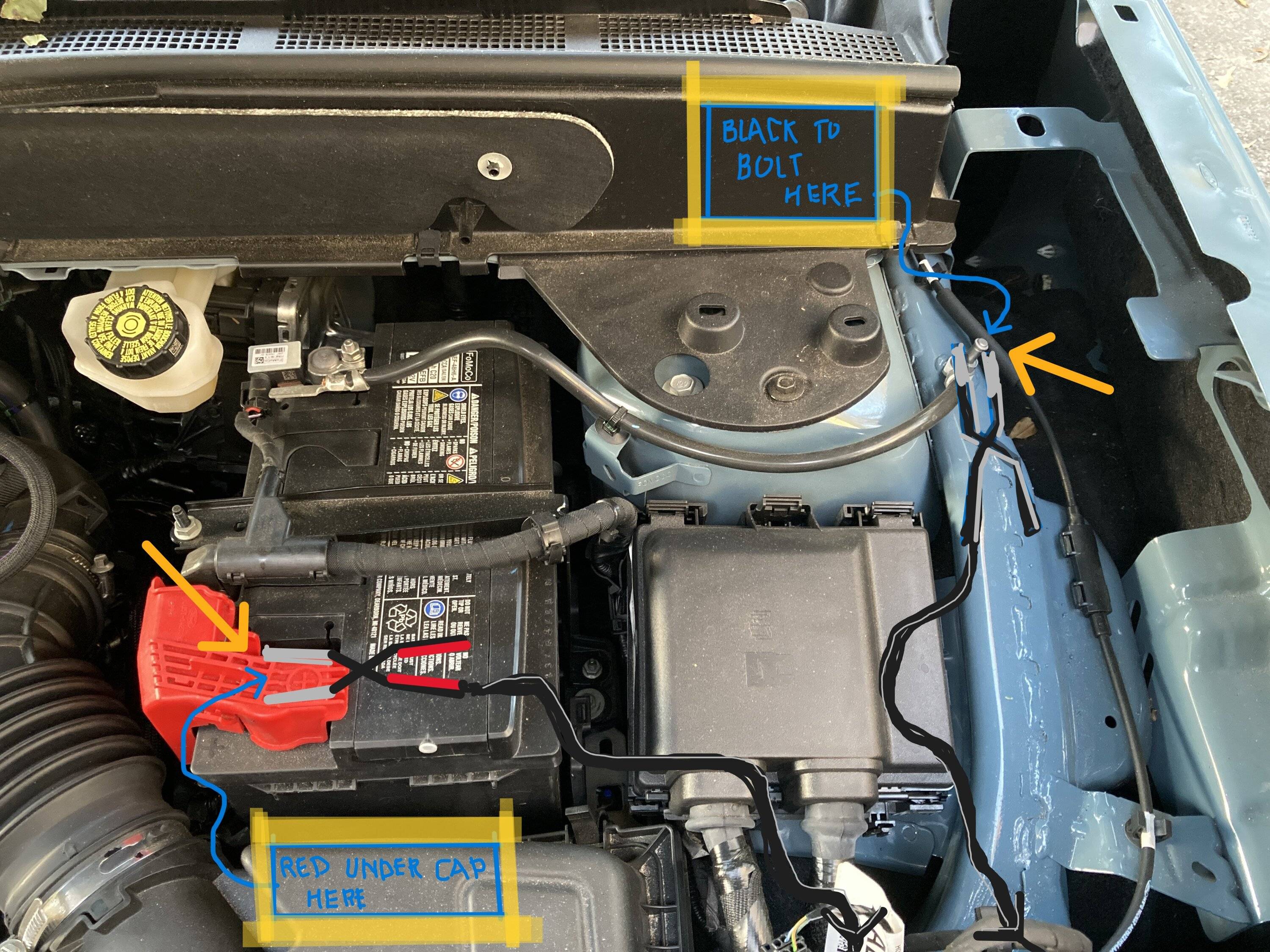

Anyone know where the body ground connection is on the Badlands - before I go out and look through the spaghetti.

Ford Bronco Sport Body ground location? battery jump diagram
Picture I have with my jumper cables in case my wife needs her car jumped sometime.
