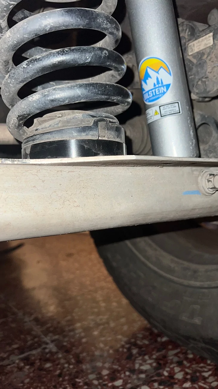

For the guys who installed the bilstein b8 , is it well installed like this ? Do I need another supplement ? I have that doubt , because I see that the rear part increment a little bit not than the front .. sorry for my English

It looks like you have the spacer there, I will look at mine tomorrow and compare

Looks just like mine. I did it myself.
For the bottom: Spacer goes on the control arm. Lower strut isolator goes into spacer. Spring goes into isolator.
For the top: Trailing arm spacer goes in between body and trailing arm. Upper isolator is left untouched. Spring goes into isolator.

Awesome thanks 🙏🏽 my friend

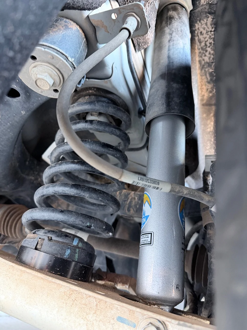

Picked up from The Custom Shop. Charged $750 for install and alignment.
Ford Bronco Sport Bilstein b8 terrasport IMG_6394
Ford Bronco Sport Bilstein b8 terrasport IMG_6395

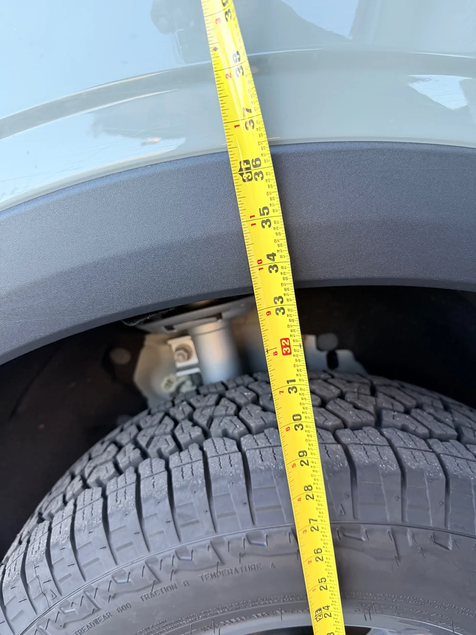

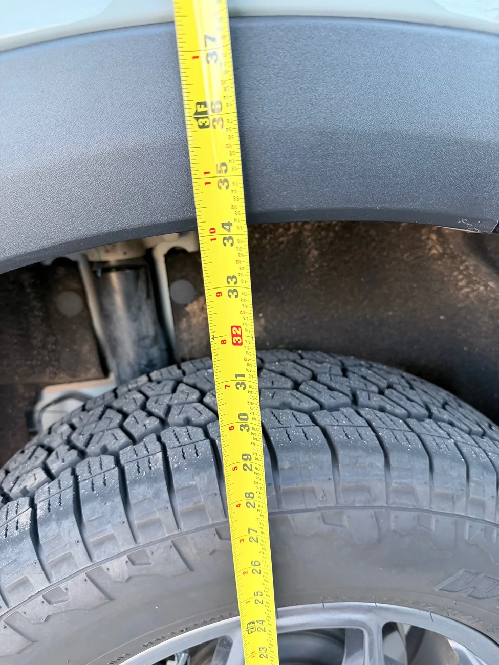

Height before:
Ford Bronco Sport Bilstein b8 terrasport IMG_6317
Ford Bronco Sport Bilstein b8 terrasport IMG_6318

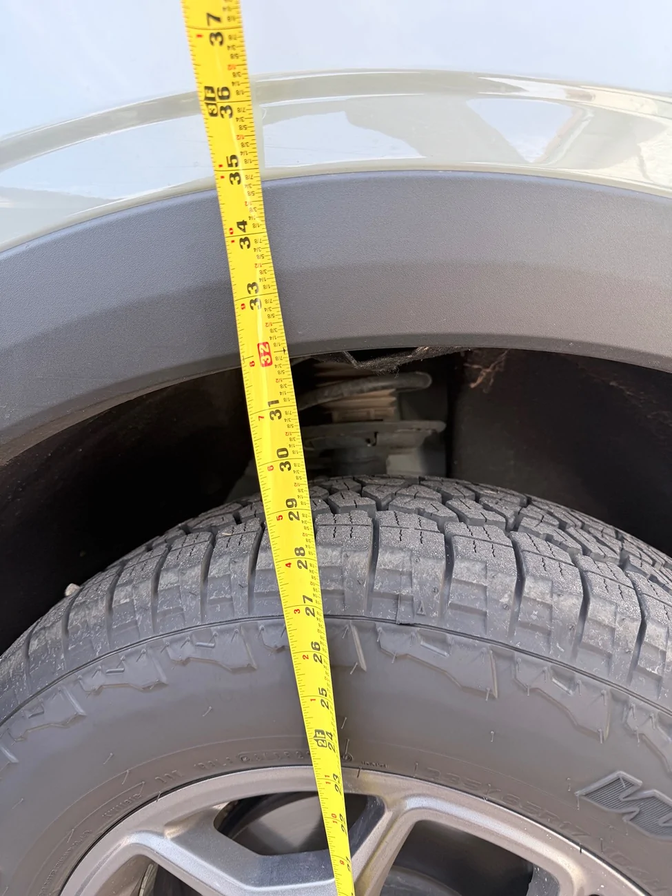

Height after:
Ford Bronco Sport Bilstein b8 terrasport IMG_6393
Ford Bronco Sport Bilstein b8 terrasport IMG_6392
