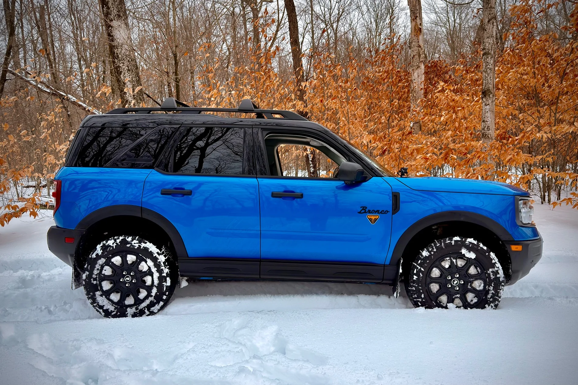

Ford Bronco Sport Bilstein b8 terrasport IMG_2932
Mine definitely still sits much higher in the rear.

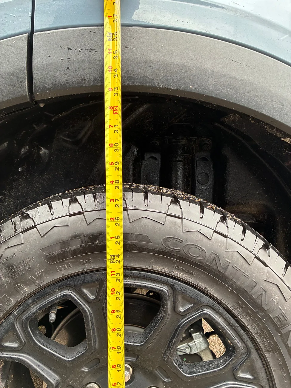

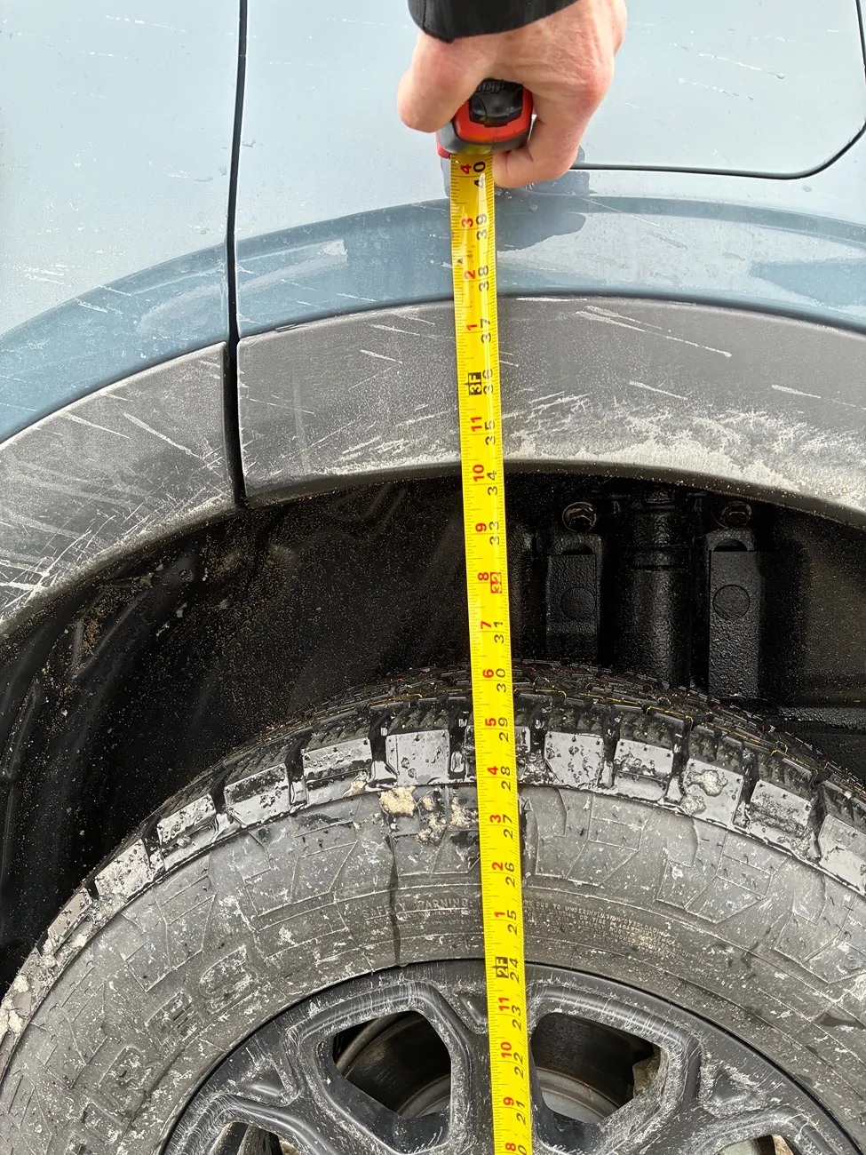

Mine sits higher at the rear also but when I measured before
Ford Bronco Sport Bilstein b8 terrasport IMG_0175
Ford Bronco Sport Bilstein b8 terrasport IMG_0157
Ford Bronco Sport Bilstein b8 terrasport IMG_0154
Ford Bronco Sport Bilstein b8 terrasport IMG_0174

Sorry for the confused order but pre lift had the Continentals
Frenchy906
Dec 10, 2025
700
1,803
2025 Bronco Sport Badlands

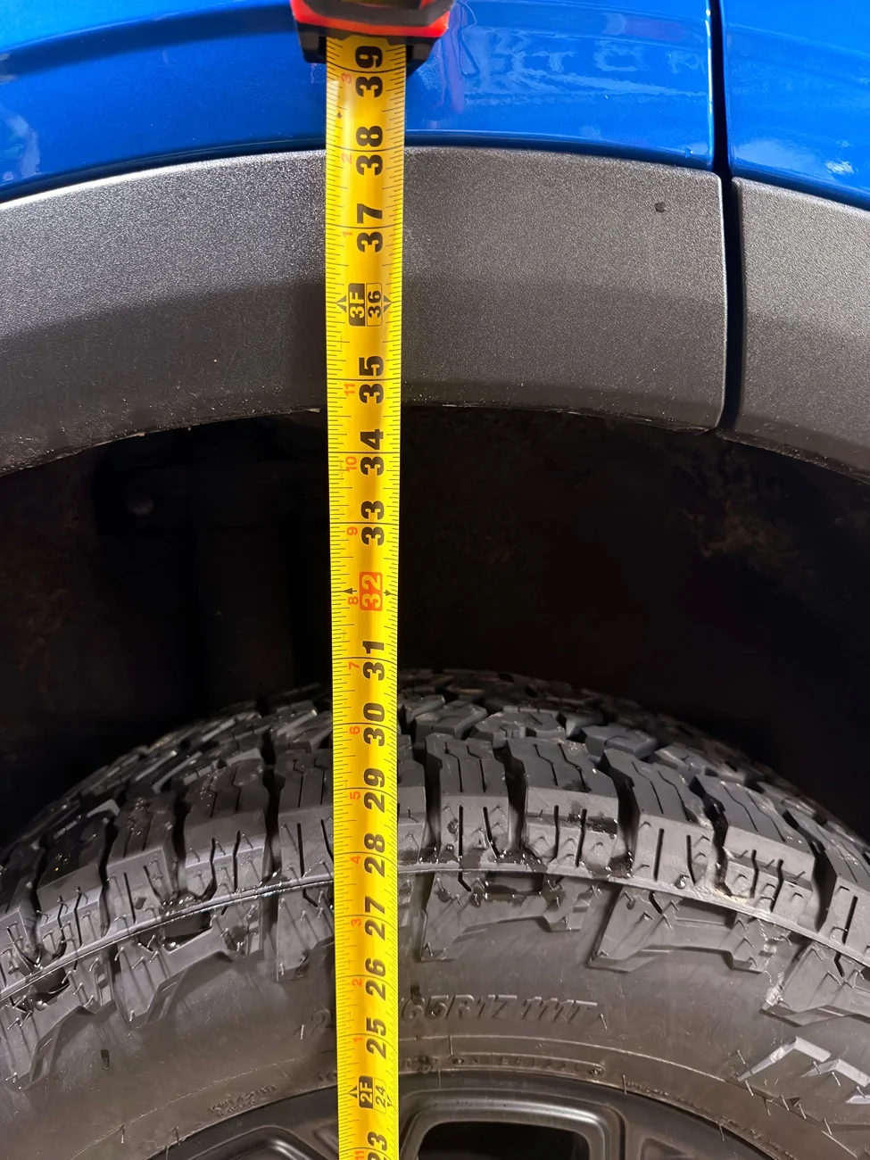

So your current heights are… ~34.25” in the rear and ~33.75” up front?

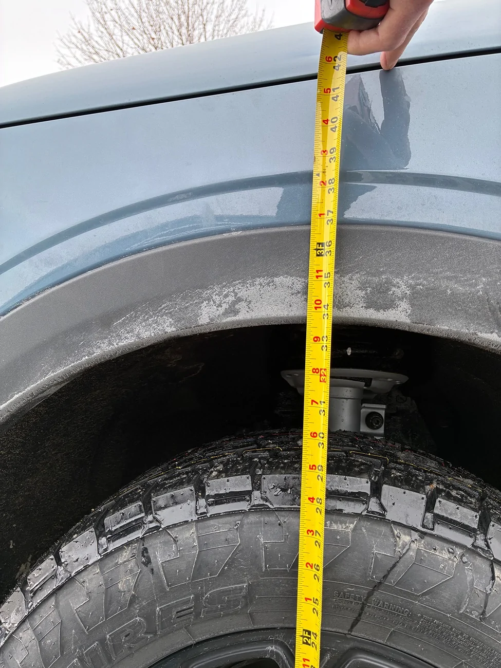

Ford Bronco Sport Bilstein b8 terrasport IMG_3049
Ford Bronco Sport Bilstein b8 terrasport IMG_3050
Both sides match on mine. 33.5” in front and 34.625” in rear.

Yes which is up from 31 in the front and 33 in the back. So a 2-3/4” lift in the front and a 1-1/4” lift in the back

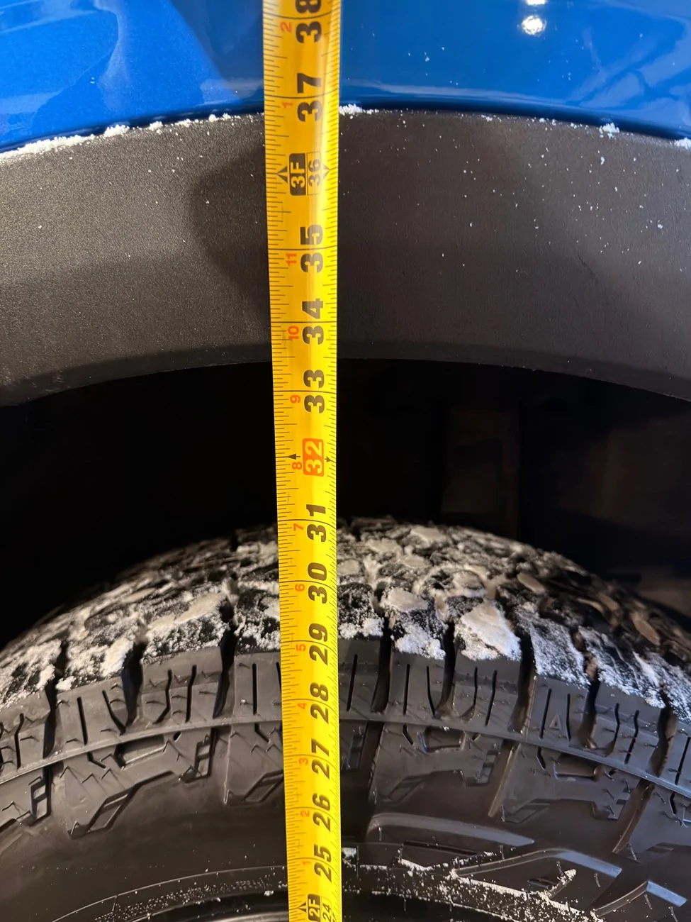

Ford Bronco Sport Bilstein b8 terrasport IMG_2307
Ford Bronco Sport Bilstein b8 terrasport IMG_2308
I was at 32” in front and 33.5” in the rear.

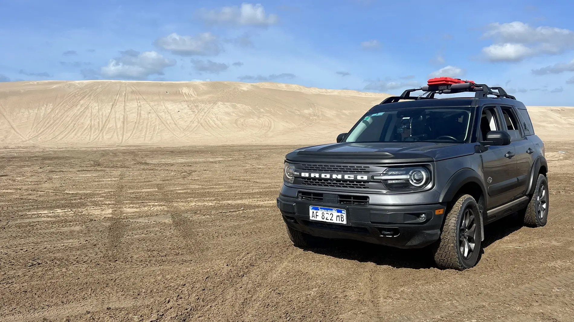

Ford Bronco Sport Bilstein b8 terrasport 1772580658825-ls
I did some upgrades,
-Wheel spacers: AVM 31mm
- EGR Fender Flares (I put 3M in some places because I read that they are crap, no problem)
I have 235 65 r17 BF Trail terrain , not rub..
I did alignment to the wheel spacers. No issues. Better handling and better stability on the road
