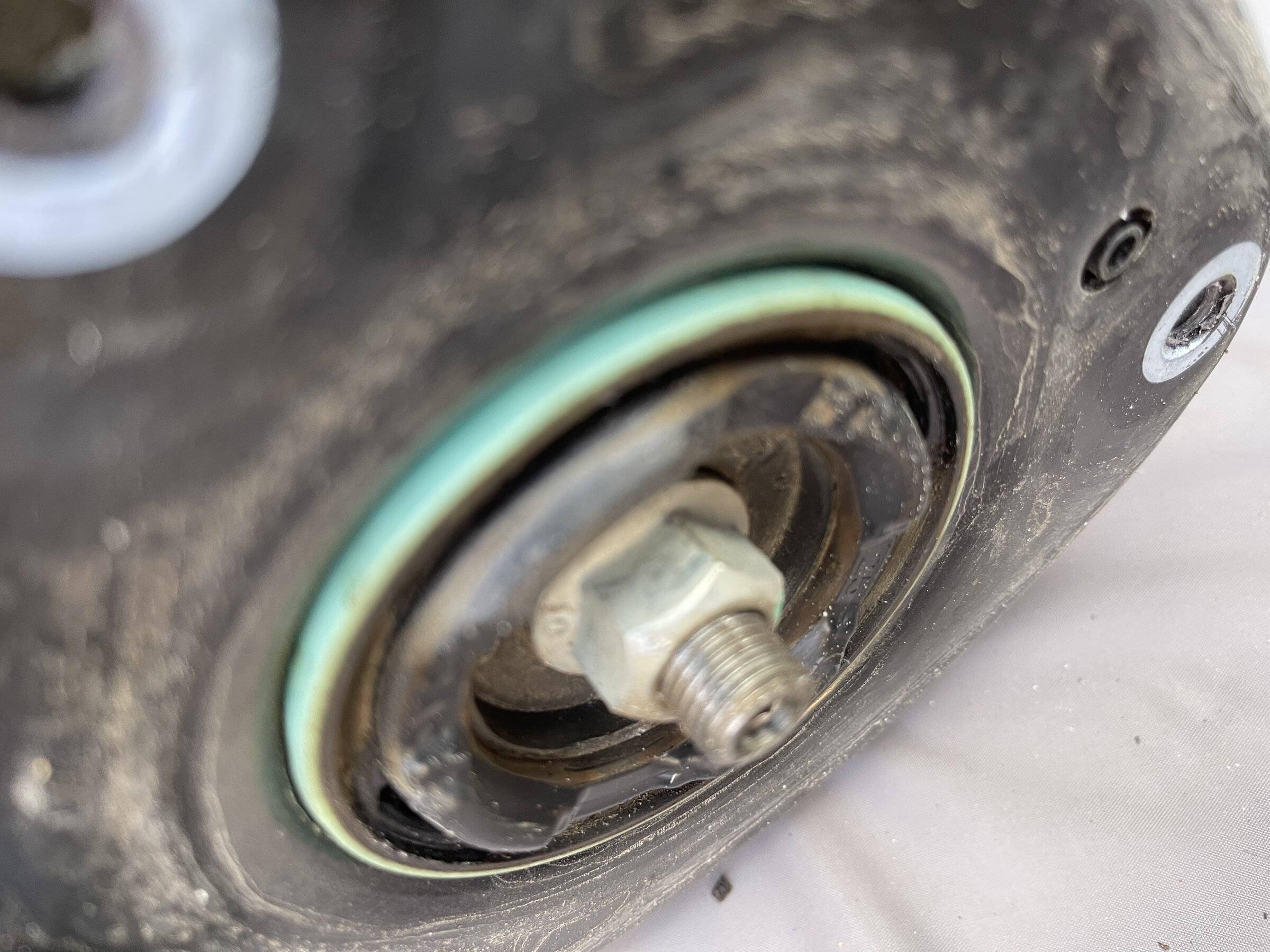

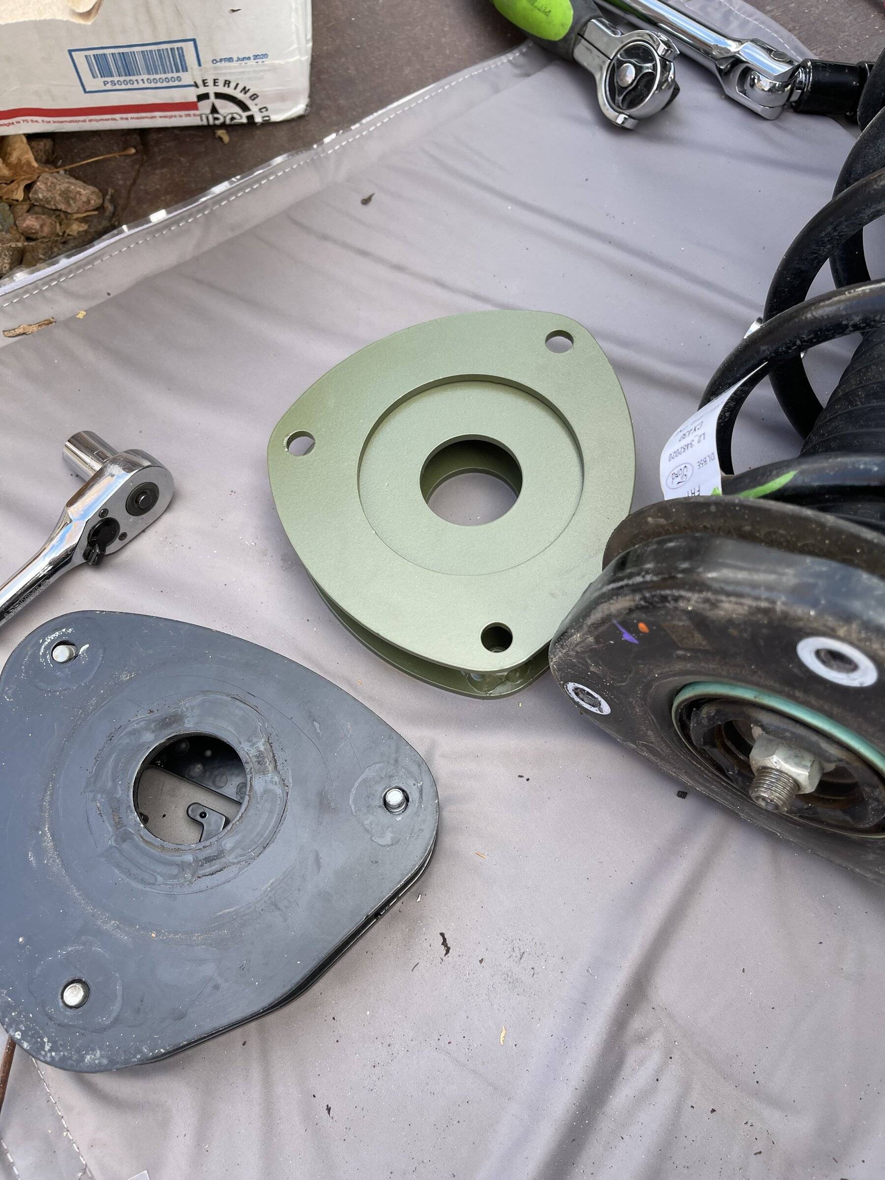

Hope it works out for you, readylift sent me one of their old first kits that came out. The spacers don’t have the cut out for the strut hat which does not allow the strut hat flex . So you get the clank sound. They swore up and down. The kits were all pulled and updated to the new spacers. Even said the serial numbers would confirm it. But sure enough they were not. 4wp did my install and refused to check it. Took it apart myself and found out they were wrong.

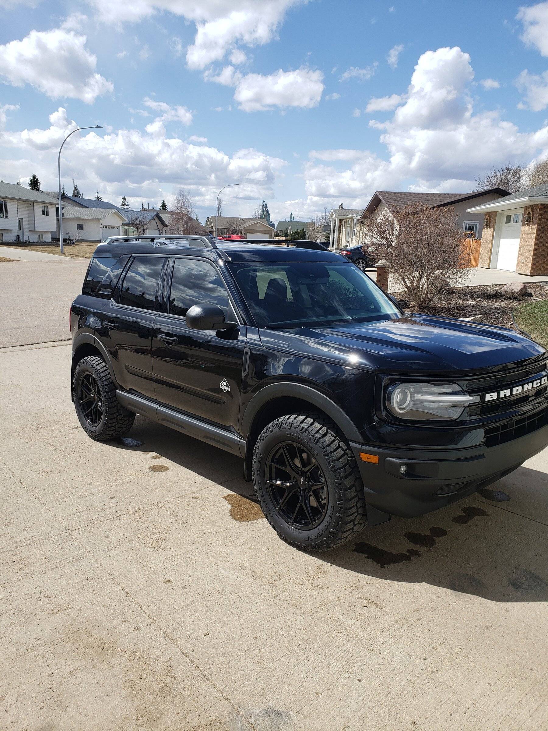

I have 1.5 inch ready lift with 265 60 R18 cooper rugged treks. offset rims . handles great. A lot of trimming to make fit but i think it handles better
