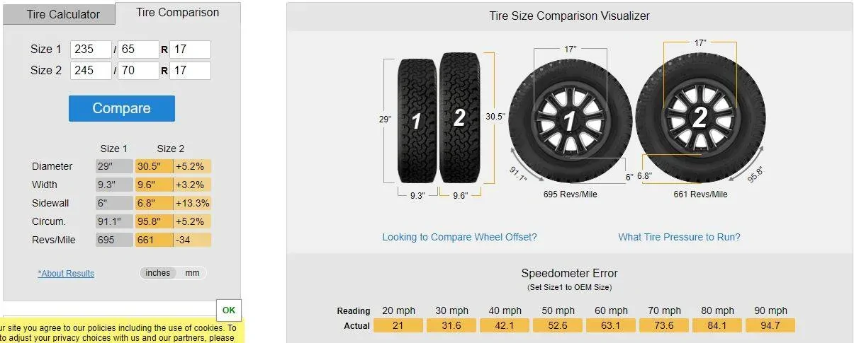

If you would, what is total height of tire compared to my 235 65 17 , 29 3/4 is what my 235 are . Thanks great information and video .

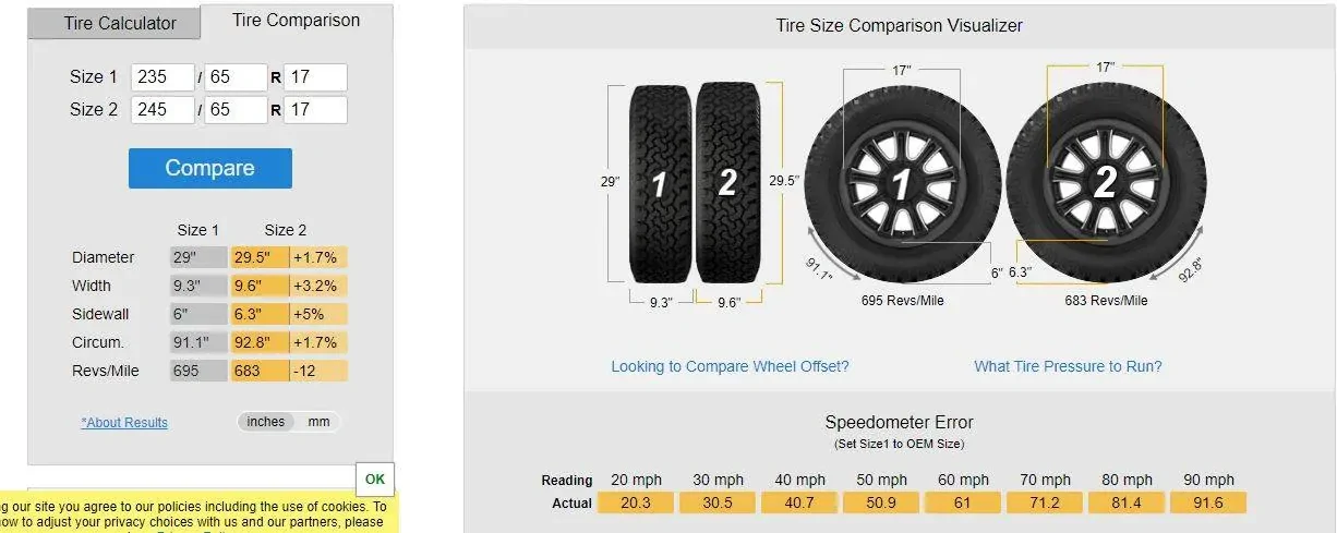

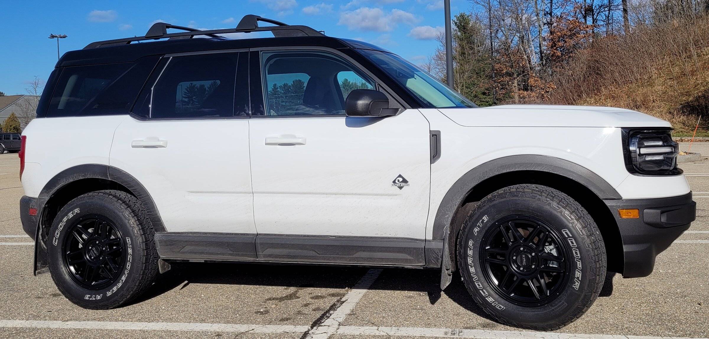

They are the tires in the picture.
Ford was quoted in a Car&Driver/Motor Trend article saying the largest tire you can fit on a Badlands or First Edition is a 30.5" tire. 245/65/17 are 29.5", so no need to modify anything if you go with that size.

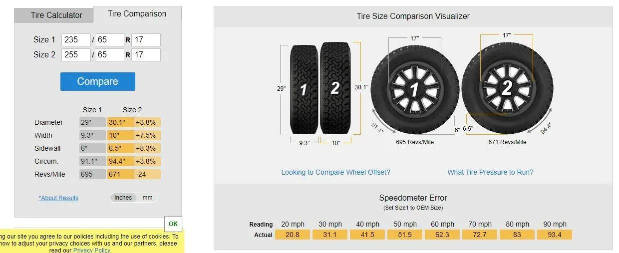

Thanks, appreciate your time in gathering information . Looks like that 255 might be a bit of a stretch. For a first edition .
Ford Bronco Sport Big Tires for BS Badlands 560563D4-3E7E-4848-A693-5E0D7FEF6A9C
255 without a lift definitely will rub off-road. I'm going to put 245/65/17 KO2s on mine at some point.

DON'T DO IT! Clearance issues are more than just tire diameter. In your case a 265/65/17, in combination with the increased diameter you're adding a significant increase in width. A terrible combination.
If you want to push the limit get a 245/70/17 and expect to need to cut back the fender liner and trim the pinch weld. Now, if you want to go a little wider and don't mind the same mods, you might want to try a 255/65/17
