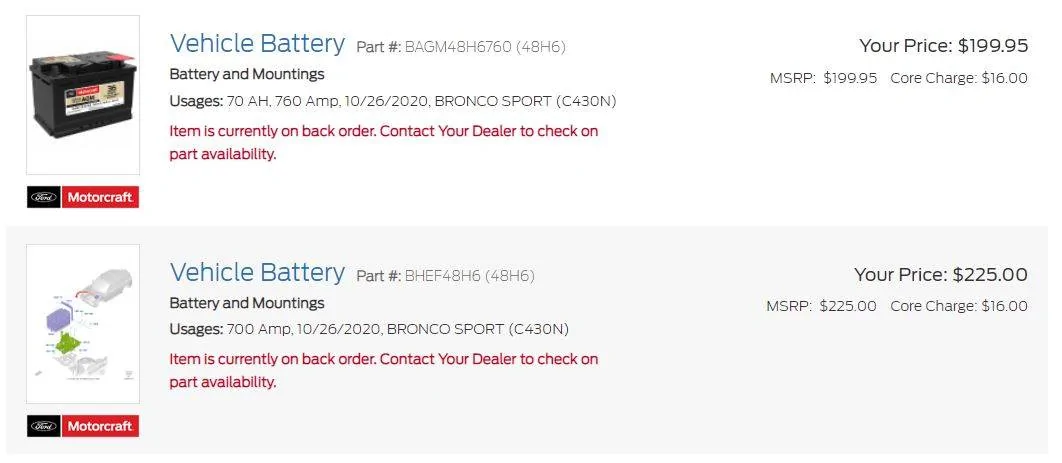

P.S. if your vehicle came with the same BHEF, then the AGM is a slight upgrade. Same battery group, 760 cca instead of 700. Same 120min reserve.

AGM batteries are better than ordinary FLA (flooded lead-acid) in many ways -- some of which are N/A for most vehicle applications though:
* They are spill-proof. Originally designed for use in military aircraft and tanks.
* They do not off-gas, so they can be used indoors without ventilation.
* They can charge and discharge at a much higher rate (amps).
* Their service life is much longer.
* Some other stuff I've forgotten.
For our use, the primary advantage is increased life. If the prices above are accurate, $25 LESS for the AGM is clearly the way to go.
The OE AGM starting battery in our Sprinter-based RV lasted 10 years, and was still working when we replaced it. It might have gone another (say) 2-3 years. Obviously that's just one battery -- and I did keep a Battery Tender (BT) on it, but still -- 10 years and still working is impressive.
BTW -- last I saw, AGM replacements for the 6V golf cart batteries (used as 'coach'/house batteries in RVs) cost 2-3 TIMES more than a typical GC battery. $200 vs $225 is a great deal -- although the FLA battery may be overpriced.
One thing I did notice at the MachE forum link above is that the BHEF is listed as a "Fleet Tough/Extra" battery. I have no idea what that means but a decent AGM should be more durable than any FLA battery. Of course, there's probably a range of quality with AGM batteries, just as with anything else. The industry standard seems to be Lifeline (made in the USA). If the 'BAGM' is made in China like the BHEF it's hard to say.
If Ford has been using/offering the BAGM for a while in other models (like the Escape) perhaps there are owners who have had the BAGM for several years and have posted about it.
