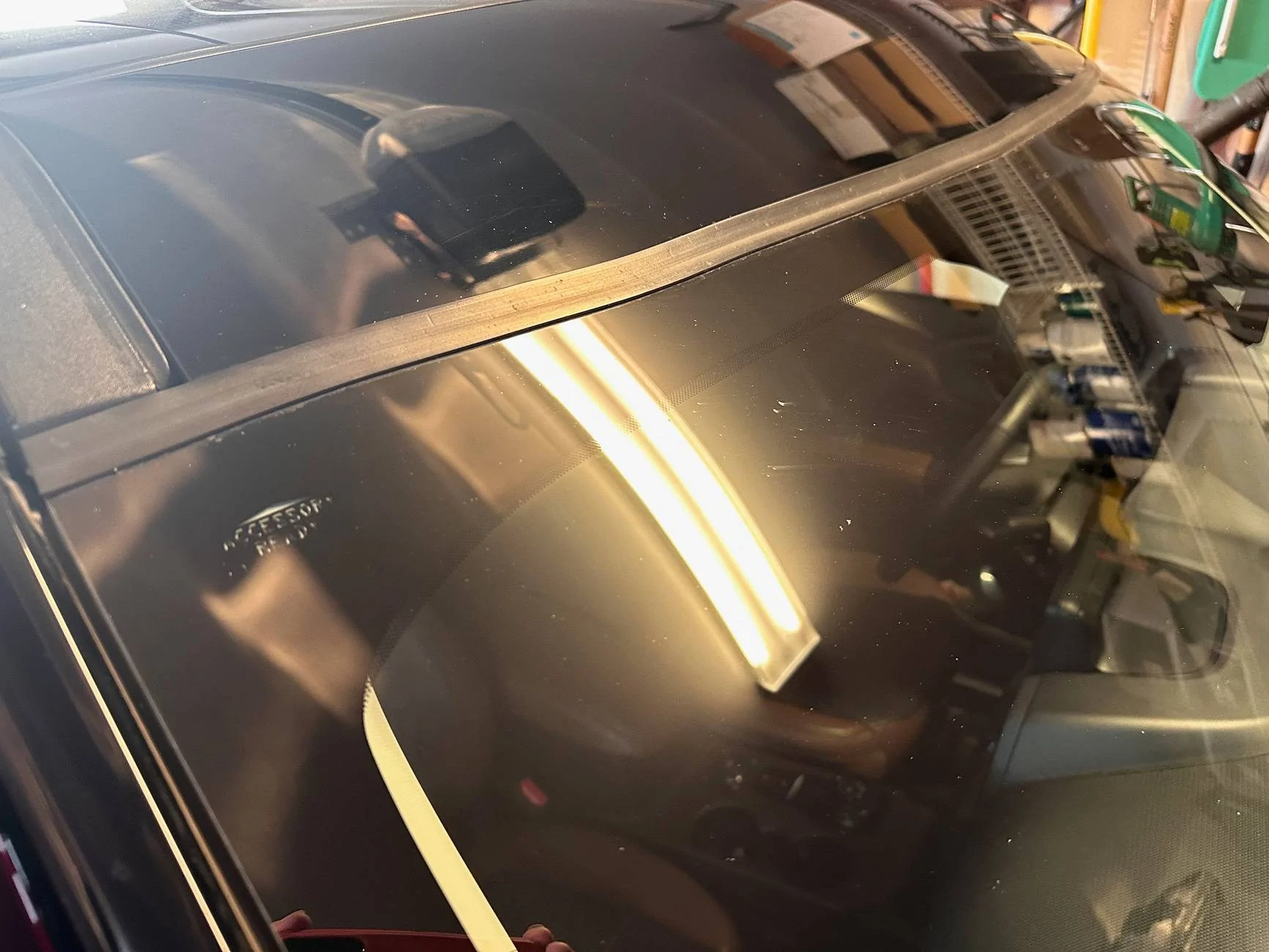

This is what it looks like with the rubber strip.

First part completed. Rubber strip will be delivered tomorrow. I'm a bit nervous to stick anything to my vehicle (won't even do bumper stickers). Is the sticky part closest to the windshield or roof? Any other pointers? I'm a shorty, so hoping I can get it straight.

The rubber strip I got had two lines of adhesive; one went on the windshield and the other the roof. As you can see in my pic, I didn't get it completely straight but it was close enough. I wouldn't worry about putting it on. You can always peel it back off.

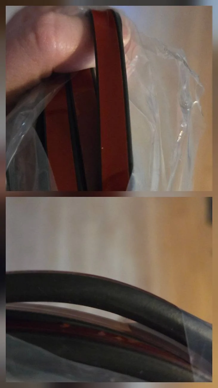

This one looks like only half of one side has adhesive. Did I order the wrong one?

I dont think that was the correct one either. Its very narrow and rounded on the side without the adhesive.

Use blue painters tape as a guide to get it straight.
You can measure one quarter inch or whatever you need down from the top of the glass across the windshield, lay the tape as you go across measuring. Make sure it looks even. Lay the rubber strip along the tape, pulling off the backing paper as you go. Then pull off the tape. It will come out perfect.
Use a plastic ruler to measure so you don’t scratch anything. painters tape will come off easily without leaving residue.
